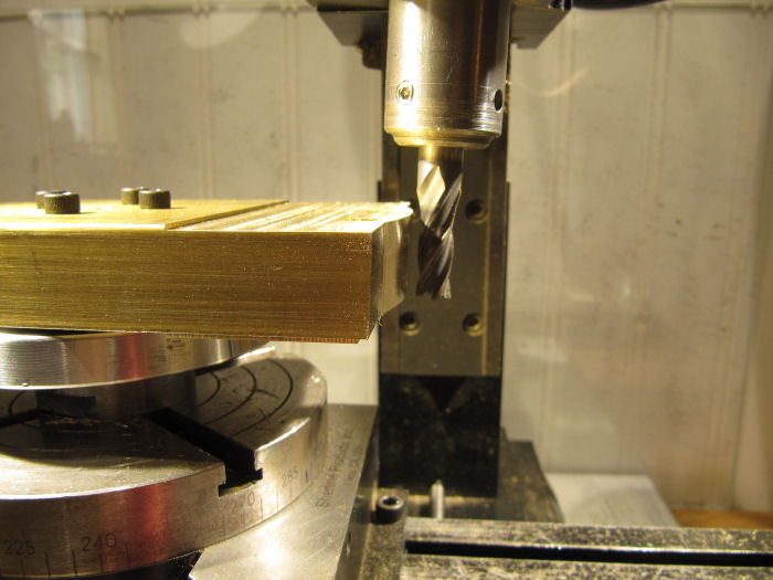

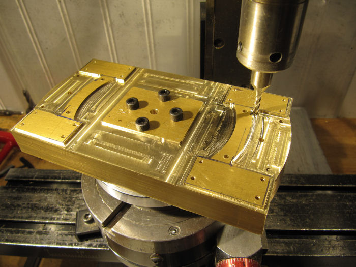

Got started on shaping the ends of the engine bed plates - they are flat at the corners next to the frame mounting pads, then arc out in the center to give a little extra room for the cranks. The ends will be angled in, but I started with the mill head vertical to set the length. The parts are screwed one at a time to a faceplate mounted on the rotary table.

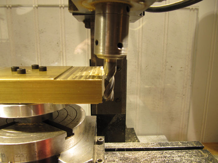

When all the ends had the shape milled in, I then tilted the mill headstock a whopping 2 degrees - just visible against the mill column on the left of the headstock.

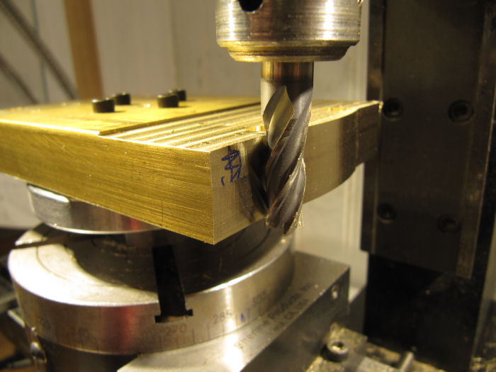

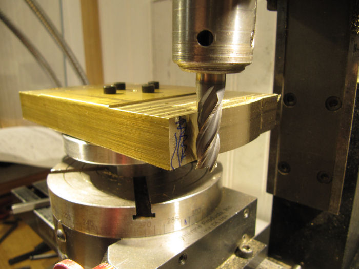

To know when I had advanced in to the initial shape, I drew on the face first with a marker:
Then took several light passes, here it is halfway with part of the marking gone:
Another couple passes and all the marker was gone, same process on the other flat end and the arched center.
The sides of the beds stay vertical, its just the ends that they angled in. So, on to finishing the rest of the ends....

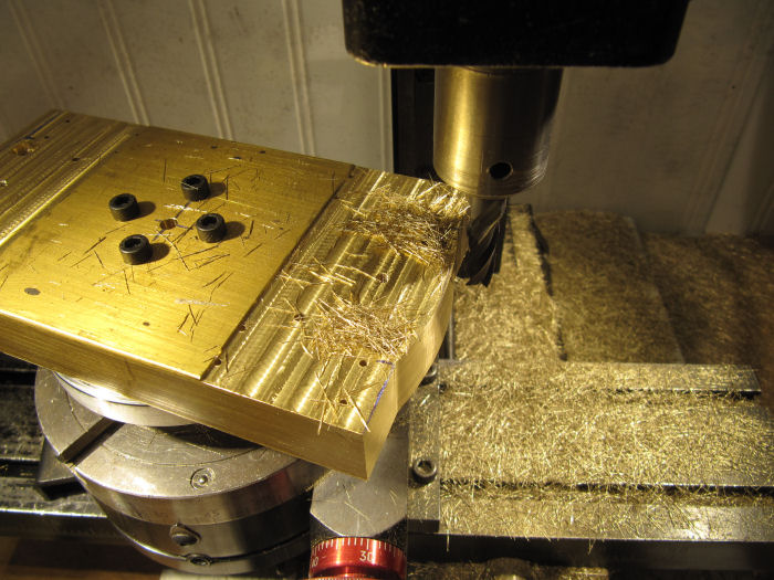

Got the rest of the ends angled in on the bed plates, now turned them over to put the arcs in the recesses on the top surface...
Next? Well, I need to cut the arc in the opening in the center,  tap the mounting holes on the corner pads,cut the center opening out, and get things prepped for the bearing blocks and the bottom arched blocks...

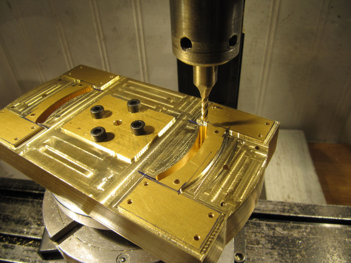

And got started on cutting the ends of the center opening through the bed plates - this should be the last operation for these parts on the rotary table. I used a small end mill to give the inside corners a small radius, which meant that I had to finish the cuts from the other side of the plates.
Two plates up to this point, one more to go...
