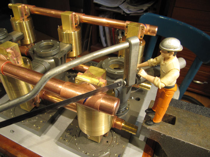

Hi Chris,
Looking at your pictures I'm wondering if your pipe arrangement will fit in your housings.
Eric

Hi Chris,
Eric
Well, elf-exhaust!  Where were you yesterday?   :Jester:
Yup - you are right, those caps are fine for the lower housings where the pipe extends out and is capped, but not on the upper housings with the blended in pipe ends. Huh. Never spotted that one - did all the modelling in CAD for the pipework on the middle housing. Whoops.    :slap:
Not a big problem, I can trim off the end of the Tee and put in a plug instead. The tee sections work, but would have been better done with an elbow in that one place. Those upper assemblies are the first to go in the housings, so I would not have gotten very far!  Thanks much for the catch!!!   :cheers:
The (butt)-crack rework team is on it:
« Last Edit: May 17, 2021, 04:36:15 PM by crueby »

Got lucky - trimming those end caps off at an angle did the trick! They now fit inside the upper housings with the blended end pipes.   :)

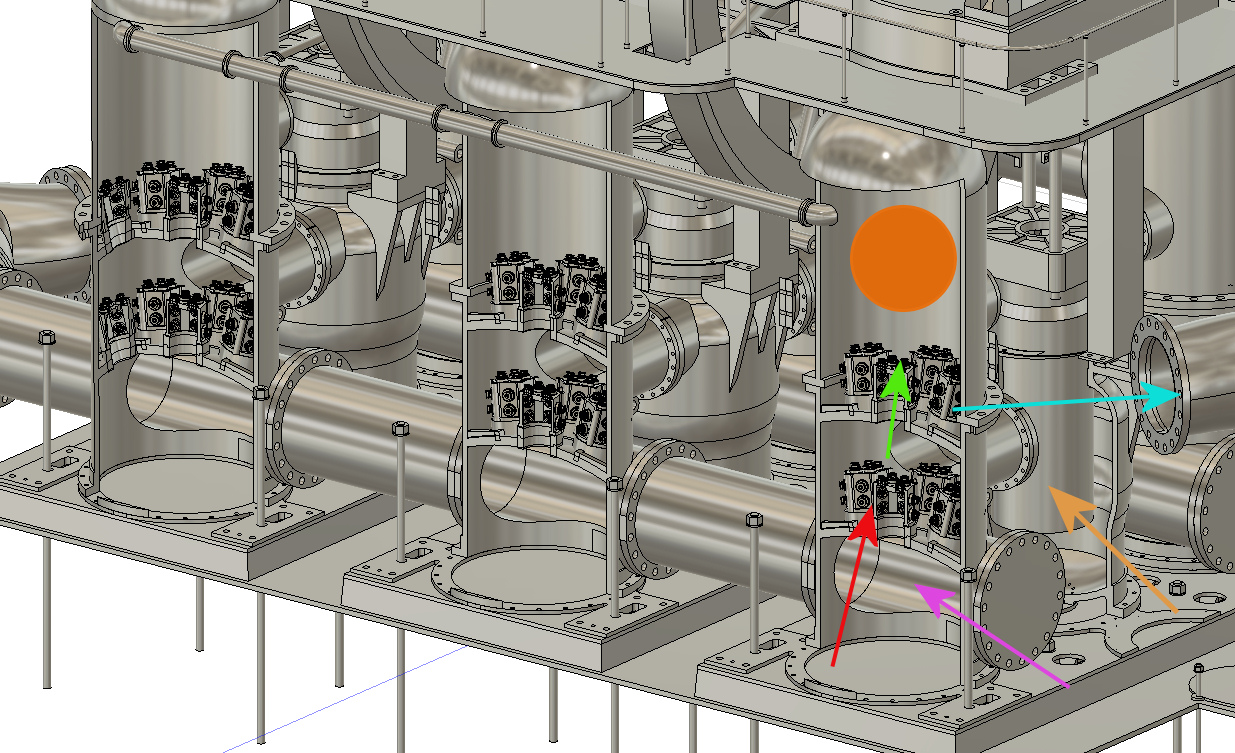

  • Posts: 18713
« Reply #464 on: May 20, 2021, 02:52:55 PM »
Hi Derek,
There is absolutely not another check valve in the pipes like you show. If they did, that pipe would have to have been a lot larger diameter to put in another huge array of small check valves - they did not have the technology to make a single large check valve, maybe they do today in pipelines, I don't know.
Here is a cutaway view of what they did do, this is taken directly from the original builder blueprints, just converted to a 3D model:
A description of the operation for any interested. The orange arrow in lower right shows one pump cylinder with the side wall cut away to show the plunger inside. The purple arrow shows one of the two valve housings for that cylinder cut away, with the inlet pipe coming in from the left. The water, under slight pressure since this chamber is a little lower than the level of the lake outside the building, would be drawn in through the lower check valves, red arrow, as the plunger goes up. When the plunger reached the top and stopped, those lower check valves would close, they are spring loaded valves that look a lot like an IC engine valve.  When the plunger pushed down again forcing the water out of the pump chamber, the water would flow through the upper bank of check valves shown by the green arrow, and out through the output pipe (blue arrow). The connection of the output pipe to the chamber above the green arrow was cut away so the valves would show. In that upper chamber, shown where the orange circle is, they piped in compressed air to act as a buffer for the changing pressures and prevent water hammering. The air partially filled the top of that chamber. House type pumps on wells have the same feature. There is another air chamber like that on the output pipes where they meet in the big Y pipe to the right, not shown in this picture.
They did not use check valves in the common pipes between these housings. Maybe they would on more modern systems? The three pump plungers are worked by the engine pistons above, so they are 120 degrees out of phase with each other. That means that the flow in the pipes IS fluctuating some, would be the combination of the three sine waves created by the three pumps, with less total variation than there would be from one pump acting alone. The air-filled force chamber reduced the bouncing of the water flow but it would still be there.
Derek, back to your original question, while a more modern system may be designed differently given the way they can computer-model the flows to make it more efficient, for early 1900s this is what they had. It had to work well enough since it ran till about 1980.  Its fascinating to compare it in size to the electrically driven turbine pumps they replaced these engines with.
These pumps sit right next to the old steam pumps, in one of the bays they had left to add more steam pumps for future expansion needs. About the same footprint on the floor as one engine/pump, a tiny fraction of the height, and they feed a city that has grown a lot.
Now, let me say that I am NOT a fluidics expert in any way, except how to drain a beer glass. The design of a more modern plunger pump system is way beyond me - might be a good discussion topic over in MJM's thermodynamics discussion thread!
