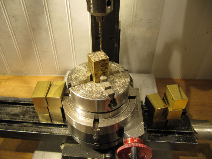

Thanks Roger!    Been toiling away on drilling/tapping the holes in the inlet/outlet blocks, doing a couple blocks at a time then going off to do other things. Not quite as bad as doing crawler tracks!

« Reply #430 on: May 10, 2021, 04:49:14 PM »
Woke the shop elves early today and sent them into the shop to finish dilling/boring/tapping out all the pieces for the inlets/outlets on the check valve arrays...
The pile o parts, blocks ready for silver soldering the side tabs to:
After soldering, the tabs and blocks will be drilled through the side for the water and mounting screws. The blocks will be screwed to the round caps/plates with some thin rubber gasket for a seal.

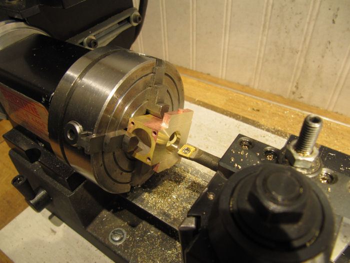

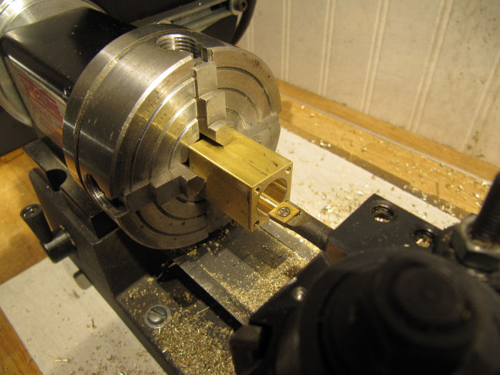

« Reply #431 on: May 11, 2021, 04:13:27 PM »
Yesterday saw the side tabes silver soldered onto the connector blocks for the check valves. Today I bored the holes in the sides, and skimmed the face where they will meet the flanges on the pipes.
Bore, skim, repeat...
Then, on todays episode of Confuse-An-Elf, they are trying to figure out why the local bees sent them a stack of their poker chips!
These are the blanks for the flanges that will be soldered to the plumbing Tee's - did not have any flat stock the right width, so I took a length of hex bar that has been sitting on the rack a few years waiting for a use, and cut some chips off the end. They will be bored to fit on the tees, soldered on, then the top/bottom edges will be milled off to form the flanges.
