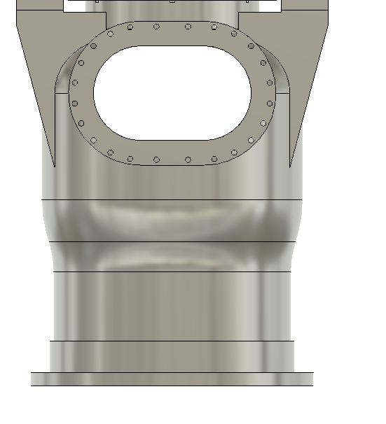

No, the 3 gussets on each side of each pump chamber are the supporting elements for the upstairs weight
The outer face of each of these sets of gussets is not a vertical line, each face tapers back into the body of the pump chamber
Look at my mockup, you can see your BLUE line just below my YELLOW line [in the approx horizontal plane]
Let us see the end elevation view [as seen] of the RED arrow

Hi Derek,
Sorry, i've been working on the pipes all day, and my brain got stuck thinking about them!
Yes, on the brackets, the gussets are completely vertical, but the outer face does taper back to the pump body at a 15 degree angle. All three of the vertical gussets have the same angle, which makes them easier for me to mill.  Here is the other side view:
What I am planing to do is to mount the pump chambers back onto the jig I used to mill the slots - that jig is still in the collet block, and is marked for the which face of the pumps goes to that side of the jig, so I can put them back on square to the collet block again. Then, I'll clamp the collet block at a 15 degree angle and run the mill down the gussets  to give them the angle. Should be easy to do, probably have to do the last little bit where the side gussets meet the body by hand since the pump body is on a curve there.The jig will also let me clamp the soldered body upright and square so that I can drill the holes in the tops of the brackets where the vertical struts to the engine blocks go. That jig is getting a lot of work on these parts! Trying to line the bodies up without it would have been really tough.

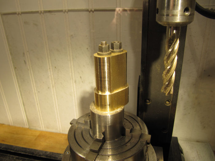

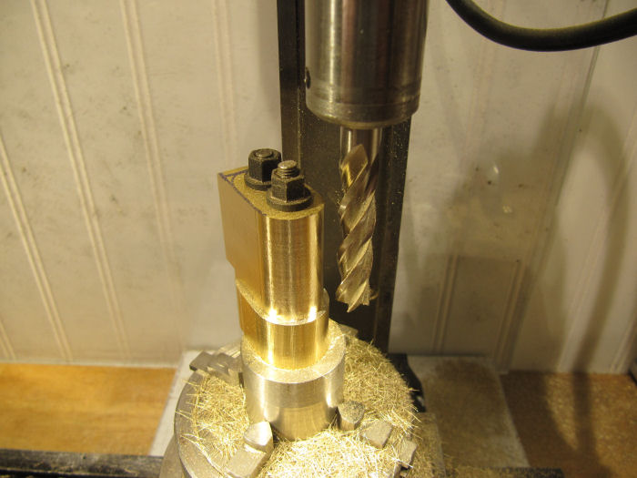

Moved on to milling the other ends of the pipe sections, using the same jig as before to hold the parts. Since this end is longer I had to switch to a longer-flute end mill, fortunately had picked up some of them this past winter. This end is a little smaller than the first one but the same shape, it has to fit inside the opening in the valve housing. A flange for bolting it up will be added later. Here it is with sides taken in and first end rounded over:
And the second end

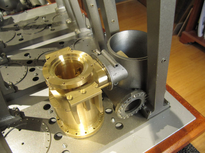

First one set in place in the pumnp chamber and with the valve housing too:
The end that goes into the valve housing will be trimmed back a little, and the holes through will be enlarged for full water flow. There will be a set of drilled/tapped holes at the valve end to bolt it to the check valve housing (that part of things will be shown later, it was what I had 3D printed a prototype of to make sure it would all fit and be accessible for attaching it all together).
