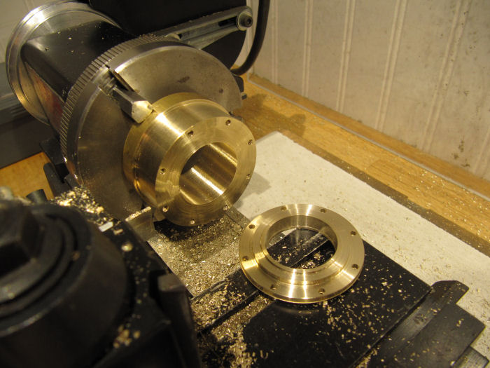

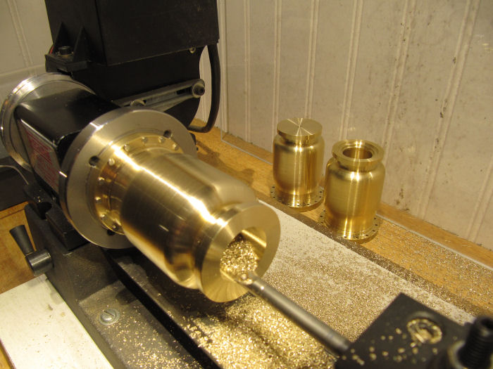

Been a busy couple of days on the pump chambers, got the other two chambers turned and bored out...
Then moved over to the mill to drill the pattern of holes around the top rim for the seal retaining ring in the elf storage containers, um, I mean pump chambers...
With those holes all drilled, moved on to making the retaining rings from a smaller offcut bar. The bar was turned to diameter, bored through, and the flanges turned in for the first ring before drilling matching clearance holes in the rim:
Then parted off the first one, ready to turn the flanges on for the second one...

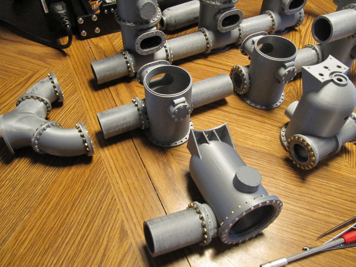

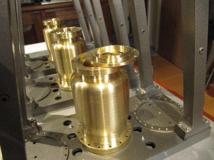

Over the last week or so I've also been bolting up all 87.3 gazillion of the fastenings for the pipes, valve chambers, and force chambers that I 3D printed. Here is the set:
"But, um, wait you idiot... You need to put in the check valves and internal tubing!"  I can hear you yell at your screen.   :atcomputer:

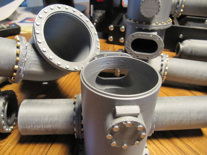

No worries there - the top/bottom flange sections and one end of each pipe is actually made as a separate piece, so the sections can be unstacked/slid apart as needed for access to the insides:
Here is a closer view of the way the flange comes apart, there is a lip on one side that mates with a recess on the flange:
This will (hopefully) give me enough access to the internals of the chambers/pipes to connect up the tubing/valves that will actually carry the water for the pumps. I am hoping to be able to pump water out/back into a container for demonstrations, but since that will not involve pumping into a pressurized system like the real ones, I shouldn't have to worry about the back pressures and force fluctuations that the real one did. These engines only ran at 10 to 20 RPM, but even so the volume per revolution was pretty high (nearly 1000 gallons per rev on the real engines). I am going to be running some tests on one of the pump chambers after the pipe flanges get added to determine the openings I need on the check valves and the tubing sizes, to let it pump freely. Depending on the results, I may be able to have the inlet water come in on just one side, and the outlet go out the other side of the system, which would make connecting everything up easier. If not, there will have to be inlets/outlets on both sides (inlet comes in from one end through the lower pipes, outlet goes out the other end through the upper pipes).
So, next steps - finish up the retaining rings, then will start on the pipe flanges and brackets that go on top of the pump cylinders - all metal, silver soldered onto the pump chambers.

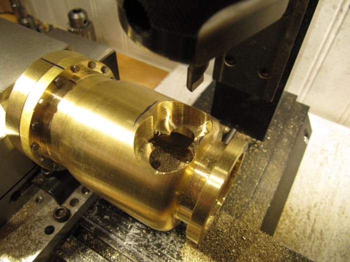

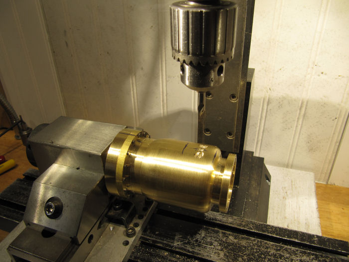

Then, after some part pondering (sort of like casting fondling, but not) and thinking on how to hold the chambers to cut the openings for the pipe flanges, I decided to go a fairly simple route and make an arbor to hold them with a 1" 5C collet in a square holder.
I had toyed with making a jig to hold them on the rotary table and do the cutting with small end mills, but that got too complicated for alignment so I went back to drilling two side by side holes and expanding them out with the boring head. The pipe that comes out of the chamber, as you can see in the CAD screen capture a couple posts ago, is round on the ends with a flat section in the center. The OD of the end arcs is .870", so too big to drill directly, and the two holes intersect since they are only 1/2" apart, so the boring head won out. I started by positioning the part and drilling two 3/8" holes a half inch apart.
Then bored the first hole out to size, it started out as an interrupted cut due to the curve of the part, and again when the two holes intersected. The brass cuts very easy, so the interrupted cuts were no problem, was able to start out at a higher RPM at first but had to cut it back a bit as the boring head was offset at the larger diameters.
Then moved over to the second hole and brought it up to the same size

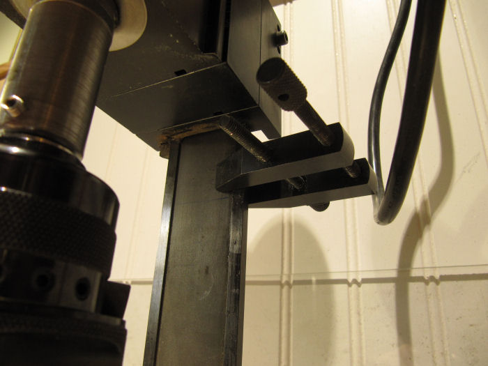

As you can see, the drilled holes go through the side wall, but the bored holes do not - I wanted to leave a ledge there to help position the flange that will be inserted and silver soldered. To keep from miscounting and lowering the head too much (which would be nasty as the cutter bottomed out), I put a heavy machinist parallel clamp on the mill column as a hard stop - its just on the frame of the column, not touching the leadscrew at all.
So, for each chamber, I'll drill/bore through both sides, turning the square holder over to get at the other side, and am using the end of the holder as an index point on the end of the vise. The parts are marked where they are on the arbor, so I can swap parts and get them back to the same position again later - the pipe holes need to be the in the right orientation in relation to the holes in the bottom flange so things will line up with the valve chambers when bolted to the base. After all the holes are bored, I'll go back and use an end mill to connect the dots - taking out the little triangle of material left between the two holes, completing the openings. The arbor needs to stay in the collet through all this to make sure everything aligns.
After that, I can mill the slots in the sides of the chambers for the brackets that hold the arms, which will go up to the bottom of the engine bed plates. Then can start making the pipe flanges themselves, and the brackets. Going to be a while!!
