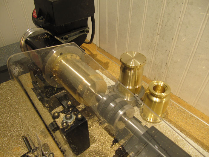

Got a start on the other two pump chambers this morning, taking a side job now to make up some new plexi chip shields, the old ones were getting too scratched up to see through, one got dropped and broke.
  • Posts: 18716
« Reply #326 on: April 18, 2021, 06:46:19 PM »
Finished with the new chip guard for the lathe - just a sheet of clear plexi bent in a 90 with a little heat from a torch, then cut an opening to let it fit over the cross slide end. Been using same setup for years, old one finally got too scratched to see through well when the task light was shining through it.
Here it is while turning the second pump chamber to shape. Behind the lathe you can see the first one, and the third one as it was in the chuck to rough in the base and drill the mounting holes on the mill. New shield doesn't show that well in the picture, but you can see the top/left edges pretty well. It extends down past the tailstock, is long enough to deflect the brass chips which like to fly in all directions. It rests on the cross slide, so it moves with the cutter.
