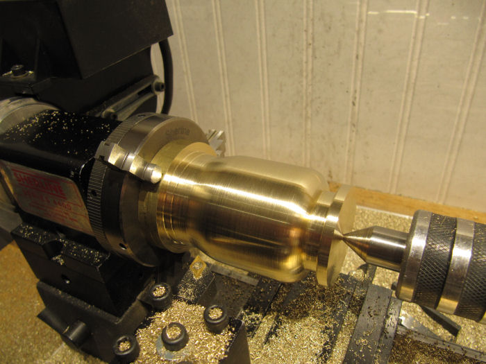

Today was a boring turning day.  Well, technically,. turning then boring!   :Lol:
Started in on the first of the pump cylinders. There are three of them, one per engine cylinder, the plunger driven by rods coming down from the crosshead above.  I started with a length of 2-1/4" diameter brass roundbar, and turned the outside to shape.

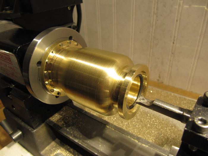

The chamber flares out in the center to give the water space around the plunger. The plunger is about 1" diameter, with a 2" stroke, and the chamber is a little over 3" long overall. To give swinging room and room for the chuck jaws on the lathe I put the riser blocks in on the lathe. After shaping the outside, the part was swapped end for end and moved to the mill to drill the pattern of 16 2-56 clear mounting holes in the base. Back on the lathe, the bottom was trimmed to final length (it was left a little long to get the part past the chuck jaws). Then it was bolted to a steel faceplate that had a matching pattern of tapped holes, to start boring it out. I initially tried holding the part in the chuck for boring, but with that much weight and overhang the brass kept wiggling a little loose in the jaws, so I went for the faceplate - much more secure.
I drilled/bored out the inside to the 1" size of the plunger, then enlarged the inside more, and turned in the seat for an o-ring for a seal. There will be a cap that sits above the o-ring to hold it in place. On the original engine they used a large flat ring seal, not sure what material, but basically the same idea. The plunger does not have to seal down its length like a engine piston would, just needs the seal at the opening - the plunger displaces the water inside the chamber to force it out, and on the upstroke the volume un-displaced draws in the next 'chunk' of water. The chamber looks a lot like an old style milk can. Once all the boring is complete on the chambers, I'll make and add the pipe flanges on the sides, and on top it gets a pair of brackets that will hold struts extending up to the bottom of the engine beds. Lots to go on these parts!

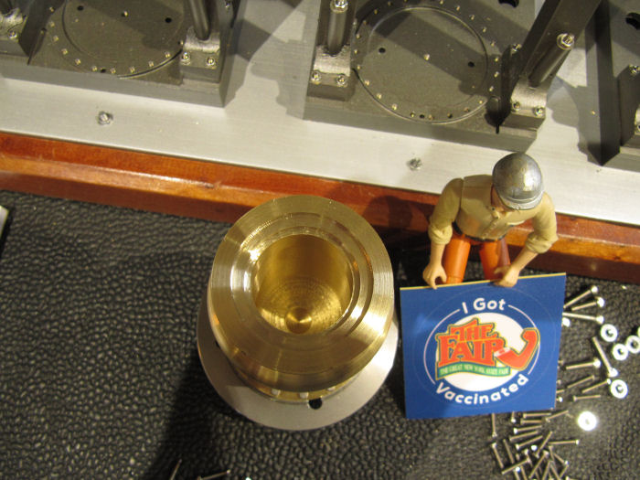

One ornate brass pump chamber all turned down to shape, being shown off by a happy shop elf just back from his shot
A look inside, showing the lip for the o ring seal and how it widens out down inside
The top needs to be drilled/tapped for the seal retaining ring, and there are more parts to add to the outside - brackets for the vertical supports, and the pipe flanges. I am planning on building check valves into the pipe flange extensions. But, that work needs to wait a day since I want to leave the mill set up at the proper setting for the bottom end bolt holes, and this was the last of the 2-1/4" brass rod that I had on hand, the new bar will be here tomorrow. So, in the meantime I've started bolting the printed pipework/housings together. Lots, and lots, and lots of tiny nuts to thread on...
