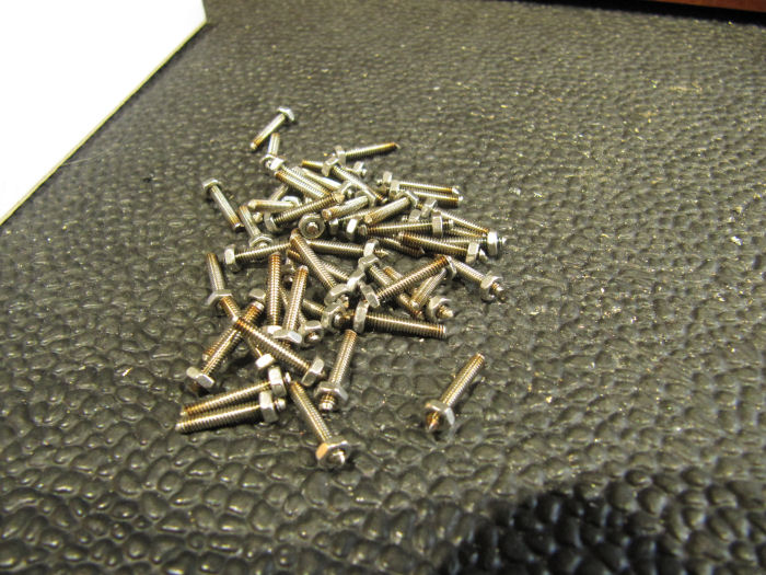

Actually have made the studs needed for the lower ends this afternoon - 48 for the pad corners, 12 for the longer tubes, plus another dozen to get started on the upper ends. Cut them on my little hobby size chop saw with an abrasive wheel, cleaned up the ends on the belt sander, and loctited nuts near one end of each, which are curing now. I'd do more, but my fingers said thats enough and went for a snack!

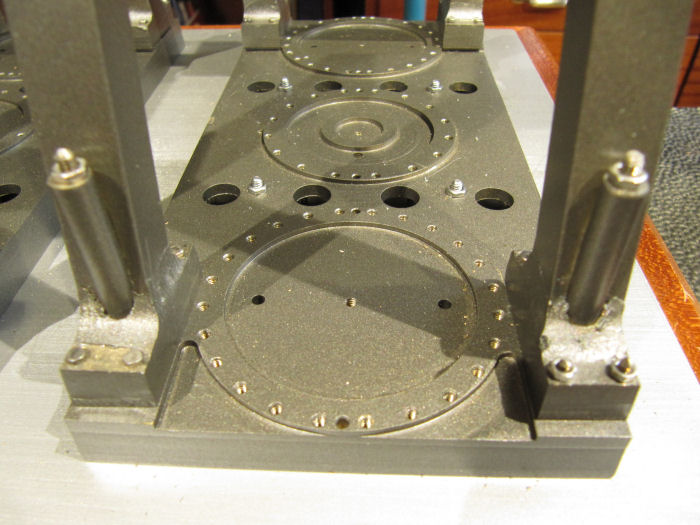

Here is a shot of the difference - on the left the frame rail is held on with hex head screws (not bad) where the right has the studs (better). Also, you can see the larger studs holding the assembly to the floor using the tubes in the frame rails.

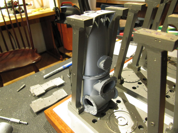

The 3D printer has been chugging away in the other room too, have the lower pipe sections as well as the lower valve housings all printed and ready for sanding/painting. Now have started in on the upper pipes and the force chambers, which sit above the valve housings - the force chambers were kept partly full of air to act as a cushion against water hammering and even out the pressures that vary during the pump strokes. The three pumps were simple rams, single acting, 120 degrees apart on the crankshaft, so the pressures would oscillate a bit during each revolution.
The pipe at the bottom is the water intake - just above that was a large set of check valves, beyond which the water would flow through the oblong pipe to the center pump ram chamber. Above the oblong pipe was another platform full of check valves leading to the force chamber above, and ultimately to the output pipe on the outside of the force chamber, visible in this photo:
The hole at the top of the force chamber will take a pipe that was used to pump air in/out to adjust the water level in the top chamber. The smaller round covered ports were manholes to allow access to the check valves. Hundreds and hundreds of check valves!

What were your print settings when you printed those parts, filament type, layer height, infill, etc... enquiring 3D printers want to know.

Did they have studs in the floor to connect the frames to?  In the picture in Reply #260, it looks like two hex-head bolts there.  It could be studs though.  Hard to tell. You have access to higher-res pictures though...

Hi Don,  will look up the settings later, what I recall is these are .15mm and .20mm layers depending on the part, PLA, .4mm nozzle.

They are studs, not much protuding. The printed parts are coming out well, the shallow curves need some smoothing. After experiments settled on fine paper, slowest speed, with the little detail sander, any faster it heats up too much. Using a wet dry paper, dipping the part in water frequently. Let dry, and it paints nicely.

Used 15% infill, though on these parts there is not much infill. Gyroid infill pattern. Monotonic top/bottom, 5 layers.

Looking through the high res pictures more, the lowest level uses studs, the upper levels are hex head bolts. The lower level studs have little sticking through, and most have enough dust/dirt on top that its hard to tell.

Do they have 1 & 1/2 threads protruding through the nut? :)  Isn't that the standard I've heard people talk about?    :Lol:

Looks to be about that in the pictures.
