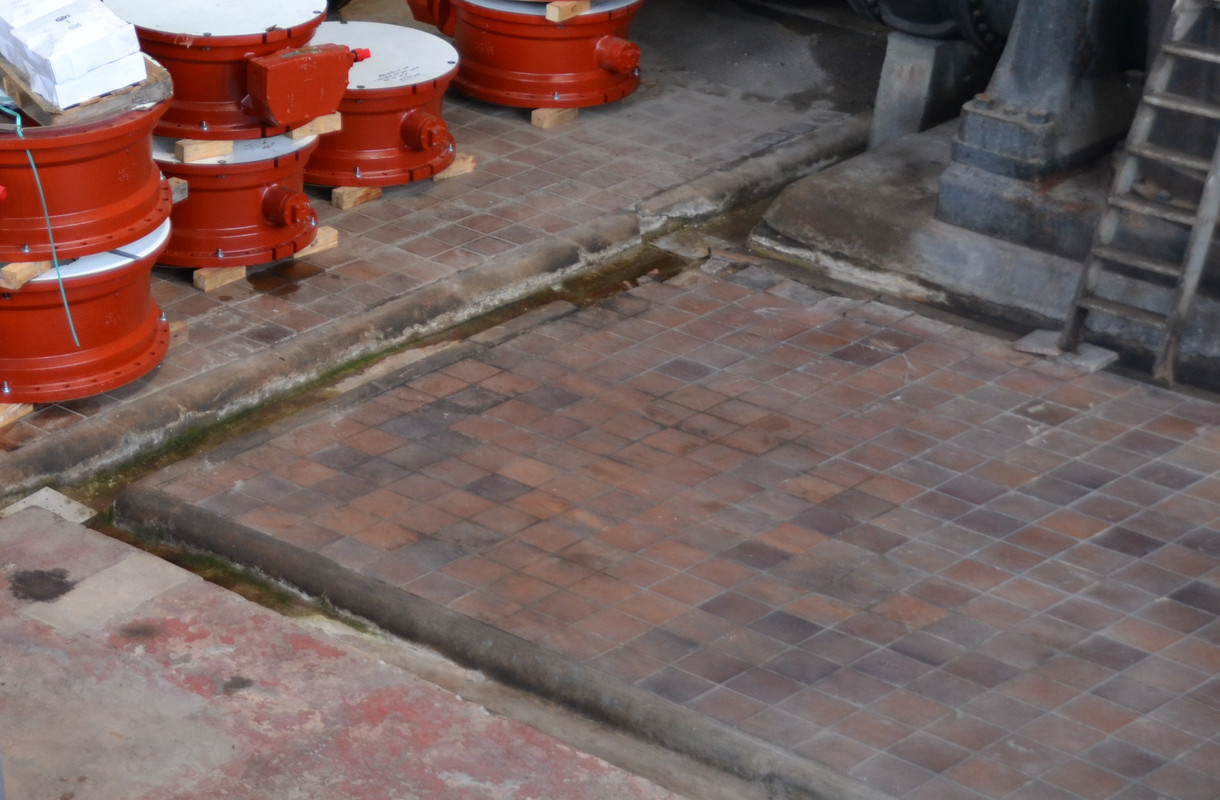

« Reply #257 on: April 13, 2021, 02:43:15 AM »
There appears to be a bricked in floor area [in yellow] immediately up to the actual Plinth of the unit......[Plinth = Base]

How many times have I looked at all the photos and never noticed that! Or in person either that day.  Checked the original full-res images, and it does appear to be some sort of square tile, about 1'  or 18" square, where I thought it was just concrete. So much old dirt on it that I never saw that. Good catch!  In the plans they just show poured concrete, so my brain fixed on that. Good catch!   :ThumbsUp:
In some of the full-res pictures I can see where the area between the three cast base plates is raised concrete, and around the edges it is crumbled at the bottom, wonder if they had made changes/repairs at some point? Or if it was the tile around the raised area always. Huh.  Its so much fun to keep finding new details!

Interesting detail in the corner of one of the pictures in the collection, here you can see the corner of the engine and its base in the upper right, next to that is a channel around the base with a raised area that has the tiles. Makes sense, that gives any spilled water places to be channelled away without getting the whole floor and anything on it wet.

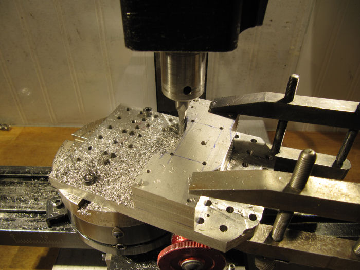

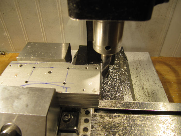

This morning started in on shaping the engine bed end plates, first cut the recesses at the corners and the section on the other side in the middle. The plates were stacked and bolted together so all could be done at once.
Then moved the stack to the rotary table to cut the arcs, which are concentric to each other so only one time to center/position the stack.

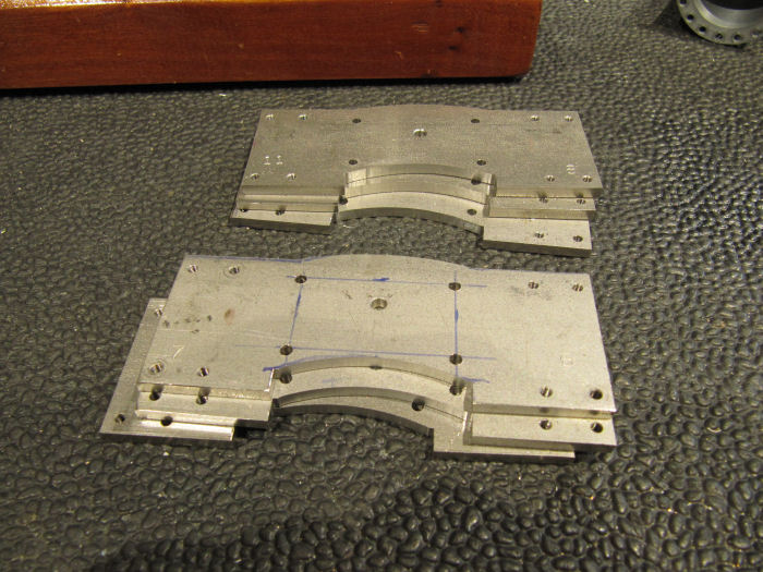

Here are the shaped plates:

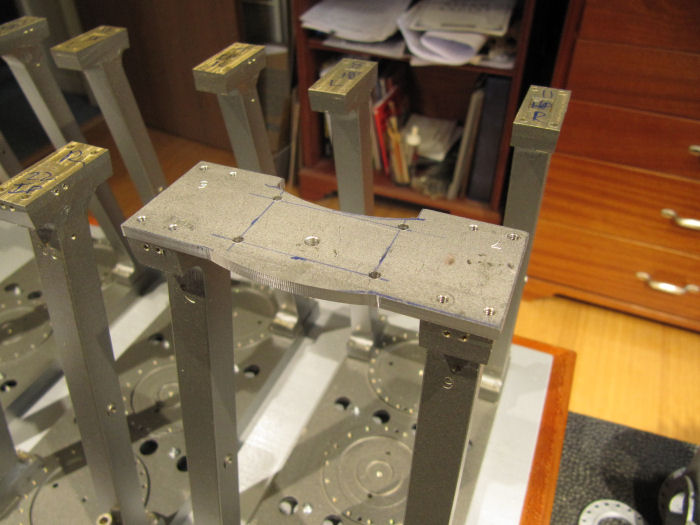

and showing where they will sit on top of the lower frame rails:
Next step? Think I will make the studs to hold the frame rails to the bases, the corner ones are 2-56, the long ones in the tubes are 4-40.  After that will likely start on the pump chambers that go in the center of each base plate....
