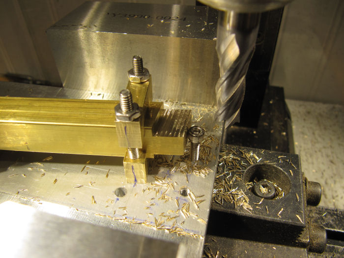

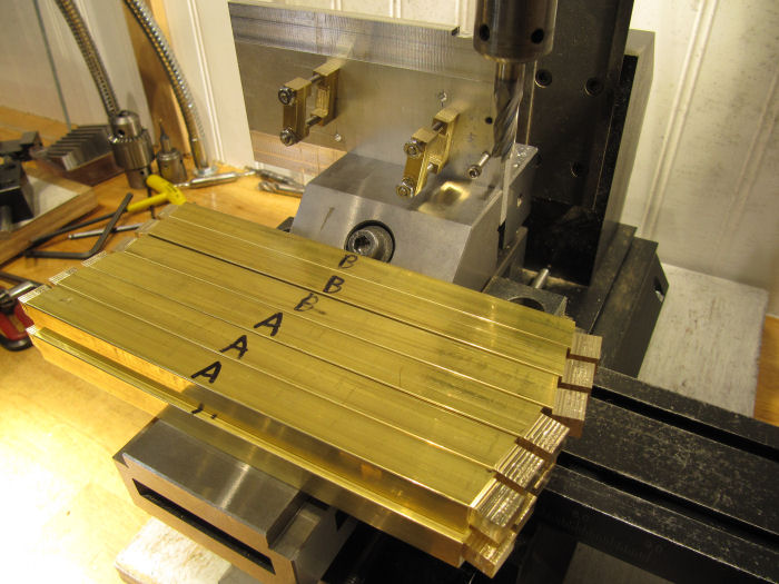

There is a screw for the rails to register against for the tenon cuts. I removed that for the overall-length cuts since the end mill has to cover that whole face. The rails are too long to put a screw or block at the other end, and that is how I am sliding in the blanks anyway. Since the last post I have finished cutting them all to length, just needed to make an initial cut on the second end, stop and measure, and see how much farther to advance the cut to finish.

After finishing up the trimming to overall length, with the compound angles on both ends of the rails,
I've started in on the tenon cuts. For these, there is a screw at the near end to act as a stop when putting in the rail, which will both make it easy to get the length of the cut horizontally repeatable, but it also is important for getting the depth vertically the same. Since the rails are at an angle in both directions, if one rail goes farther out from the cradle than another, it would get a different vertical amount of cutting. This way, its possible to get a repeatable placement for all four cuts on each end of the rails.
I'll go through the first cut for each rail, then set up for the second cut. Even though there are four rails in each set, there are actually only two combinations of the angles in each set, the other two can be cut the same then flipped end for end - possible since the pads at top and bottom will be both parallel and the same thickness.

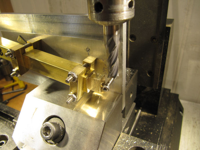

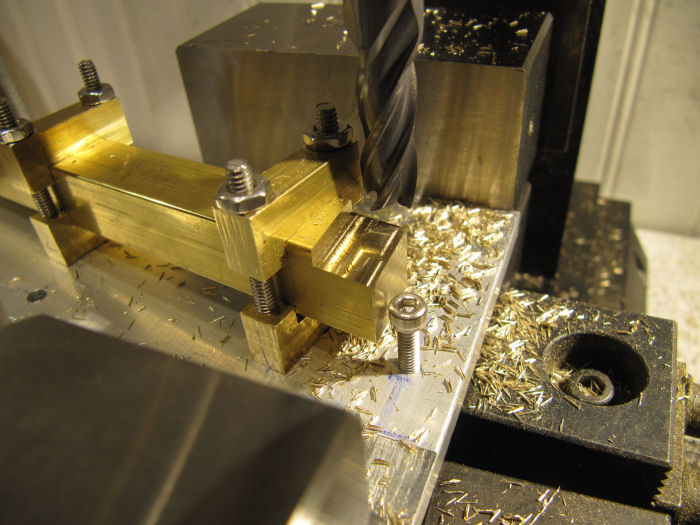

Continued on with milling the sides of the tenons....
till both sides were done at each end of all the rails
Now have set the jig vertically to start on the other sides, same basic setup and moves, half have a shim under the right end, rest have a shim under the left end, and half will be done with the jig in this position, rest with the jig flipped over to other angle.
So far so good, the third side has lined up with the ends of the other two...

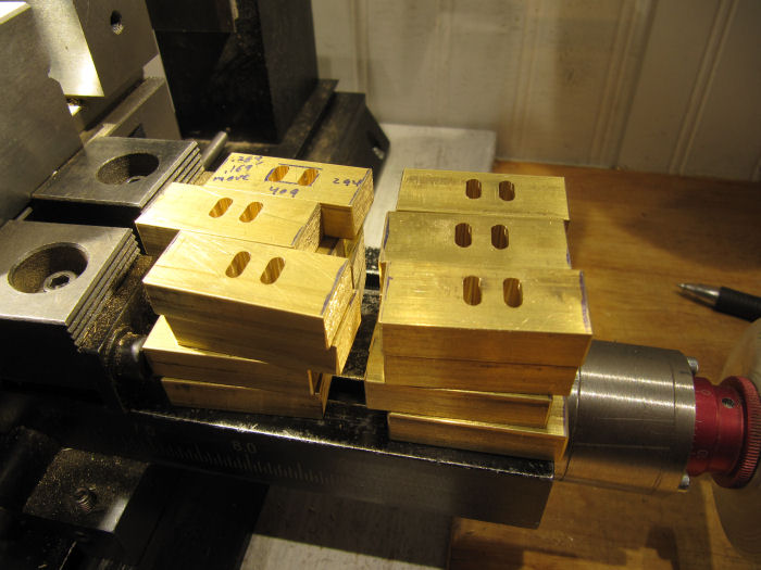

A few more shop sessions this afternoon, got the rest of the tenons cut on the lower frame rails:
Here is the pile of rails, ready to make the pads for the top/bottom of each that let them bolt to the bases and the engine bases up above:
They still need a little thickness trimming, the dimension in one direction is just under 1/2".  I did take a bar of 3/8" x 5/8" stock and cut it into segments for the pads - the cut depth stop on the bandsaw comes in handy for these kinds of cuts.
Um, the shop elves found the stack of pad blanks, and think that they have found my stash of gold bars. Don't have the heart to tell them its just brass, will wait till tomorrow - let them celebrate tonight!  They'll probably put on the tape of Kelly's Heroes and act out the scenes with them....
The pads will get rectangular mortise holes milled in them to take the tenons on the rails. Playing with the idea of making a little adapter plate for the broach, to do the square inside corners. Either that or file the drilled holes to square off the corners.

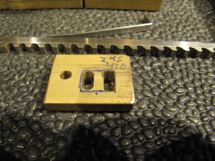

Well, I was not expecting that to work out so easy!  I was looking ahead a little to how I was going to make the mortises in the pads to take the rectangular tenons from the frame rails. Normally, when making a couple like that, I would just drill/mill the outline and file the corners square. But, in this case, there are 24 pads to make, four corners per, then do it again for the upper frames.... Lots of filing.
Last year I had picked up an arbor press and a small broaching set for the gears on the Mann truck. Yesterday had the idea of using the broaching cutter to do the squared corners, and figured that I would have to make a special guide to start in a narrow slot rather than the usual round hole.  This evening, to test that out, I grabbed a scrap bit of brass and drew the outline of the mortise needed, and milled a slot at either end with a 1/8" end mill.
Upon testing that with the 1/8" wide broach, it turned out that the depth of the broach worked out perfectly, I could run it through once with the slot as cut, then add the wedge to finish it off, and both wedges to do the other end of the slot. Instant (nearly) two squared corners! At most would take slight filing to get a good fit on the tenon.
In the photo, the slot on the left is as- milled, the one on the right is after broaching. All I'd need to do then is to make a couple more passes to connect the slots and leave the rectangle. Hmmmm!  This will work out perfect for making the mortises in the pads!
 :pinkelephant:

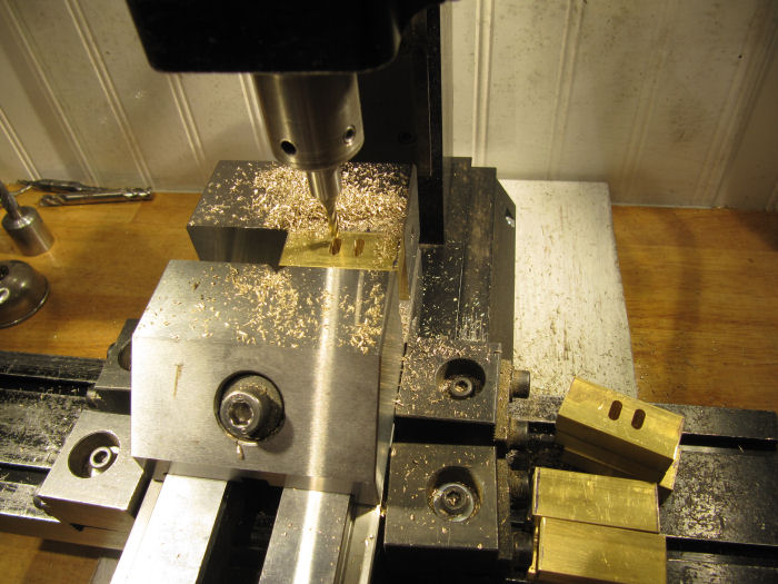

Today got a start on the lower frame end pads, making them as mentioned in yesterdays post, milling the two slots at the ends of the mortise opening, and will square the ends of the slots with the broach.
After a few sessions of milling (time out for lunch, some reading out on the front porch once it warmed up enough after the snow yesterday), got the pile of pads milled, ready for the broach.
