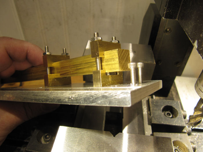

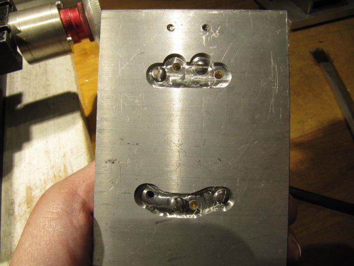

Okay, so, back on the pumping engine lower frames.  I made up Mk-2 of the holding jig, the first version not making past the eyeball-after-design phase.  This version uses a single base plate, drilled with a pattern of holes determined in the CAD application to give the angles I need to give the frame rails the different direction lean in towards the center. Here is what I came up with to mill the angles on the upper and lower ends, plus mill the tenons at each end that will go through the pads to be added to the ends.
The bottom of the plate has two pairs of holes at either end to hold clamping cradles that will hold the frames at 10.23 degrees from the centerline. The areas around the holes on the bottom was recessed to let the screw heads sit in from the bottom of the plate so it will lay flat in the vise.
Here is a side view, showing the cradles clamped around the rail. The lower halves of the cradles are threaded, so they are held tight to the plate by the screws. The top halves of the cradles clamp down using nuts on each screw. Also, note the little piece of 1/16" thick stock under the frame rail/on top of the lower cradle at the right hand end of the photo. This lifts that end to give it the desired 1.7 degrees of lean in that direction. Depending on which end of which rail I am working on, this shim gets put on the cradle at one end of the rail or the other. In combination with putting the cradles in one pair of holes or the other, all the combinations needed for compound angles on the rails/tenons can be done.

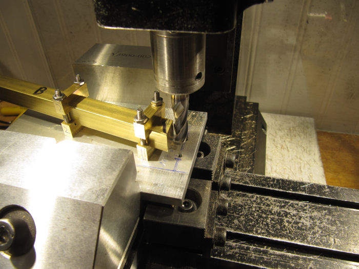

So, here is the jig clamped down in the mill vise in the position used to cut the angle on the end as well as the tenon cuts on the top/bottom of the rail.

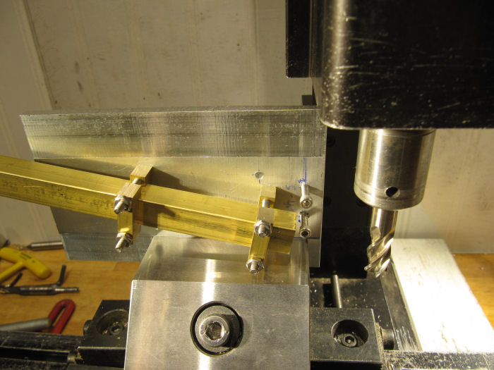

To cut the tenon sides, and get a square corner where the tenon meets the main frame rail, the jig can be tipped up on either side. The shiny area on either side of the main plate is where I milled a shallow recess in the top of the plate, which gives a lip for the plate to sit on top of the vise jaws, aligning it level. I could not make the plate wide enough to reach the bottom of the vise without making it so wide it would not fit in the vise when down flat.
This looks like it will work out. Yes, a lot of work to make the jig, but considering that I need to cut angles and tenons on all four sides of both ends of 12 frame rails, it is well worth it in time and accuracy gained.

The jig setup looks great Chris, time well spent I think, and the frames will be that much better, I think, than with no jig.  :cheers:

Started in milling the compound angles on the ends of the pump frame rails this morning. All the rails are marked on two faces at each end for which direction the angles go, to help ensure that they go into the jig in the proper orientation.
It will take a while to run through all of them, the first ends will go a bit quicker, the second ends slower since the overall length has to be measured and the parts taken to dimension.  After the ends all get angled, then will start on the tenon cutting...

Thanks guys! As expected, cutting the compound angle on the first end of every piece went pretty quick, and the second ends are goin slower since I have to stop and measure the length on each one, sneaking up on the finished dimension. So far the jig is working quite well.

Just a thought Chris - Could you glue a block onto the base of the jig temporarily to register against the first end cut of each frame? If you cut the first frame against the block and sneak up on the length dimension for the first one, and don't move the table afterward, the other frames fitted in the jig and pushed up to the block and cut at same settings will be same length. (all of them right, or all of them wrong - don't ask me how I know that :Lol:)
You probably need to break the block's glue joint and move it for the opposite hand frames, but it could save some moves / measurement. Hope it helps. Back to my shop now! (impulse engine only today, 0 warp factor) :cheers:
