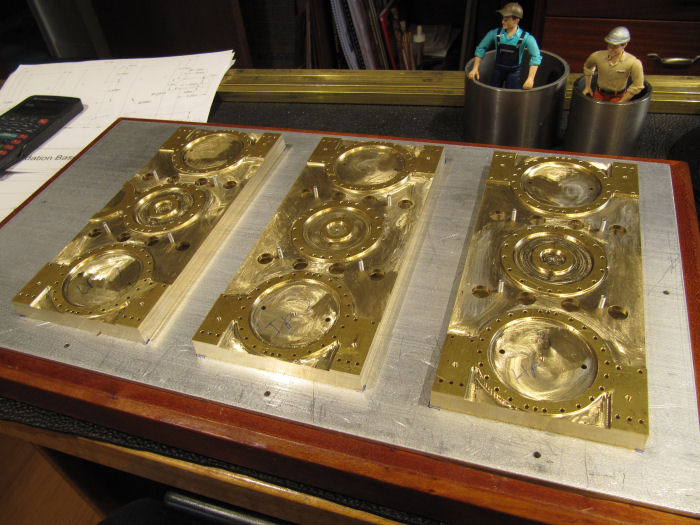

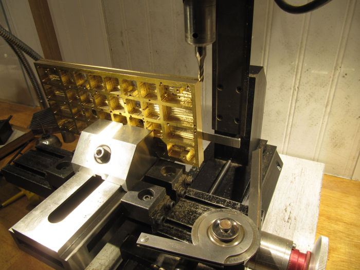

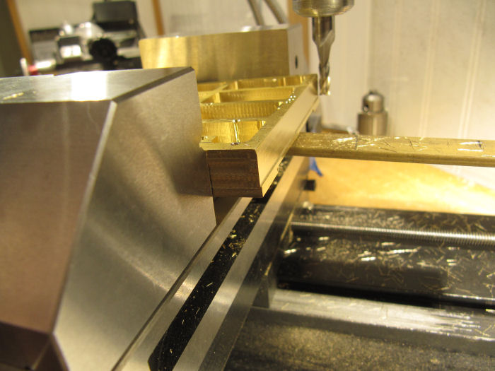

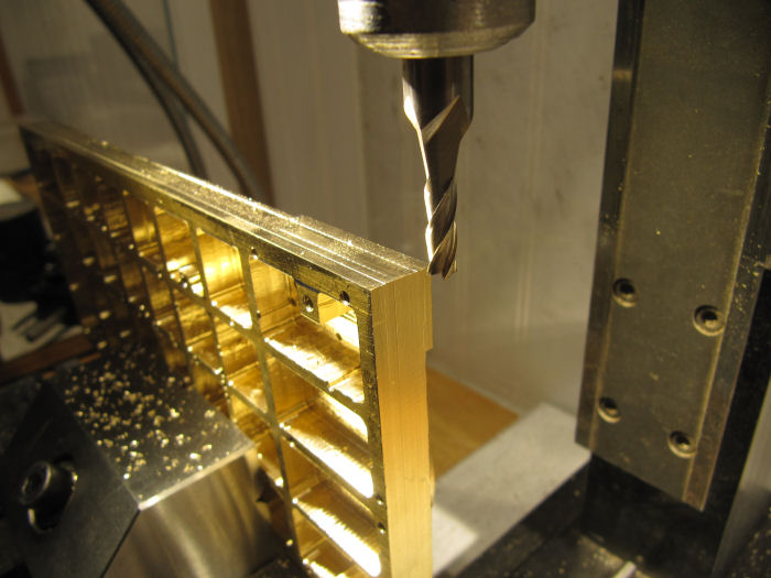

So, with the waffle-maker patterns complete, last bit of milling is to angle the edges of the plates. For the long sides, the plates were stood up on edge and shims put at the bottom on one side and the top on the other side to tilt it over the 4.9 degree angle, checked with a protractor.
The mill height was set to cut almost to the lower edge, and passes made to take the side down, leaving a lip at the top. That lip was then taken off square to the plate by removing the shims and letting the plate stand vertical.
For the short edges, standing it up on end would leave too much sticking out of the vise, so I turned the vise sideways and put a shim under one end of the plate.
then likewise setting the plate flat and milling the lip at the top off. Here is a vieew of the completed angles - doesn't show up that great in the pictures, but in person the compound angles give a nice look, much better than the square vertical edges. I assume they did the angles to make it easier to make and remove the casting molds. Thats a good question for the casting experts out there - would something this huge be done in a sand mold, or would they have done it some other way that I cannot think of? In modern construction a lot of stuff like this would be pieced up by welding robots, but that was not an option back then.   :thinking:

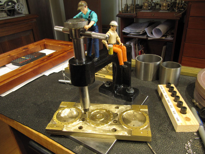

Some done this morning - got the bolt holes drilled through the aluminum floor plate (currently being painted concrete grey) for the base plates and the wood base. It was too big for one go in the mill, so I laid out and drilled the holes down one side, bolted the bases on, and used them as drill guides for the other holes (after making sure they were nice and square to the floor and the proper distances apart). There are 8 holes holding each base down, one in each corner under the frame pads, and four more closer to the center. The bolts for the corners will go up through the frames, and get a nut where they come out on the frame legs (this is how the originals were).
Then, the UPS truck showed up just in time with my order from LMS of a hand tapping jig. Never used one before, but with this many holes in the bases and all the small holes to come in the frames and floor plates, thought it was worth a try. Looks very promising, did the first 8 or 10 holes pretty quick with a 2-56 tap. Couple complaints with it: it is set up and labeled for inch-size tap bases, but its set screws are all metric sockets.   :facepalm2:   The holes in the adapters for the taps are too large, so the tap gets held off-center - I made a little brass bushing for the small tap sizes to fix that, easy. Lastly, the big bolts that hold the upper frame to the base plate it came with are too long, and stuck out the bottom, causing it to rock. An extra washer fixed that. Simple stuff. Overall, I like it, and it saved me the time/materials to make my own.
And its easy enough to use that a couple cookies have bribed, er, enticed, the shop elves to help out!

A thought on the metric setscrews - if you change them to be a little longer you can maybe order ones with a slot for a screwdriver or cut a slot in them for one yourself. Or silver solder inch size sockets from inch capscrews onto them!
In my case I'd consider firing up my homebuilt EDM and burn the sockets out to next bigger inch size using a hex brass or copper electrode. For small setscrews it would only take a few minutes' burn time.

Wonderful  :praise2:  :praise2: So many holes and so much swarf  :)  :ThumbsUp:  :wine1:
Is the tapping tool designed to be lubricated with Elfsteiner?
I tend to use my little Proxxon bench drill as a tapping tool but I am usually working against the return spring.
  • Posts: 18708
« Reply #104 on: March 23, 2021, 07:38:52 PM »
I actually considered doing that, if I spot a used one cheap I'd have gotten it, taken off that spring, and put a t handle on the top pulley.
