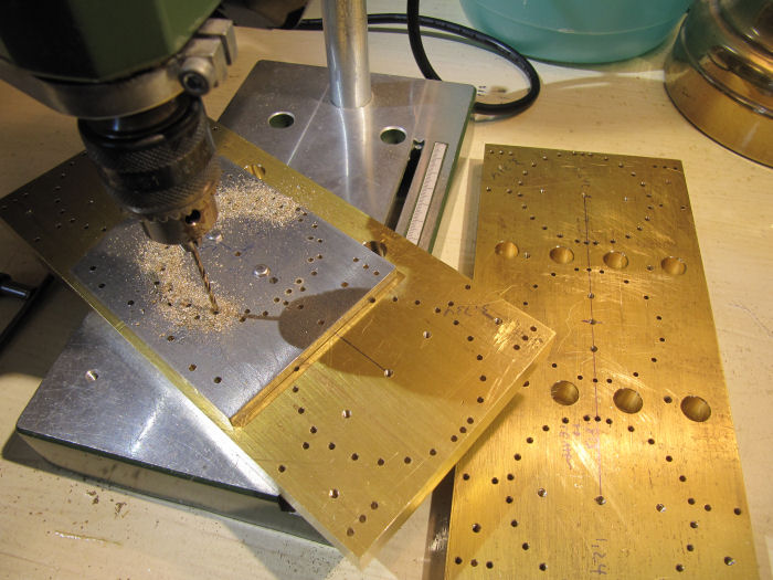

As mentioned, I got another circle of holes in the drill guide for the center pattern, which will hold the pump plunger chamber. This pattern is a little smaller diameter and has fewer holes. Used that like with the outer patterns in the small drill press:

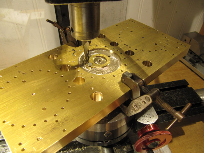

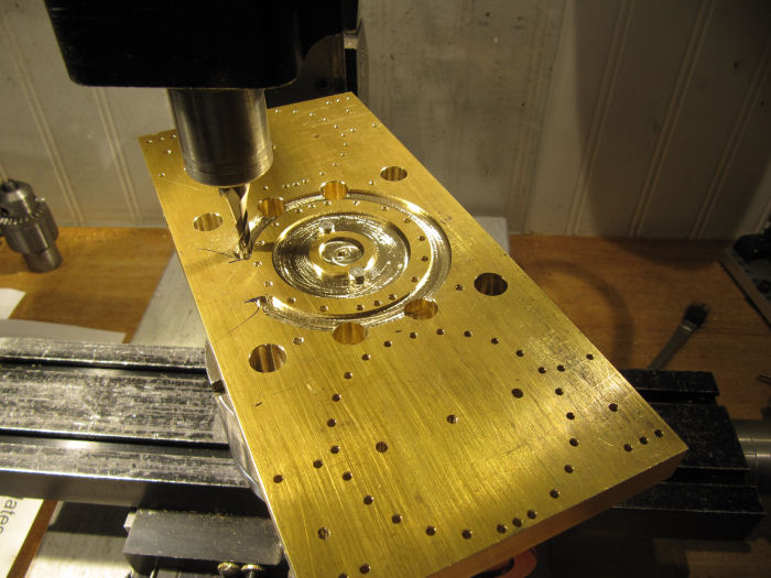

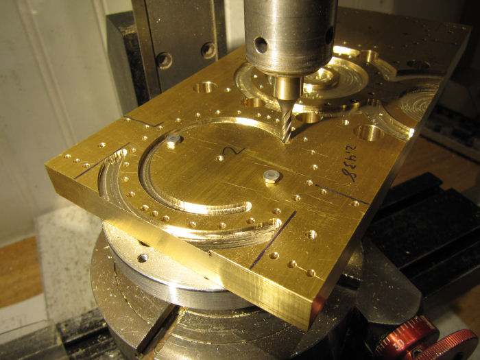

With all the holes drilled in the base plates, time to start the relief shaping on the top surfaces. Started with the center rings, milled in on the rotary table with the plate held on a faceplate drilled/tapped to match the holes in the plate.
To get the relief cuts in past the screws, some clamps were used to finish those areas, with the screws taken out.
Then finished up with the outer ring.

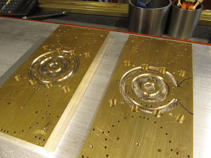

Center rings cut in on the first two plates:
One more plate to go, then will start on the outer rings. The field around all the rings will be taken down after that, leaving the pads at the corners where the engine upright frames attach.

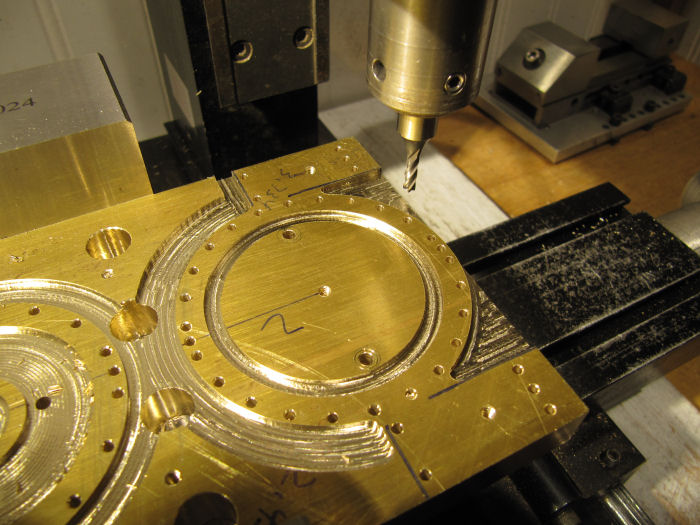

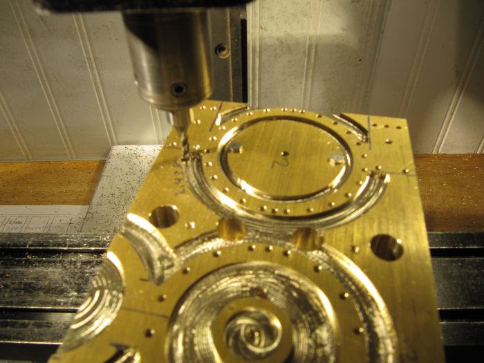

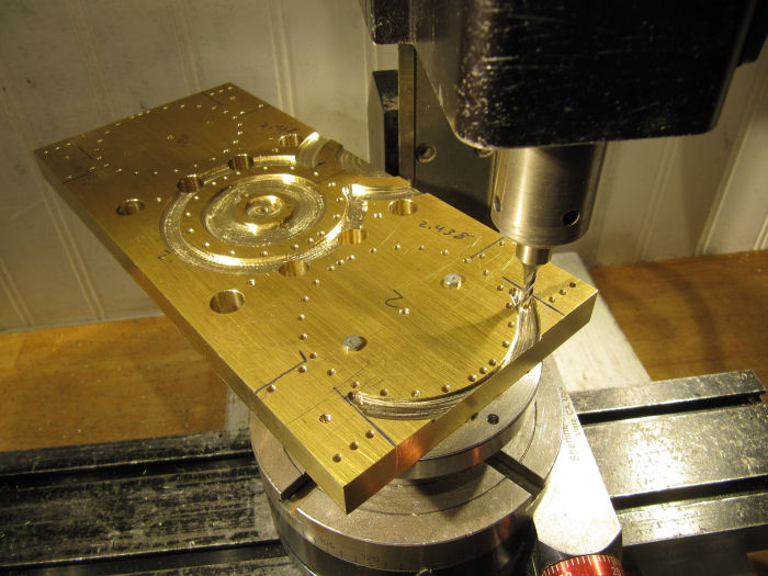

Got the center rings on all three plates milled down, then did the one plate with the partial ring out the side that I mentioned:
Then started in on the outer rings, beginning with the shapes at the very end - the pads at the corner that will hold the frame uprights, and the edge of the ring between them.
Doing the rest of the rings needed a couple of steps, since the base plates are too long to be able to swing in a full circle without hitting the mill column. So, with the center of the rotary table off to one side, did the first 3/4 or so of each circle:
then movedf the table over to the other side of the column to finish off the arcs. The outsides of the rings meet the corner pads, so I stopped a little short there, and will do the pad edges with the bases held in the vise.

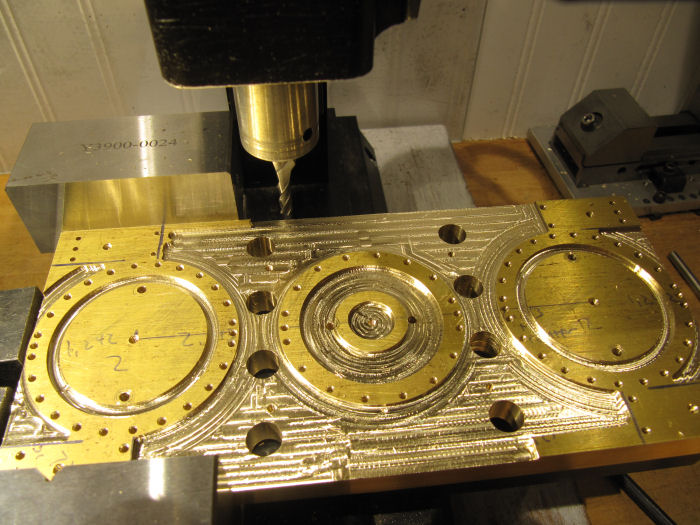

With all the rings outlined, switched out the rotary table for the big mill vise, and squared up the edges of the corner pads
That leaves the rest of the field areas to take down, doing that in sections to reduce the overhang from the vise:
The tool marks show up looking nasty in the shop lights, but they feel smooth. I'll take them down with some sanding to a clean finish.
