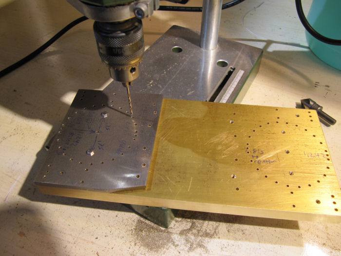

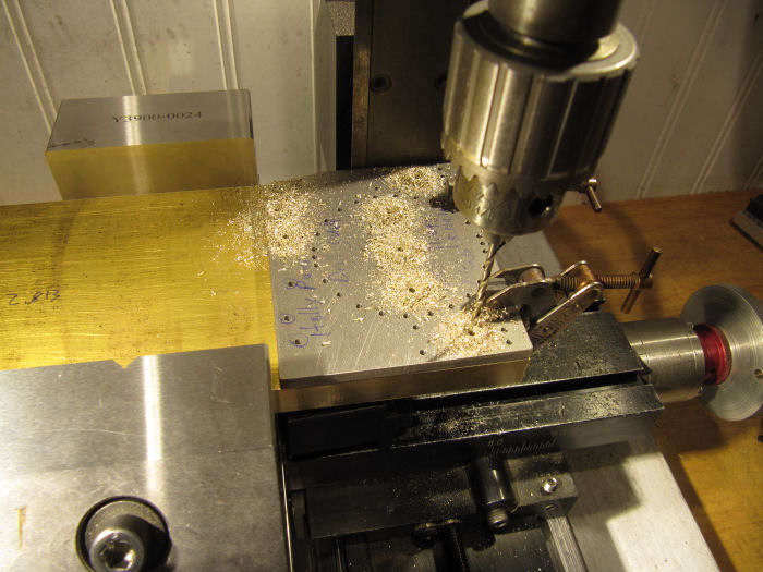

« Reply #42 on: March 15, 2021, 09:22:34 PM »
More done on the base plates - clamped the drill guide to each end of each of the plates, and drilled the larger diameter holes, which are the registration holes for the uprights and the plates to the floor. These holes were then tapped.
Next step is to drill all the smaller holes (2-56 tap size), which will hold the pump valve chambers and the corners of the uprights. For these, the drill guide was bolted down, and I am using the small Proxxon drill press since the drill needs to be 'pecked' going through, removing it frequently to help clear chips in these deep holes. The mill would work for this, but it takes a lot longer to crank it up/down than to just move the lever on the drill press. The little drill press has a good feel for this kind of work, and the drill guide self-aligns with the holes when starting as long as I dont hold the plate too hard till it gets started.
In the picture, the first side (on the right) has had all the holes drilled, and its ready to drill the set on the left. Once all three plates are drilled this way, I'll set up to do a similar pattern in the center of each plate for the main pump chamber. Then, LOTS of holes to tap! Going to be at this stage for a while.... (whenever these jobs come up, the shop elves always have excuses, doctor appointments, trade shows, elf conventions, whatever, so they can't help out! )
