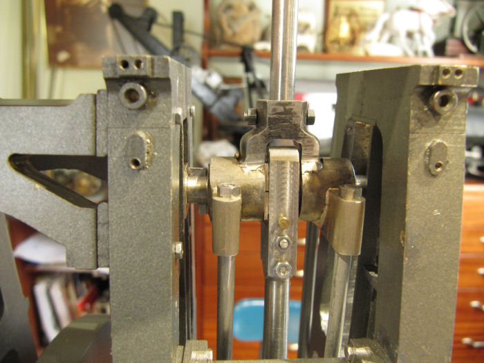

Hi Chris , that is an interesting concept and has set my brain ticking over  !! So ..no need for heavy slide bars  I haven't seen this before !!
Willy
  • Posts: 18679
« Reply #2101 on: January 24, 2022, 07:58:51 PM »
Willy
Willy, the crossheads themselves still ride in guide bars in the engine frame, the pump plungers are piggybacking on the same guides.
  • Posts: 3245
« Reply #2102 on: January 25, 2022, 02:58:27 AM »
Hi Chris ,  Yes  of course .. makes for a more compact engine ?!!  I was looking in the previous posts  !!
Thanks
Willy
Offline Charles Lamont
  • Posts: 326
« Reply #2103 on: January 25, 2022, 09:17:02 AM »
IIRC it was done at a smaller scale. Fire engine pumps, for example, used a scotch yoke between the piston and pump rods, and no guidebars. On these engines the crankshaft is there only for smooth running, valve drive and synchrony; no power output.
