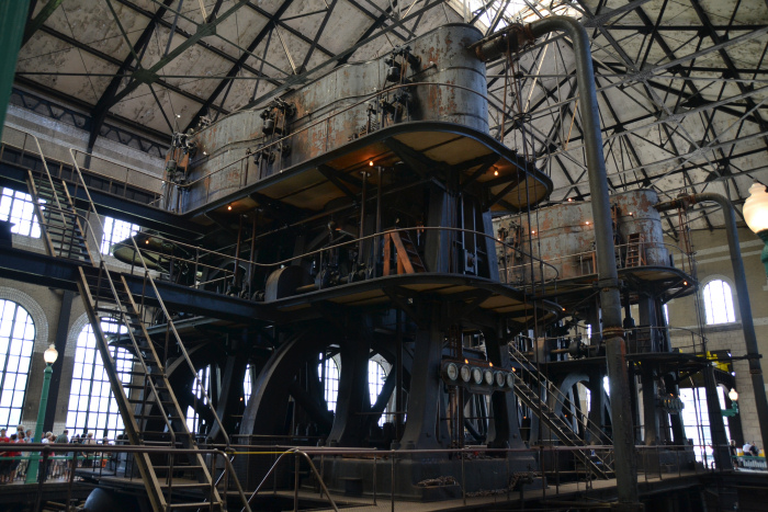

This picture better shows the external stairs and catwalks that are between the engines - they go up to all three levels of the engine platforms. One set of stairs serves two engines.
So when are you making the second one?

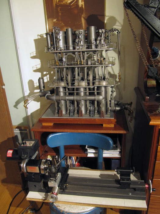

Awesome work, Id love to see this alongside the little lathe that built it, its an impressive looking engine

A second one?   :paranoia:     Well, better than making the other four that are in the row of them.... Or the seven in a row that Cincinatti once had in its Main Station pumphouse!
And the Sherline lathe at least is very easy to move over in front of the model! Lets see you do THAT with a Southbend or whatever!   :Lol:   The lathe wieghs about a tenth of the model...

« Reply #2096 on: January 23, 2022, 11:42:57 PM »
Its incredible what can be done on such an unassuming bit of equipment

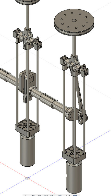

One thing I missed in this is where the rods for the pumps are connected.  Eccentric hidden away?
« Reply #2099 on: January 24, 2022, 02:09:29 PM »
Hi kvom,
The pump plungers have four rods coming up around the cranks, and connect to the crossheads to the piston rods:
Makes them hard to see in the model, back behind all the frames and such. By taking the power direct from the crossheads, they got maximum force from the piston. The Allis engine worked the same way. The pump rod length also would keep the pump plungers aligned.
