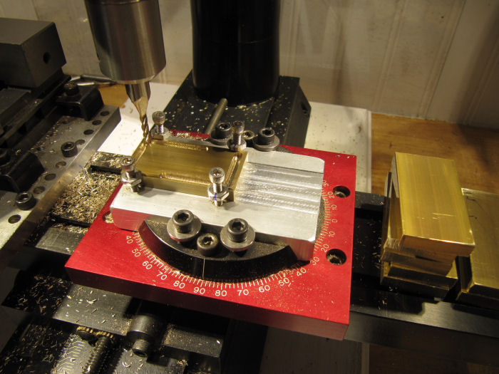

And moving on to the middle level catwalk brackets, just like the first ones but shorter horizontally...
I really like that fixture.   That would work well on the F1.....

Continuing on with the second catwalk brackets, got all the milling cuts for the profiles down except for parting them off from the bar:
This batch is definitely going quicker now that I have the procedure down, and have combined some steps to reduce the number of  times they need to be put in/out of the jig. As they say, Practice Makes A Mess. Or something like that...

Great looking chocolate moulds! Re the saying - I thought it was "practice makes Ford Prefects" - at least that might be it if you were from Dagenham in the UK..... :Lol:
Just kidding, the brackets look great.  :ThumbsUp: :ThumbsUp: :ThumbsUp: :popcorn: :popcorn: :popcorn:
