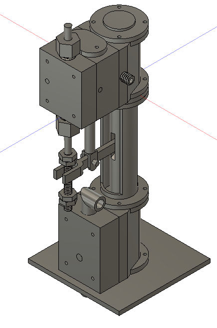

Making it larger should make it a bit less touchy on the timing adjustments, and hopefully will result in running slower than really small engines tend to want to. It winds up with a 3/4" diameter piston and a cylinder block 1-5/8" long, which I can get out of some chunks of brass bar sitting on the stock shelf already. It looks like I can build the entire project with material already on hand, which is handy.  ;D To make it easier to follow the plans without having to remember to double everything on the fly, and to adjust a few things to use the fastener sizes I like, it was first drawn up in Fusion as a 3D CAD model, and new plans at the larger size printed out. Here is what it should end up looking like:

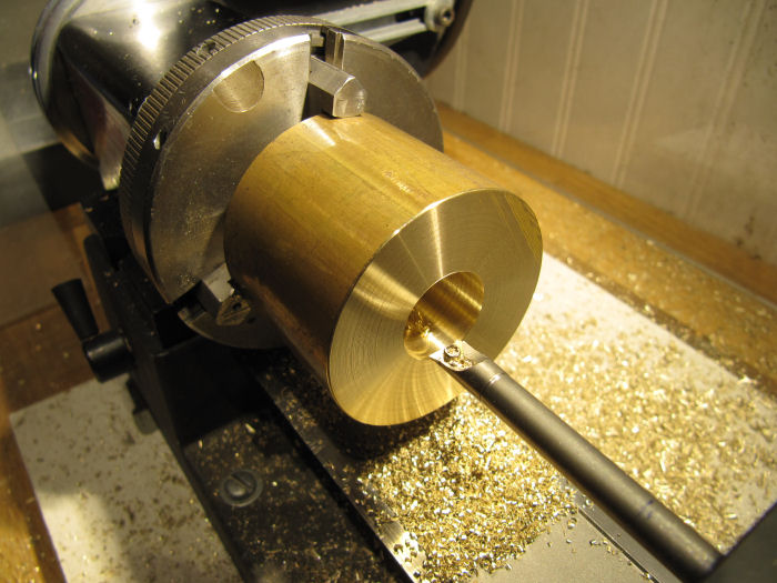

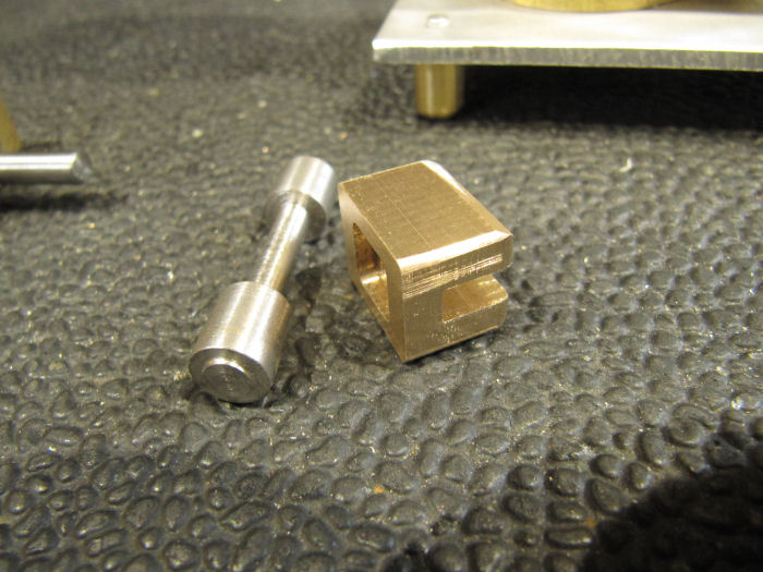

Started with the center seperator, which looks like a crosshead guide, but it is just a spacer - nothing will be touching the inside of the tube. Drilled/bored the center opening, then turned the outside to shape.
Then bored out the openings in the sides - these give room for the reversing arm to go from the piston rod out to the valve rod.

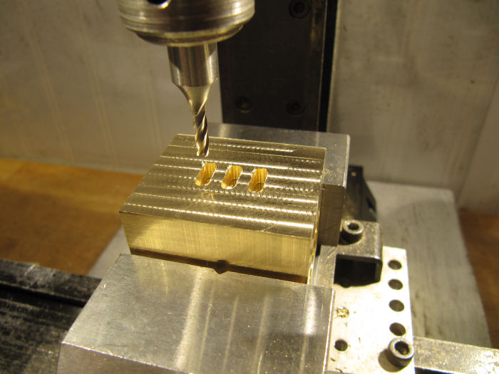

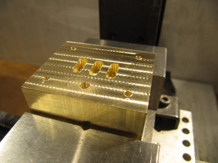

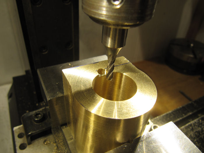

While the block was still leveled up in the vise, went ahead and milled in the steam ports, identical to a standard double acting cylinder:
plus the mounting holes and the hole for the passage into the valve chests above - here is where it starts varying from a standard engine, this passage will feed steam up to the reversing valve.

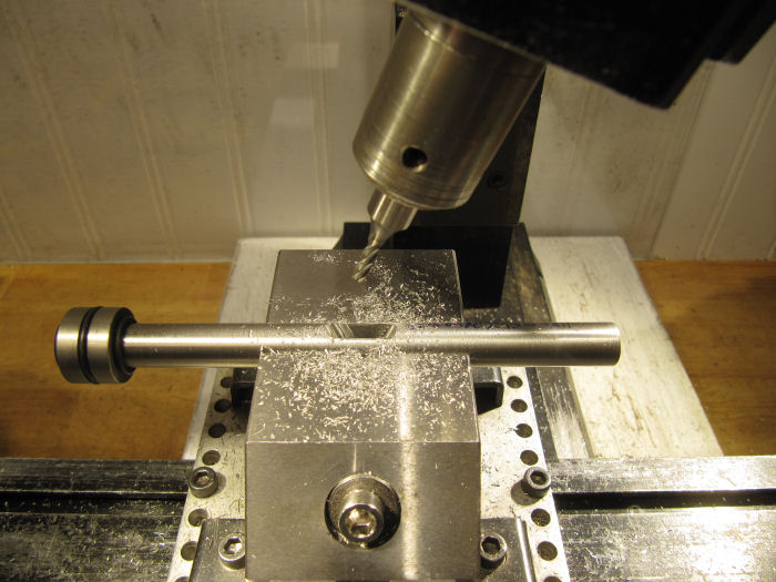

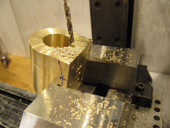

Also drilled the passages from the cylinder ends to the outer valve ports, first milling a flat so the drill would not skate:

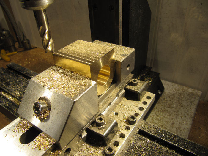

finished up by milling the openings from those holes to the ends of the cylinder:
Thats where it sits at the moment - next stage will be to set up the rotary table vertically to mill the open spaces between the end flanges on the cylinder blocks. Its all going pretty quickly, love how easily brass machines!

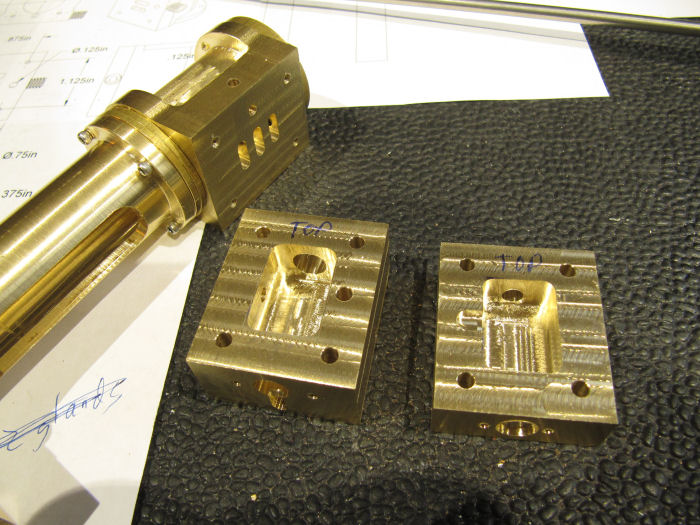

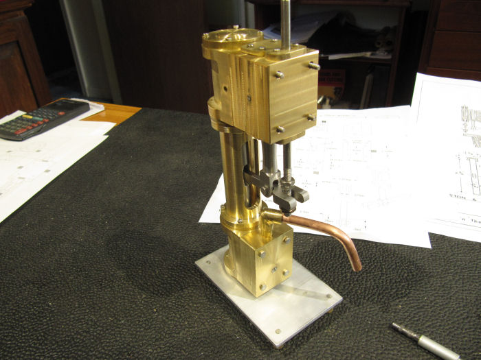

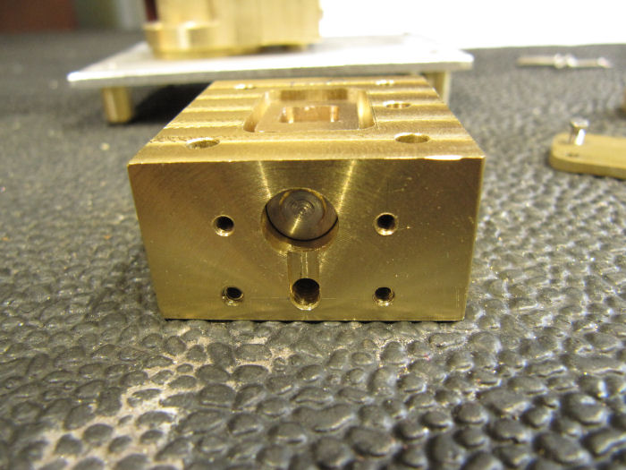

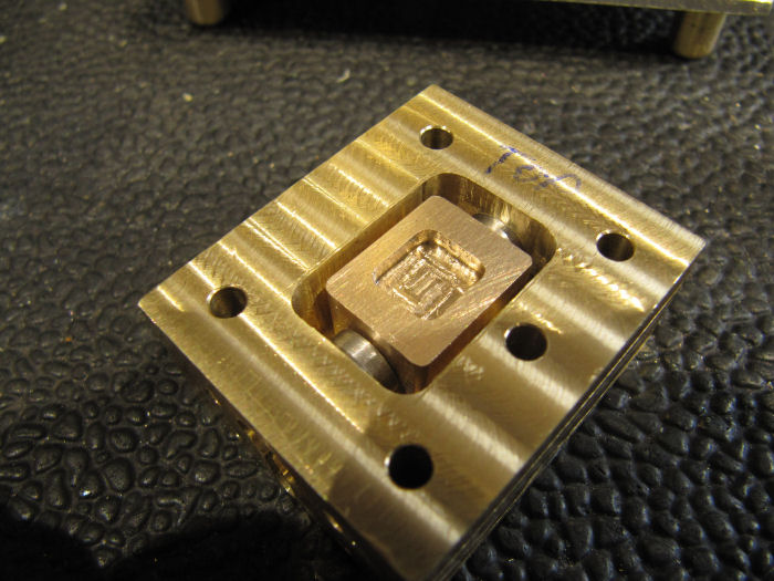

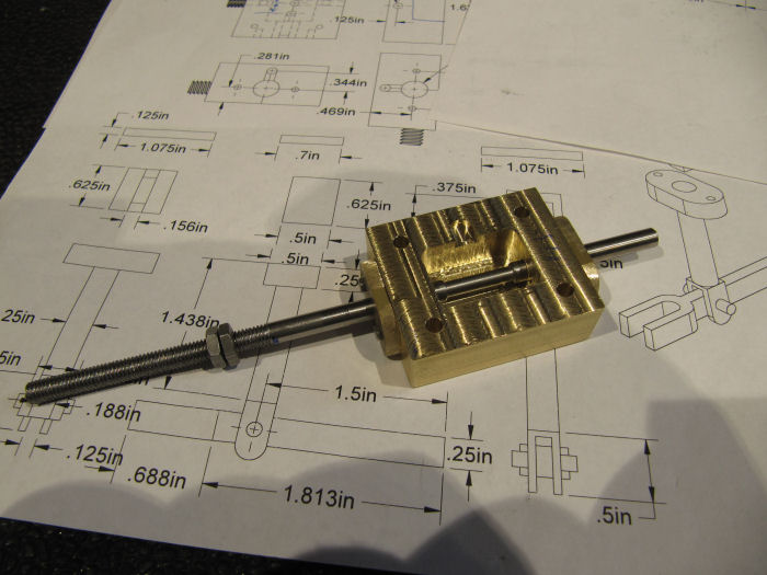

Got the sides of the cylinder and pump blocks recessed in
The end mill left a visible tool mark pattern, though it is smooth to the touch. So, a little sanding got it looking better. Here are the parts so far:
Next I think will be to drill the passages in the pump body, then will turn the end caps for the blocks and get the holes for all the cap mounts done at once.

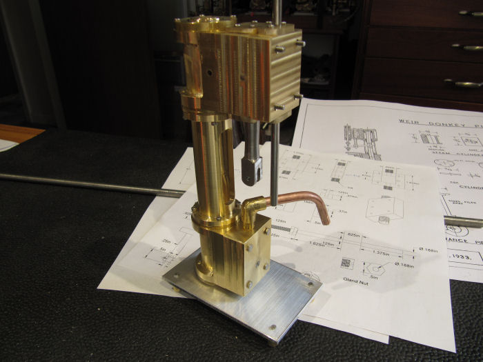

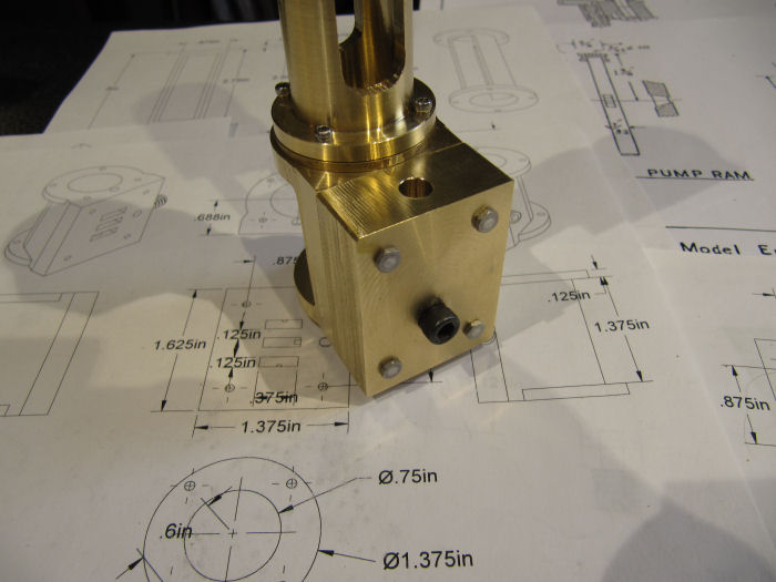

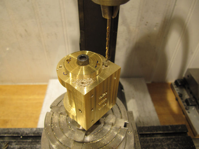

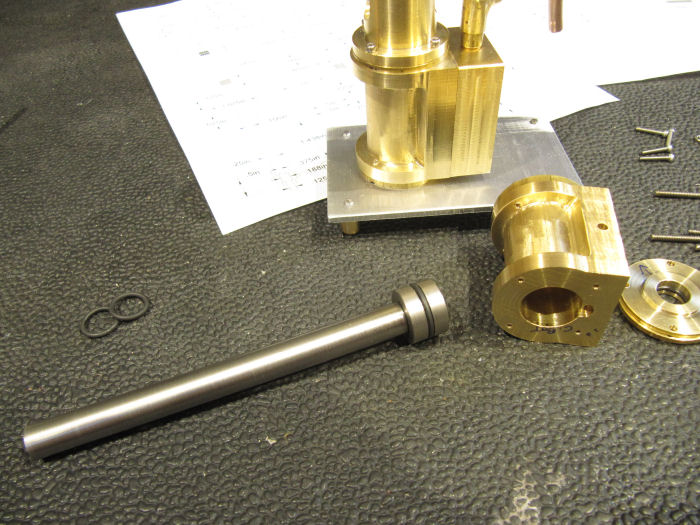

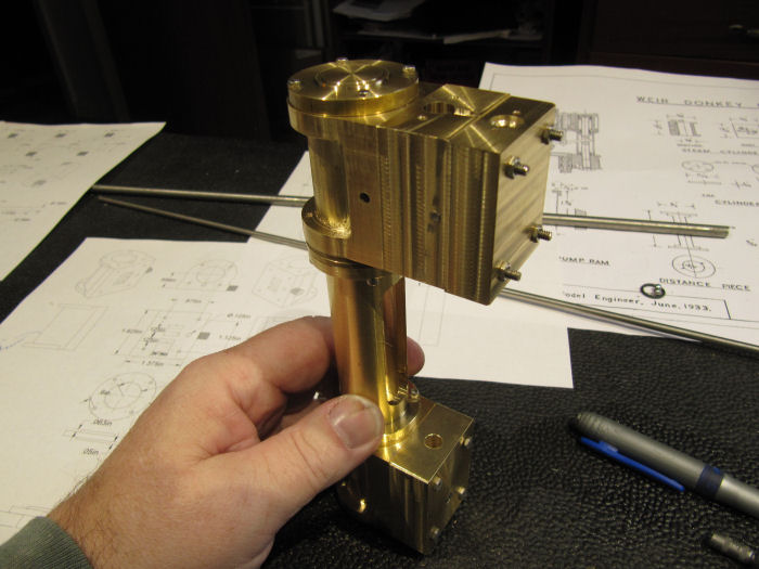

Yesterday I turned the cylinder/pump end caps, with recesses to hold an o-ring on the inner caps. The o-ring will provide a seal for the piston rod. Then set up on the mill to drill all the mounting holes in the caps, blocks, and center spacer.
Here are the parts all test fit - there was one hole that must have skated a little and required clearancing out the matching holes in the caps.
So far so good! Now will start on the passages for the pump end...
