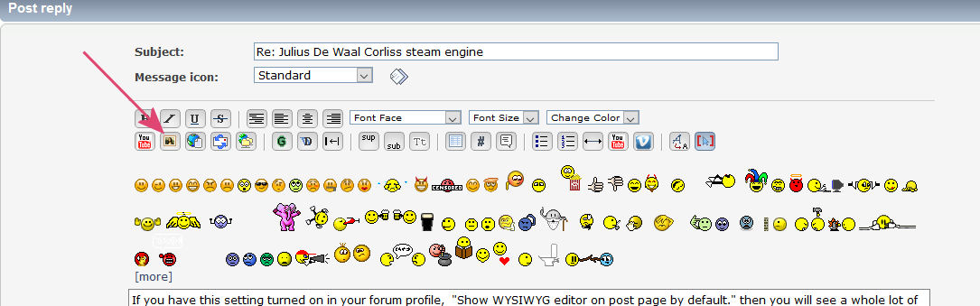

A general question: how can I insert the pictures between the text? I only see the "attachments" but then they appear below the text...
You're making some great progress Pieter!  And glad you are getting to enjoy some snow.  We haven't had any this winter yet, but we still may.
As for getting your pictures inline with the text - It's not hard, but it does require a bit more effort.   To do this, you have to host your photos at some external site.  Then, you embed a link to your photo in the body of your message using the URL tags:
          [ url] http://link_to_my_photo [ /url]
For the above, I have included a space between the opening bracket and the url tag, because if I didn't it would try to embed that link as a real image and it wouldn't work because that link is made up, of course.
Many people used to use Photo Bucket to host their images (including me).  But a couple of years ago Photo Bucket changed their policy and started blocking images to the free accounts.  This broke many people's photo links.  So most of us don't use photo bucket anymore. But there are many other photo-hosting sites that people do use.
It takes a bit more effort to embed your photos in your text, but to me, it is worth it.  I much prefer to read posts with the images embedded.  Makes it more interesting and easier to follow. That's my opinion only, so take it for what its worth!
Hope this helps,
  • Posts: 18713
Re: Julius De Waal Corliss steam engine
« Reply #28 on: January 24, 2021, 08:25:49 PM »
If you have this setting turned on in your forum profile,  "Show WYSIWYG editor on post page by default." then you will see a whole lot of little icons when posting. If you click on this one:
then it will put up a little box for you to paste the url of the photo on the hosting site, and clicking okay after pasting will put in the tags that Kim showed. Both ways work fine, just personal preference.
