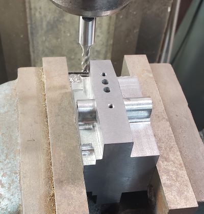

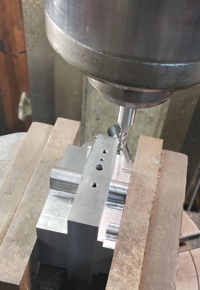

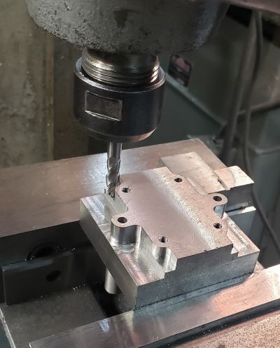

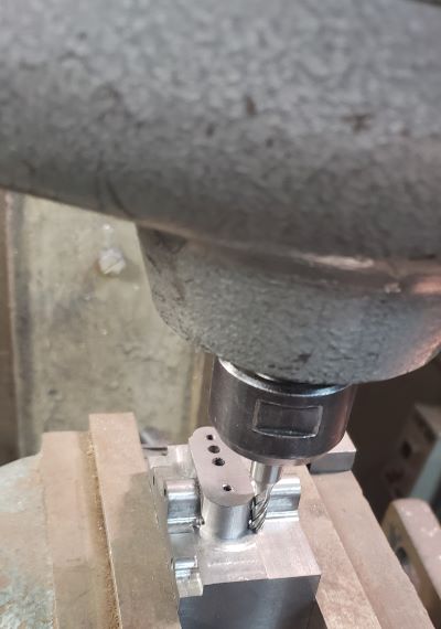

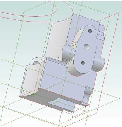

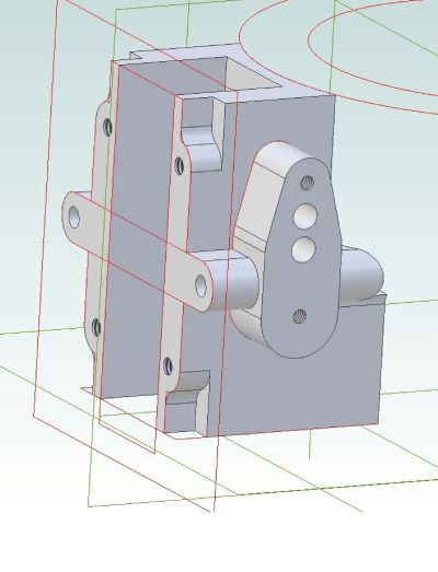

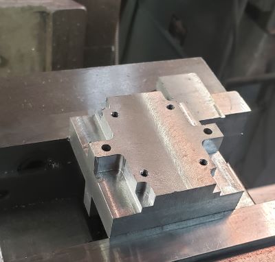

Iíve spent the past week carving on a 2 Ĺ x 2 Ĺ x 1 5/8th inch piece of cast iron; attempting to make it, at least, somewhat resemble the casting on the full size engine.  Just so you can get an idea of what Iím trying to achieve; below is a rendering of the part from my CAD software.
There were lots of steps in machining this chunk of material and I documented most of them so here we goÖ.
First off was sizing the piece to the above mentioned dimensions; then a bit of drilling, tapping, and slotting as you see below:

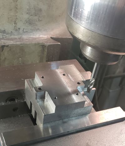

Next I used a ľ inch end mill to form these major recesses in the face of the piece.

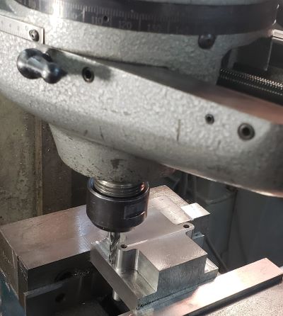

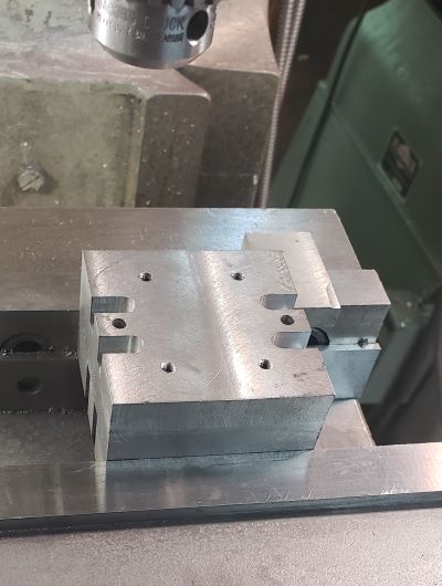

A few more recesses in the face of the piece.  This is all just cosmetic work.

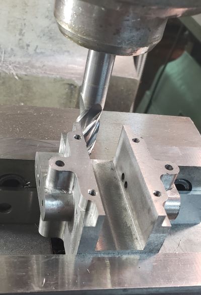

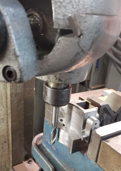

Now I employed my rotary milling head for form some of the curved surfaces on these recesses.
Here I give you one of the few photos I took of working the back of the piece.  Pretty much the same procedure as on the front.

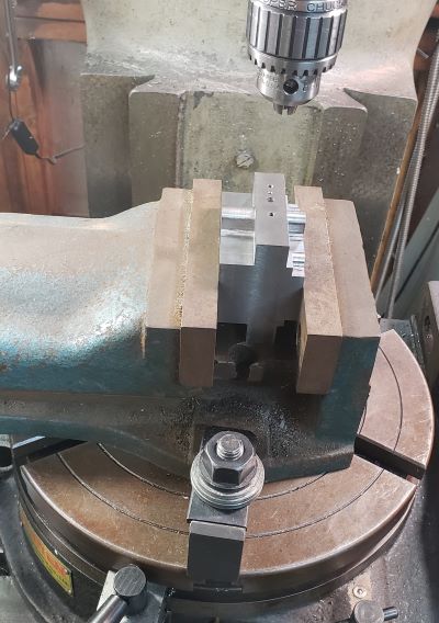

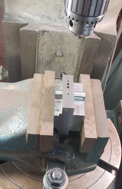

Now Iíve turned the piece on its side and am drilling the exhaust port as well as tapping the mounts for the exhaust flange.  This is a rather peculiar setup- a vice mounted on a turntable.  In the next photo youíll see the purpose.  Iím trying to minimize the setups in working on this part.
The top of this boss has a slight taper.  Here is where the turntable comes into play.
With the boss tapered I need to form the curved surfaces on the top and bottom.  Again Iím using my rotary milling head.
With the exhaust boss finished it was time to do the same on the intake boss- located on the other side of the part.  Here Iíve drilled the gas and air ports, as well as drilled and tapped the flange mounts.
The same procedure as on the exhaust port, Iím adding the taper to the intake boss by rotating the rotary table four and Ĺ degrees.
The rotary milling head completes the milling of the boss.

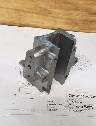

Now it was time to cut away the material to fit the slide valve.  Iíve been waiting to do this till now so that the part would have the rigidity needed to perform the above milling steps.
The last steps were to cut the concave surface at the rear of the part.  I was contemplating using a rotary table for this, thinking it might be a bit much for the rotary milling head; but I went slow and took many, MANY passes and all worked out well.

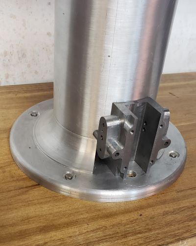

After a bit of clean-up, below is a view of the finished part as well as a mock assembly on the engine frame.
