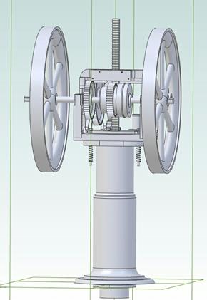

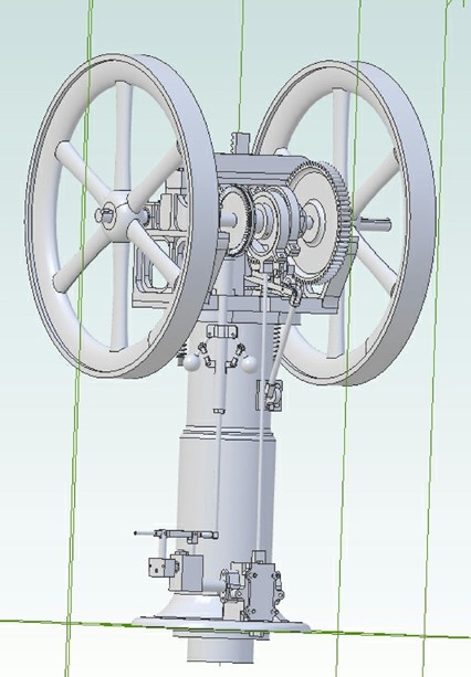

The CAD design has been progressing steadily since early November (it’s taking a while to design this one).  With the cold weather outside I’m in no hurry to finish the design.  I have already procured those items that I’ll need that might be hard to locate at the size I need them; specifically the honed cylinder and the flywheels.

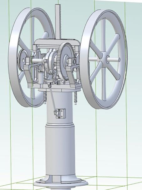

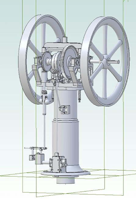

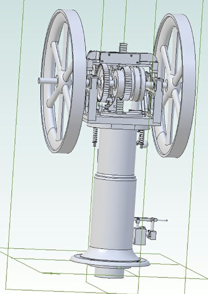

Just so you can see where I’m going with this design I’ll include a few elevation pictures from my Alibre software.  (If I were willing to spring for the Expert version of the software I could give you some keyshots that are supposed to look very ‘real’; but for a modeler, I can’t justify the additional charge).
I still have the governor and slide valve to design/draw but other than that, the design, for the most part, is complete.  I expect construction to start around the first of the year but it may be slow going if the cold weather really sets in.

That is really my first priority now-a-days, so I haven’t been pushing myself to spend long hours at the computer, but I have finished the design since I last posted. :ThumbsUp:
A few things really caught my interest with this model and helped me make the decision to build this particular engine.  One is the “stabilizer bar”, anchored to the column and used as a fulcrum for the pawl release mechanism.  Most of these Otto Langen designs have an extended table where the fulcrum just attaches to the table top.  This design uses this, kind-of, floating fulcrum.  I have photos of several engines that use this feature; they all appear to be Deutz built engines.
I was also attracted to the position of the flyball governor; having it mounted at the rear of the table as opposed to hanging it off the side of the table as is usually done.
This version of engine also has an overcharge compensation system; the two springs that you can see hanging down under the table top.  This is going to get interesting if I over charge this model, and the table starts jumping up off the column.
With the design complete, I’m using my Alibre software to make drawings (prints) of all the component parts so I have something to take out to the shop and start making parts.

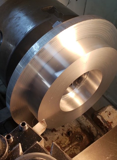

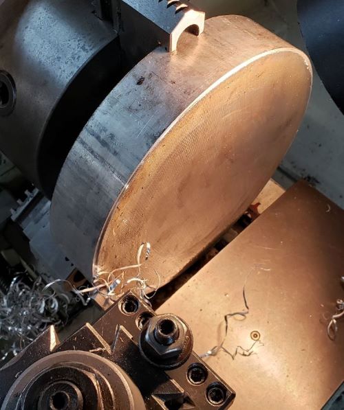

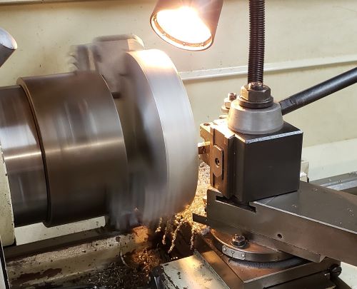

There are any number of sequences where construction could start; I'll start on the bottom of the column and work my way up.  Here you see I've chucked a 7 ½ inch diameter piece of aluminum in the lathe and I'm facing it off.
Once that's was complete, I reversed the piece in the lathe chuck and  faced the other side,  reducing the thickness of this piece to the required 1.4 inch thickness.

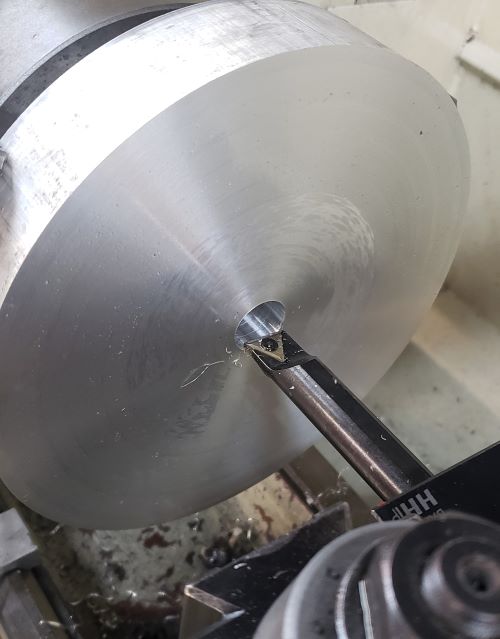

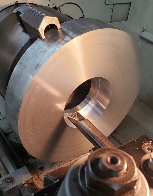

The center needs bored out to receive the bottom of the column with inserted sleeve.  Here I'm just making a hole, making room for my boring bar.
and with some working room, I'm beginning the boring operation.

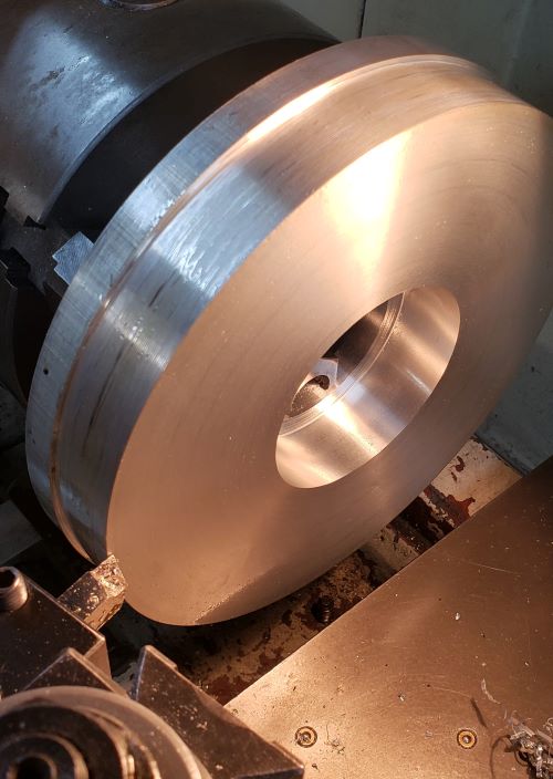

With the thorough hole established I'm making a shoulder on which a flange on the lower column cylinder will rest.
Having finished the shoulder I've moved to forming the outside of the base.  This is just cosmetic work; trying to make this chunk of aluminum resemble a casting.  (I can hear Jo now.... “If you used castings you wouldn't have this work to do”) :old:.  Jo, I agree, but then if I used castings I'd have ornery elephant to deal with :pinkelephant:.... oh wait, that's YOUR problem. :lolb:
In the photo below I've met one of my exterior dimensions.  The next few steps will be more “art” than machine work; attempting to cut some gentle curves into these outside edges in order that they resemble the full size base of the engine.
This seems to be a good stopping place for today; outdoor temperature willing, I'll continue tomorrow.
