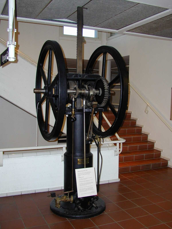

Finally I’ve included a photo that was taken many years ago in Philadelphia, Pennsylvania USA.  This photo is from the Schleicher Brothers engine works who were distributers, here in the states, for the Deutz built Otto & Langen engines.  I include the photo only to give an indication that the Otto & Langen was built in many different versions and sizes.

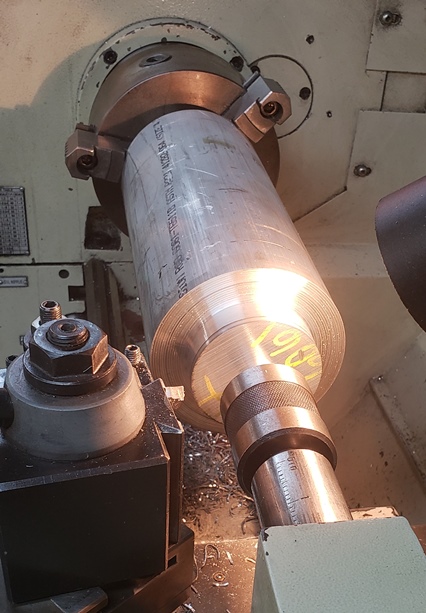

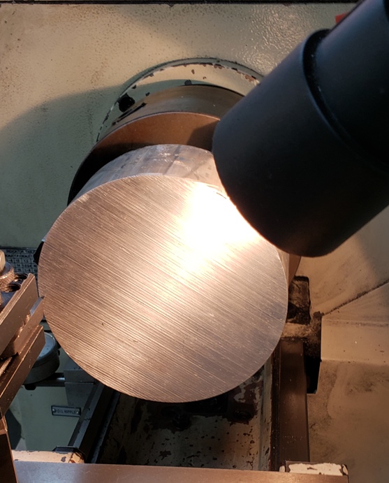

Construction of the model started today.  I’m going to make the base and column and then fit the honed cylinder.
Here I’ve just mounted a 5 ½ inch round piece of aluminum to my lathe to begin the work on the base.
The first order of business is to square things up and then begin forming the base flange.
I’ll finish the flange later.  Here I’m boring the center in preparation for pressing in the cylinder liner.  These large presses are challenging because with such a large diameter the resistance fit can only be one half to one thousandth of an inch.  I thought I’d error on the large side, figuring I could always smear a little JB weld on the joint if it was a sloppy fit, but I managed to hit my measurement of 2.245 inch diameter right on the nose.

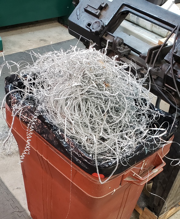

Once again I’m making mountains of aluminum swarf; time to empty the trash bin.

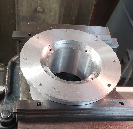

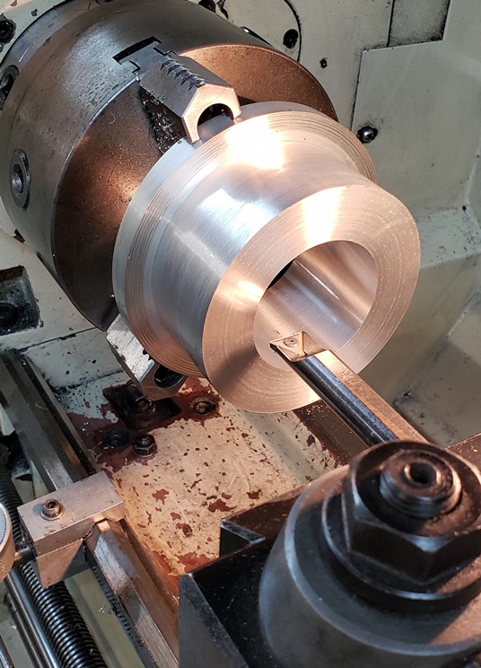

I finished the base today.  Actually I need to drill one more hole, the passageway into the cylinder; but I need to install the cylinder liner before I can do that.

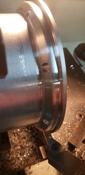

In this photo I’ve turned the work piece around in the lathe and am boring out a recess in which the cylinder “head” (a flat piece of aluminum) will mount.
Now I have the piece on the mill and am drilling the various required holes.
I wanted to drill the mounting holes before I formed the bottom flange of this part.  Drilling them first made the drilling part a lot easier than having to drill the recesses on an angles surface.  Here I’m forming the flange, used to mount the engine to its working surface.
Now, back on the mill to cut out and drill the recess for the valve assembly.

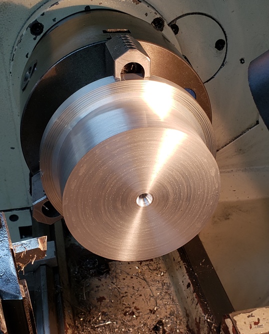

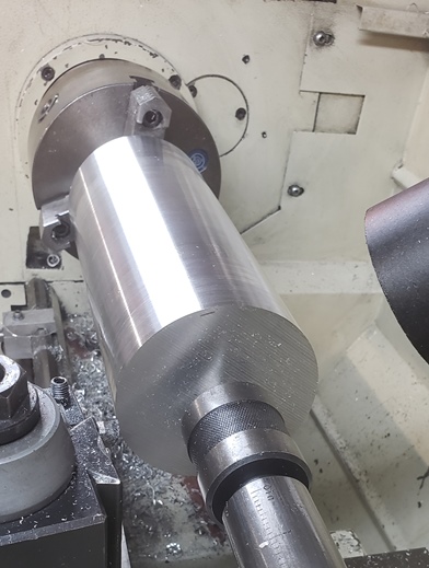

I began work on the column today.  I must admit that the thought of chucking this 5 ½ inch diameter 11 inch long chunk of aluminum in the lathe gave me a moment of anxiety.  The perilous moment passed quickly, once I had a center established.  The center drill, once it dug-in, pretty much stabilized the piece at the tailstock end of the lathe.
Too bad I couldn’t find a piece of aluminum that was already cored through the center; it would have made this job a bit easier.  I’m going to need to bore away a lot of material.  The bore goes completely through the eleven inch length, so I thought using my steady rest might be a good idea.  Not so much to keep the piece “true” but to eliminate a catastrophe, where the boring bar would pull the piece off center enough to pull it out of the chuck.  My steady rest isn’t large enough to accommodate the diameter I need.  Fortunately I bought this piece an inch too long, so I can turn down a relief on the tailstock end small enough to ride in the steady rest.  Once I get the piece bored I can cut off this relief.
Here I’m forming said relief.
With the steady rest in place I’m drilling out the center large enough to accommodate my boring bar.
Here I’ve turned the piece around and am just doing some surfacing work, trying to get this piece of aluminum round and true to the centers I’ve established on both ends.
Tomorrow I’ll begin boring out the center.  I’ll be removing a lot of material with the finished diameter of the bore being nearly 2 ½ inches in diameter.

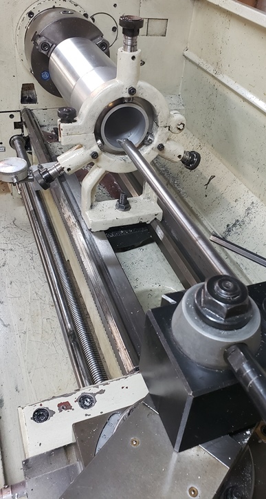

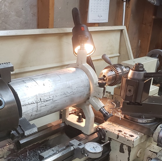

I’ll tell you; boring  a 2 ½ inch hole through all nine inches of this aluminum cylinder was more fun than I’ve had in years (and if you believe that for a second, I have some swamp land in Florida that I’ll sell you for a condominium project.)
Not much to say about it, other than it took a while and I’m not eager to do it again soon.  Fortunately, the diameter of the bore wasn’t critical; I just needed a hole for the sleeve to pass through.  I needed to bore from both sides or I would have needed to upgrade my set of boring bars for increased rigidity.  I also needed to make a holding fixture to support the cylinder out on the lathe tailstock end (to hold the cylinder with the steady rest).
Just a few photos from the process.
I’m not finished with this cylinder yet.  I still need to form the external taper down the nine inch length (a taper attachment on the lathe would be ideal for this, and Grizzly does make one for my lathe; but I’m thinking it’s an expense I just don’t need to make).

That's a mighty long and thin boring bar. How did you control tool chatter? What sort of feeds and speeds did you use. Did you have to change these as the centre hole gets bigger to stay on that 'sweet spot'.
