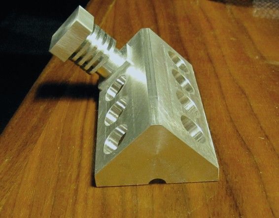

Got some more done on the engine today. I started roughing out the top part of the crankcase.
Here is a picture of the block I'm using. It's magnesium and was cut from a 1" thick piece that I've had laying around for a long time. The overall dimensions of the block is 3" x 1.7" x 1" thick.
Here is the block mounted in my milling vise read to surface one of the sloping sides. I'm using a 1.25" indexable face mill to form the 45 deg angled faces.
This is the block with one of the angled faces finished. This magnesium machines really nicely. I was able to mill away .100" on each pass.
And here is the piece with both angled faces milled, along with crankshaft for size comparison.
I was careful to vacuum up all the magnesium swarf after I finished. It's not likely to catch fire since the kindling point is around 700 degrees, but didn't want to take any chances...
The next step will likely be to hog out the underneath side of the crankcase. Not entirely sure how I will do that, probably with an end mill.
Chuck
« Last Edit: August 23, 2013, 09:41:36 AM by arnoldb »

This is iteration #2 of my crankcase, top half. The first one would probably have worked, but I missed a lot of the dimensions, by a lot, so couldn't in good conscience continue with it.
With this iteration, I've mounted the crankcase half in my dividing head. I will use the rotating motion and lower the end mill a bit at a time to achieve a semicircular, concave cutout in the metal. I think this will give me a lot more consistent result. The metal cuts really nicely so I don't think the long overhang will be a problem. I plan to go slow. Could really use a CNC mill at this point, but this will have to do.
I may shoot a video of part of the process to show how it works. This is work for tomorrow.
Chuck
« Last Edit: August 23, 2013, 09:41:53 AM by arnoldb »
Offline cfellows
  • Posts: 1700
Re: Compressed Air V8 Engine
« Reply #10 on: July 19, 2012, 11:10:38 PM »
I got the crankcase top, 2nd version pretty well finished today and I'm quite happy with the process and the results. I'll be uploading a video showing how I used my dividing head to position the work for hollowing out the inside.
I'm hoping these will have been the most difficult pieces and having them out of the way should make the rest of the project go pretty smoothly (famous last words!).
Chuck

ere's a pile of cylinders in the rough...
And here's the first prototype.
I decided to make the head integral with the cylinder. Simpler and easier to make. Sigh, 7 more to go!
Chuck
