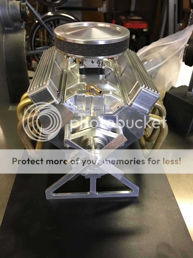

I have a buddy that I have known for over 40 years who seems to know more about the chevy's from the 50's and 60's than anyone I have ever met. I decided to try my hand at making a miniature 60's style high performance air cleaner and give it to him as a present. I just finished it this morning. The top is a 1/4 scale version of the open element type used on engines like the 302 Z28 and the 396-375 H.P.

That is awesome!  I hope he appreciated it.

Beautiful Gary. I am sure he will appreciate that immensely.

That's really beautiful Gary, your lucky mate will certainly grin ear to ear when he unwraps that little gem!  Dave

Gary, very nice. Could I ask how you made the filter element?

2nd. John, I thought on this for quite a while and finally went this way. The top and bottom plates are threaded onto a center aluminum ring. A Teflon ring is a light press fit over the aluminum one. I found the .010 thick aluminum mesh at Hobby Lobby and it was cut about .125 taller than the Teflon ring and extends into grooves cut into the top and bottom plates. The orangish rubber cord was got from McMaster-Carr and is pressed into the grooves which holds the mesh tight against the Teflon. It all seemed to work out pretty well. If the wing nut is removed the whole thing comes off as a one piece unit.
