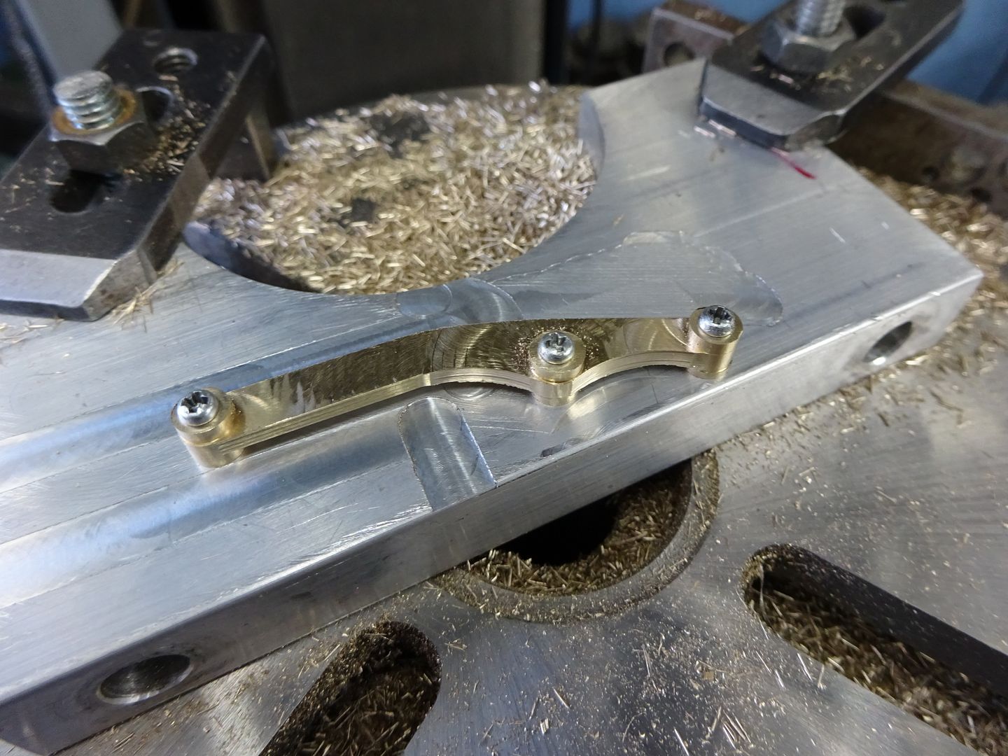

2)  Assuming you have some ability with math and are patient, you can do the dividing by computing the angular interval and dialing that in on the RT.  One of the programs on my page does all the work for you.  Given the built-in error reduction of the RT, you can make your own plates when needed.
3)  A TS can be handy but it's easy to fabricate your own.
I can't remember ever mounting a chuck to my RT.  Dividing jobs on parts with circular symmetry are handled via my homemade collet dividing chuck...
http://www.modelenginemaker.com/index.php/topic,386.msg2613.html#msg2613
Actual circular milling jobs are handled by clamping the part to the sacrificial plate I mounted on the RT the day I bought it.  Said plate is about 1.5 times the diameter of the RT table and provides outboard space for clamps.  It should be the first addition to any table, especially a smaller one.
