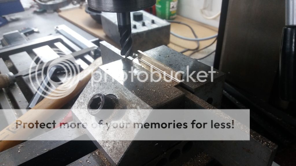

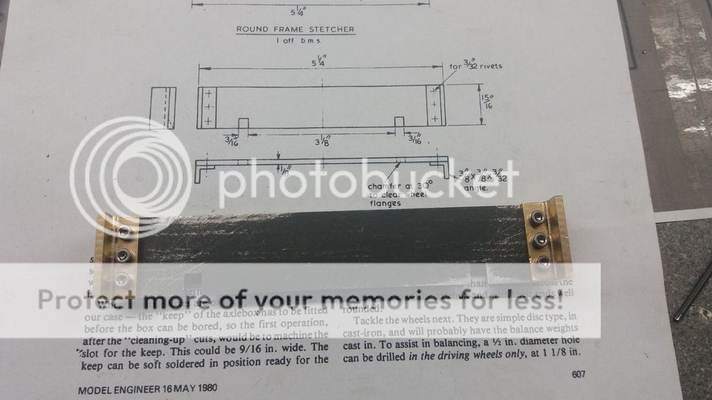

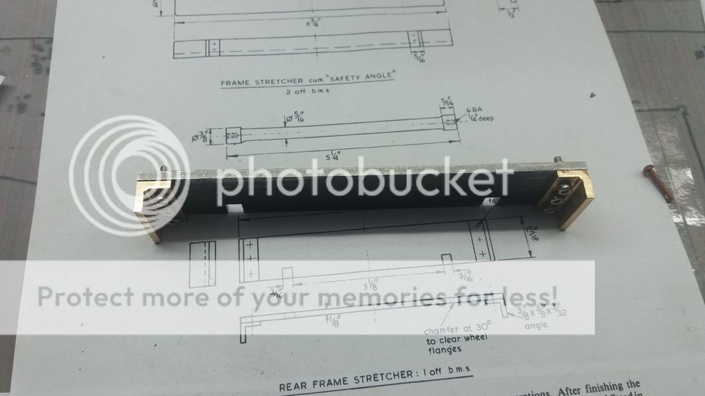

Made a couple of bits that don't require a lot of explanation.
A round frame stretcher
A straight forward turning job. The plans specify bright mild steel and BA threads. I have used a bit of stainless steel because it was the only bit of 3/8" I had and tapped 4mm.
The other strethcher similarly I have used slightly differnt materials to those specified but I can't see a problem. Specified is 1/8" steel plate but I have used 3mm, only .008" thinner and I had to make a bit of angle by machining down a bit of brass angle. At the moment it is all held together with 2.5mm stainless steel cap heads instead of rivets. If they don't get in the way I'll leave them in.
Rich
