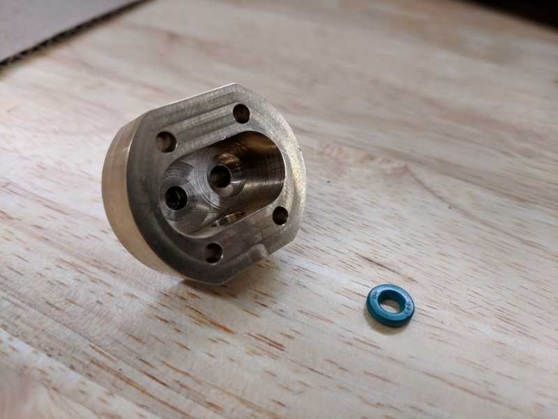

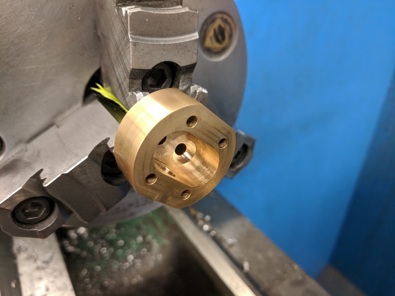

First order of business was to modify the pump housing to accept a lip seal, as suggested by Jeff above.
Before and after installation of the lip seal:

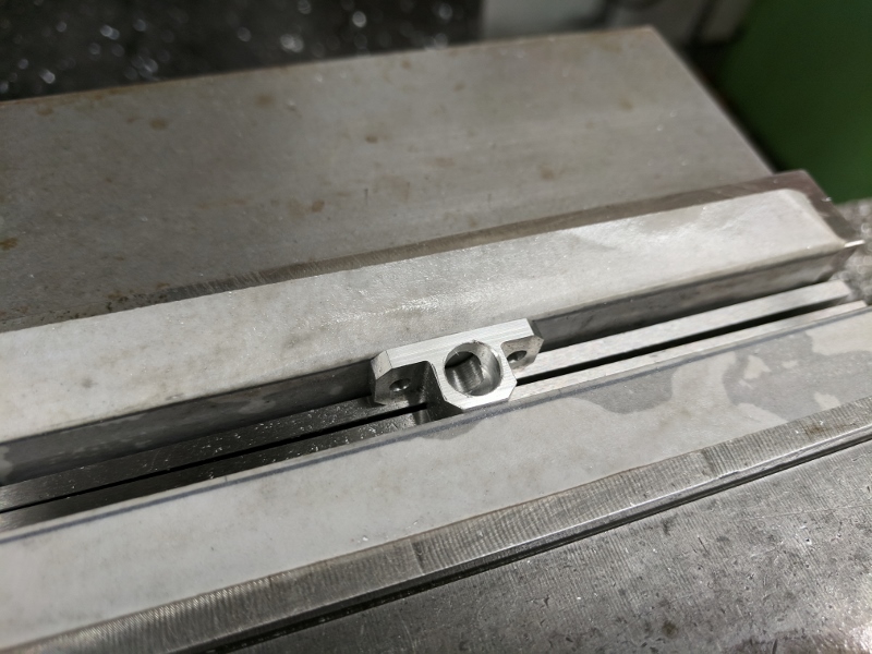

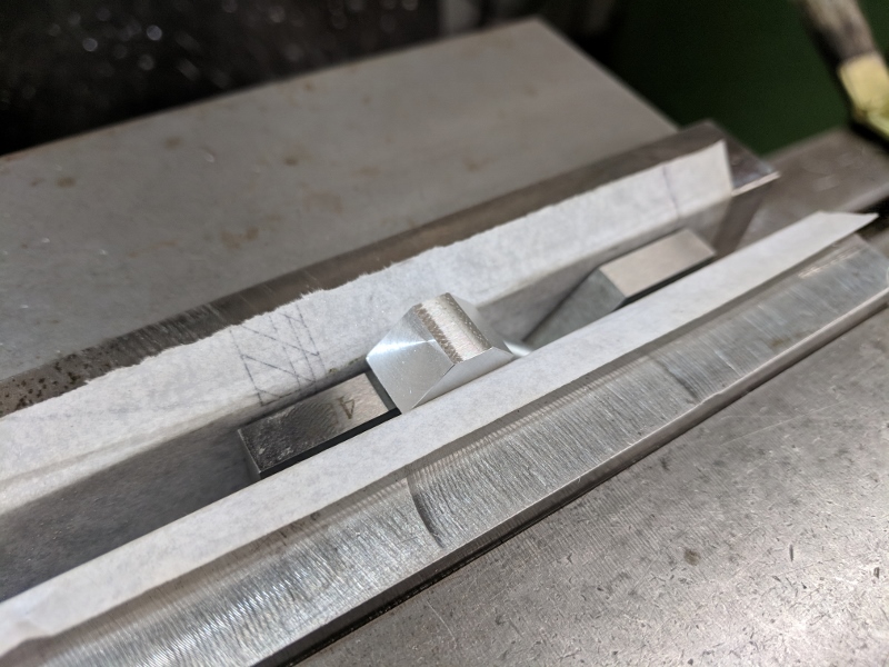

Next, I made the plumbing to connect the pump output to the cylinder block passage.

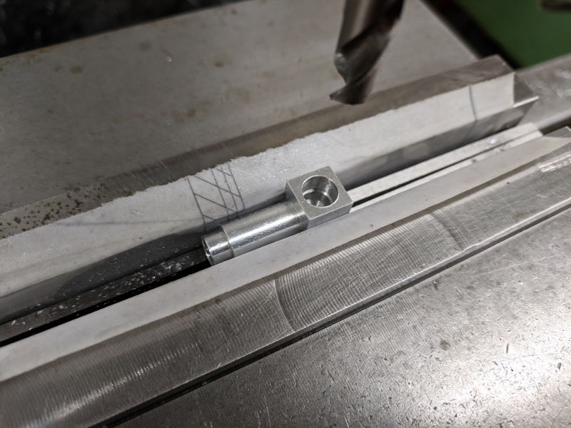

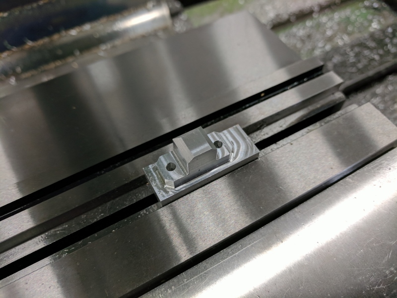

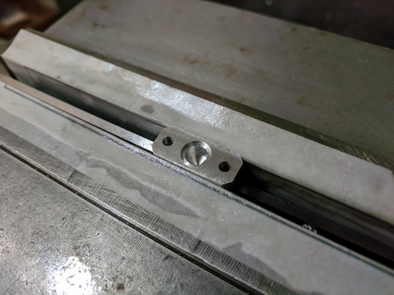

Milling the fitting to the cylinder block:

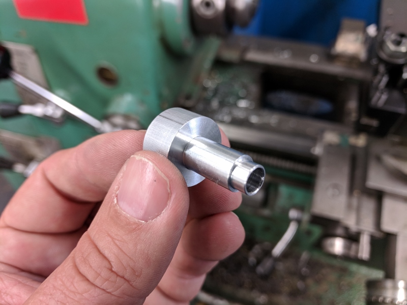

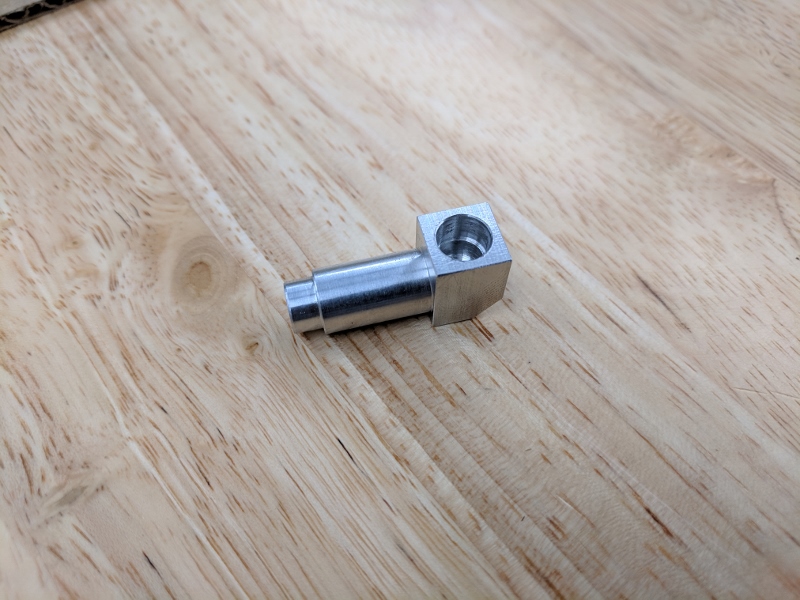

The original plan was to bend tubing from the pump to the inlet fitting, but that was an utter failure due to the small radius in my design. As solution, I made an elbow to be able to make the corner around the cylinder block.
The finished elbow
The plumbing installed on the engine:

Yogi,
In looking at your photo of the water pump housing with the seal installed, you have the seal in backwards. The lips should be on the liquid side. Maybe you already knew this. I thought I would mention it just in case.
Jeff

Jeff, Oh boy, I sure wasn't paying attention. Thanks for pointing it out.
