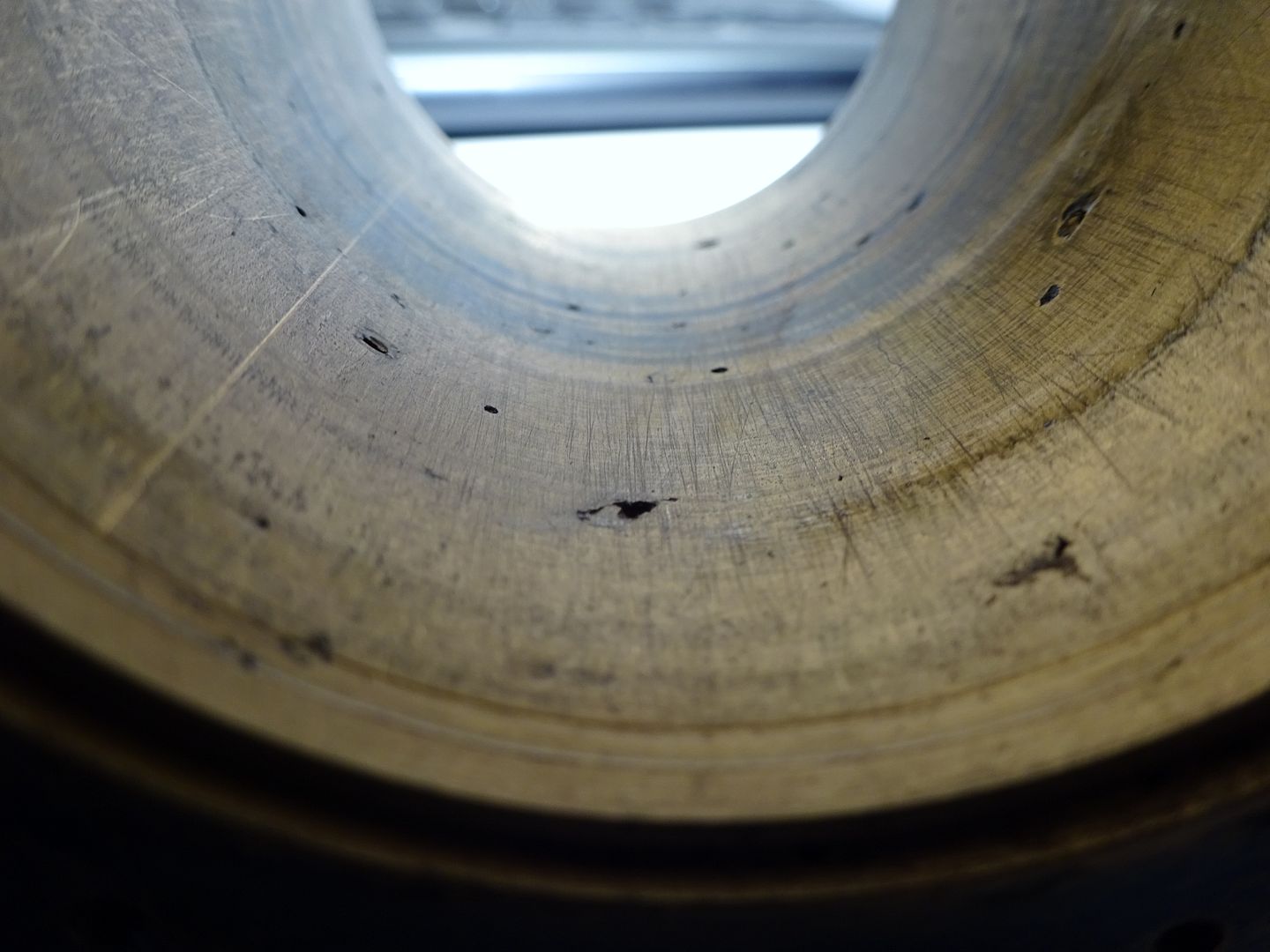

Fault No 1 Voids
This bronze / gun metal casting looked qiute innocent from the outside, so into teh lathe it went to have the main flat surface machines and a couple of small holes started to appear, nothing critical.
I then had to mill a slot on the opposite side which revealed more holes than a bit of swiss cheese.
I don't think these were sand inclusions as they were within the casting and ther was no sand in teh holes (we will come to that case later)

You're quite right that's not sand inclusion but looking at the very rough/ragged cavities I would say that insufficient " Head " on the sprue caused internal shrinkage, or a " cold shut/lock " during the pour.
This causes the casting, as it's cooling to feed itself rather than be fed from the runner. A simple remedy is to place a " Nob " ( cone shaped ) feeder near to the casting. This, because it's in the sand mould has a nice hot reservoir of metal to feed after the pour.
This is different to gas pockets, they are usually spherical and smooth to look at.

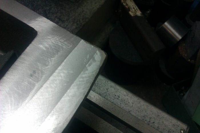

Chilled or hard castings
These little surprises usually hid just under the surface of iron castings and tend to hide in corners or extremities. You usually don't know they are there until your HSS cutter suddenly goes blunt so always worth rubbing an old file over these hoding places or going straight in with carbide tooling.
Once you gave found the chilled matal it will show up as a shiny surface compared to the usual matt iron such as these.
With luck the casting will have enough machining allowance for the hard material to be removed but sometimes particularly if a hole needs to be drilled or tapped near the chill then you can get into problems as the HSS drill bit or tap won't cut it, this fuel tank filler is a good example, machined flat OK with carbide but the dark areas are still all hard.
Heat and a slow cool will often do the trick.
The annealed metal can then be worked.
