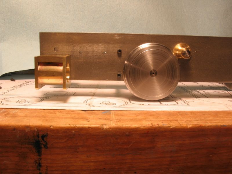

The wheel bearing changed from straight circular bushings to something more complex.
First a simple quartering jig I used a couple of quick squares, and set the wheels with loctite.
I wanted to be able to take the wheels out of the bearing for future maintenance and it is better practice to be more prototypical in my view.
The slotted bearings worked better.

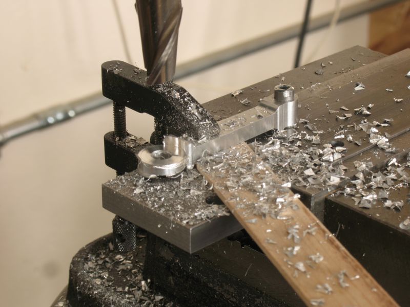

Next up was to machine up the connecting rods, a good friend who drives a 7.5 inch steam loco suggested using aluminum for the rods so I followed his advice. and set up a simple jig to do the milling.

Back to Dickie and the rods, I used the rotary table to finish off the ends.

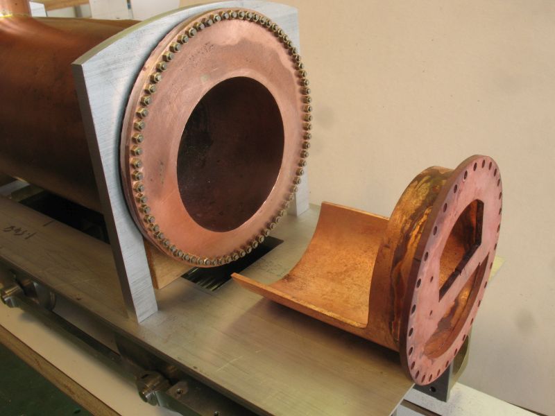

Today I had a one of those moments that makes the pit of your stomach knot up tight. while filing some 1/4 inch thick aluminum that is going to be used for the outside shell the boiler rolled off the loco and  hit the floor.
It all began after spending two hours cutting out the plates with a jewelers saw, no I did not break any blades.
these plates are meant to fit over this boiler like this first one
the second plat was just a little tight so I set it up in the vice and filed the inside a little at a time and kept testing it to be a nice slide fit over the boiler, then it happened!
both ends were damaged
I felt gutted.  the firebox end was the worst because both the outer and inner tubes were deformed. After taking it apart I turned up some Thornton bearing stock that I just happened to have into a shallow cone in order to tap it into the small tube to see if I could reform it without too much trouble.
After a few goes the tapered plug managed to reshape the bore the flange flattened out pretty easily the squashed holes on the perimeter were a different challenge.
I ground down a scriber to work the alignment little by little and managed to get the bolts back through the holes.
That is about it for today.
