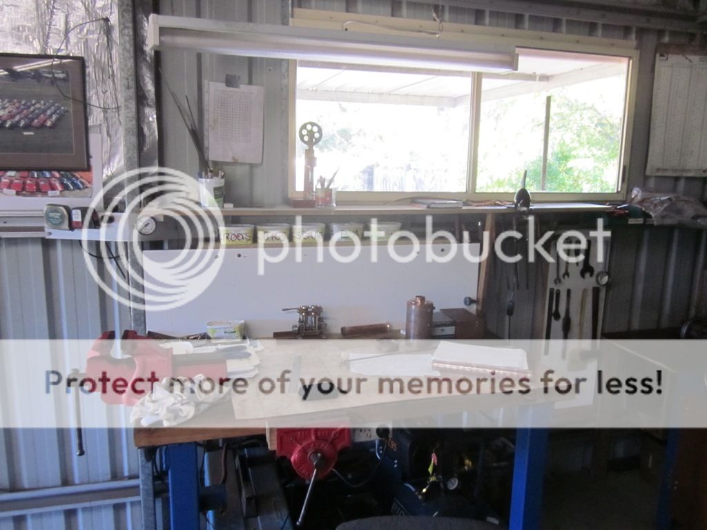

I thought about putting my mill in a corner but it would prevent me from working on the end of long material so it's going to go on the long side of my workshop. I also like natural light and planned to have two windows on the long side of my workshop 1000 x 700mm but the standard size for the cabin I've ordered is 1290 x 1000mm so they'll have to do. This was the view from the old workshop.
The windows in the new cabin are double glazed units but I'll be fitting some cheap blinds to help control the light/heat in summer.

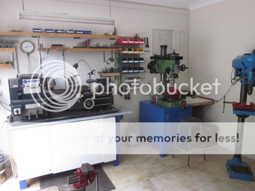

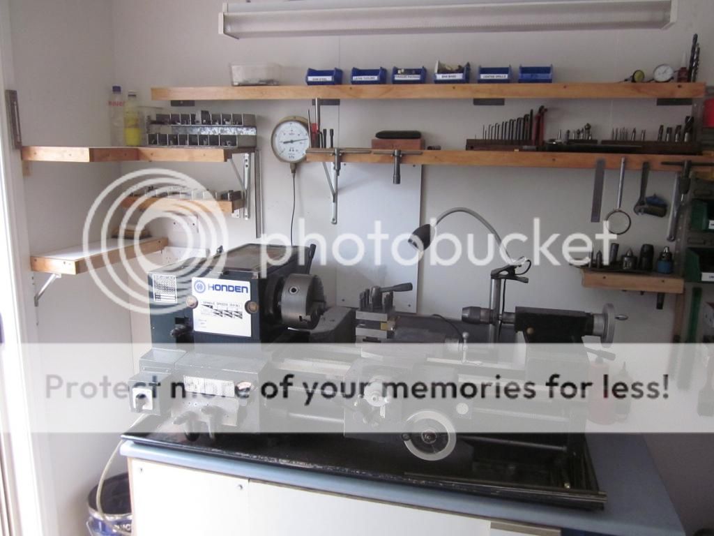

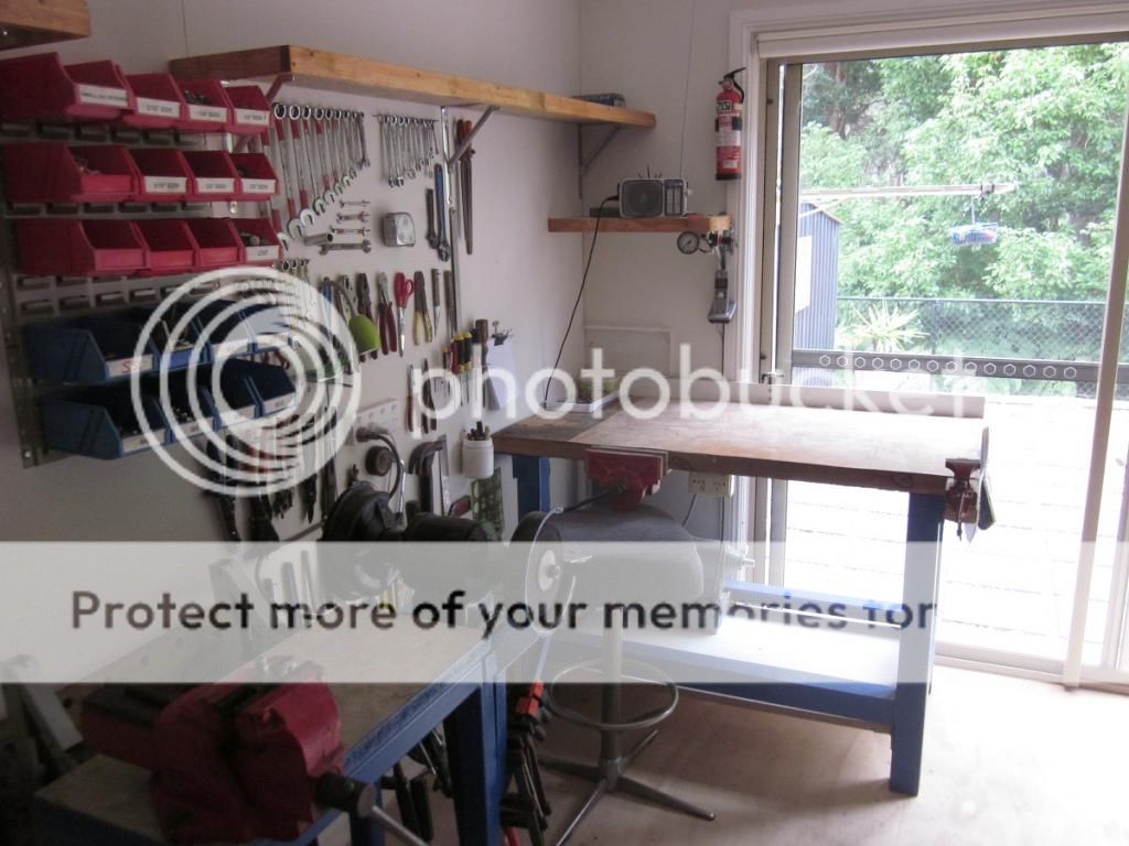

Hi Robert,  we moved house a few years ago and I had a new shop to move in to.  I choose an arrangement which I really like but I dont think I have seen anyone do quite the same.
My shop is about the same width as yours but a little longer.  I chose to not have any windows and instead put in skylights over the centre of the shop.
I had a bench made, cast in concrete, which is in the middle of the shop and on it is my 12x36 lathe, a drill press,  small shaper, cold cut saw and my mill stands at the end.   The machines are on the bench with their backs to the back of the lathe which saves a lot of floor space as anything I need to do at the back of one I can do by reaching through from the other side of the bench.
There is one workbench with artificial light over it and a large tool board above it.  All the available wall space is taken up by cabinets etc

Robert, I am a bit shy of shelves above my machines.  I know it might be handy to have things within reach but I have visions of stuff falling off the shelf and causing an accident when they drop onto a machine that is running.  I suppose there is only a very slight risk if the walls are brick or concrete and wont vibrate at all.  I also like to be able to access the back of the machines to change belts and make adjustments but most of all to run the broom/brush/vacuum through there once in a while.  There is a danger too in reaching over a machine that is running, which I am sure you would never do!
There is really not much space at all between my lathe and the cabinet which is behind me when standing at the lathe,  but I do have to be careful that all drawers are closed when doing something messy like sloshing coolant around or cutting cast iron!
The steel office furniture very good and I can really load the drawers without having things sagging etc.
