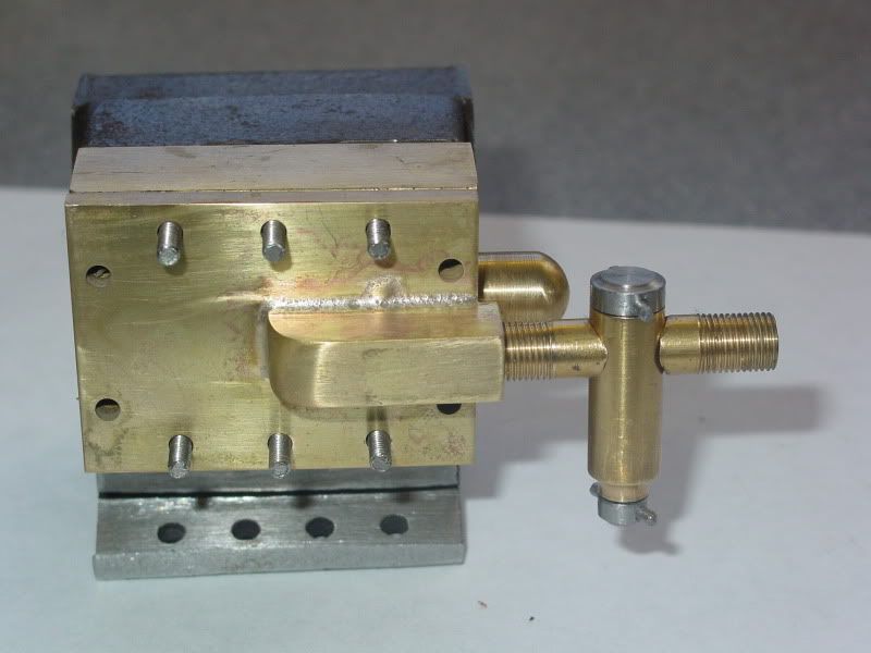

The cylinder block is being fabricated from a car brake cylinder with a .7" bore. It machines beautifully. A block of steel and a curved section of steel are screwed onto a machined flat with 3 4mm stainless steel countersunk socket head screws
The valve chest is machined from a piece of 1/2" brass bar.
The valve chest cover is made from 1/8" brass and has a steam inlet silver soldered on. I have made a displacement lubricator which screws straight into the steam inlet in the valve chest cover.

I thought a few photos of the cylinder construction might be useful.
Its a car rear brake cylinder of cast iron with a very good 0.7" bore.
First job is to cut off the unwanted bit
Hold in the 4 jaw and machine the slide valve face
Make up a mandrel that is a good close fit in the bore. Drill and tap 6mm. Part off a bit from the end to make a thick washer then turna shoulder on the mandrel for an O ring to sit on.
Tightening the bolt expands the O ring and grips the cylinder.
Face the two ends
There are 4 unwanted holes, 2 bolt fixing holes and the bleed nipple and brake pipe holes. Drill out and press in some steel.
Re mount in the 4 jaw and face again
Flycut a face on one side
Prepare a bit of 1/2" steel
Hold in the mill vise and cut a radius with a boring bar
I had a bit of steel tube which I machined to match the radius of the boiler. Drill the stud holes on a radius and 3 cntral holes
Cut the piece out of the steel tube and silver solder to the steel block and clean up.
Drill the 3 central holes through the steel block and countersink. Drill and tap 3 corresponding holes in the cylinder and screw it together with stainless steel countersunk cap heads
It fits.
I will use some more from the steel tube to make axle mounts and the like.
