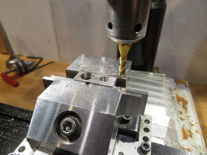

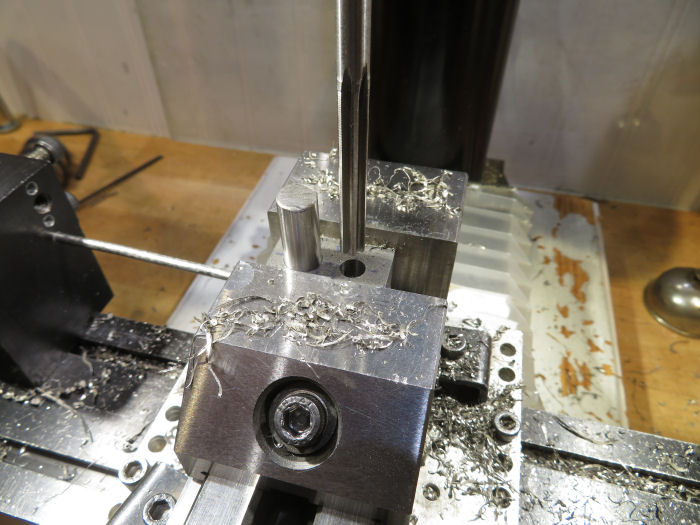

The element was then moved to the vice for drilling the inlet port and milling the locating flat before moving back to the lathe to turn the locating step. It may have been better to turn the step first  :headscratch: but the finished surface was below the interrupted cut. The element was then heated to middle red and dunked into cold water. The file test suggests that the surface is hardened, I have no idea about the bore  ::) Interestingly I can't even get the 1.95mm pin gauge to enter  :thinking: maybe it's scale or maybe it's some form of growth/distortion???

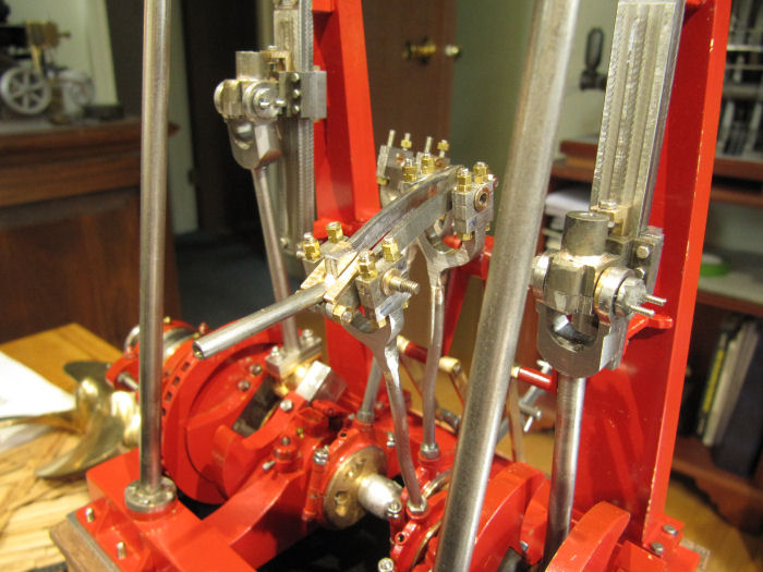

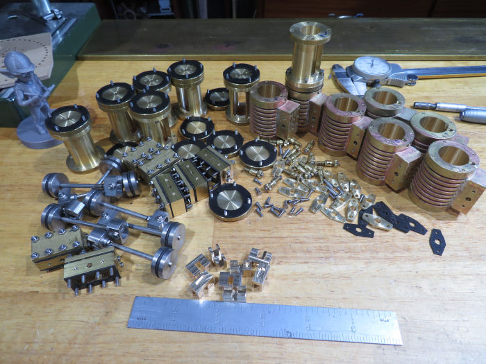

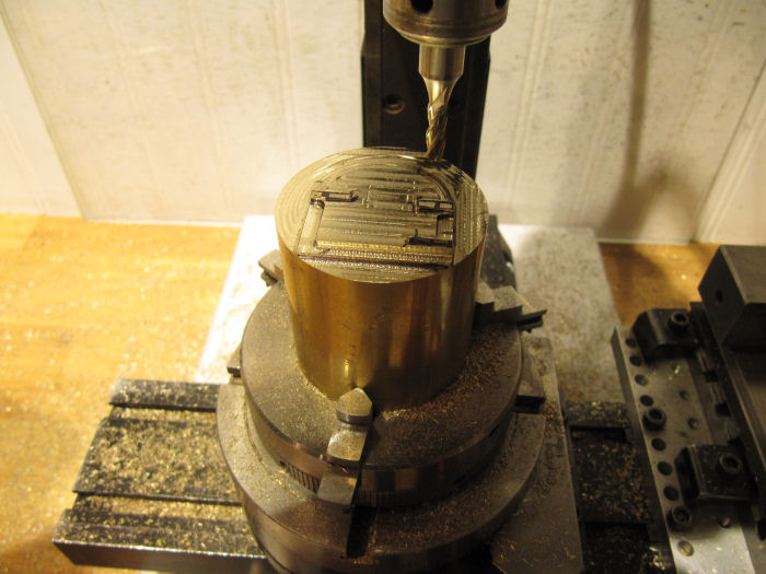

The radiators with their cyl. liners make the premier upon the deck of SIDE SHAFTER. Three 4-40 screws run up through the deck into the radiators and the liners protrude from the underside.  The bottom of the radiators are over bored for a gap between the liners, filled with epoxy to lock in the liners.
The crank webs get dressed with their Traxxas drive members. This part number fits on 1-3/4in. rounds, the webs are 12L14 steel.
And the webs are balanced to the piston/rod assemblies. A counterweight needed to be added to the backside to complete the primary balance. The 6-32 screws need blue thread locker.
The stub shafts are knurled and pressed into the webs....... and the assembly is complete.

As mentioned in the diesel thread the helix pump had worn to a level that it would not prime. Wear problems in the mild steel body had always been at the back of my mind and I had started a new pump design using a round element made from silver steel in an aluminium body. This would also allow multi element pumps for future developments. I have some concerns about distortion when hardening as I just have a 'Camping Gaz' blowtorch for heating but we will see what happens.
The pump element is generally made as before but has a couple of O rings to seal the inlet side to the pump body and a locating flat to ensure that the inlet port will line up with the one in the body. I was in two minds as to cut the locating step and then the flat or cut the flat and then the step which left more to hold the element with until the final operation.
After reaming the 1.96mm pin gauge would pass through but the 1.97 would barely enter, much as before.
