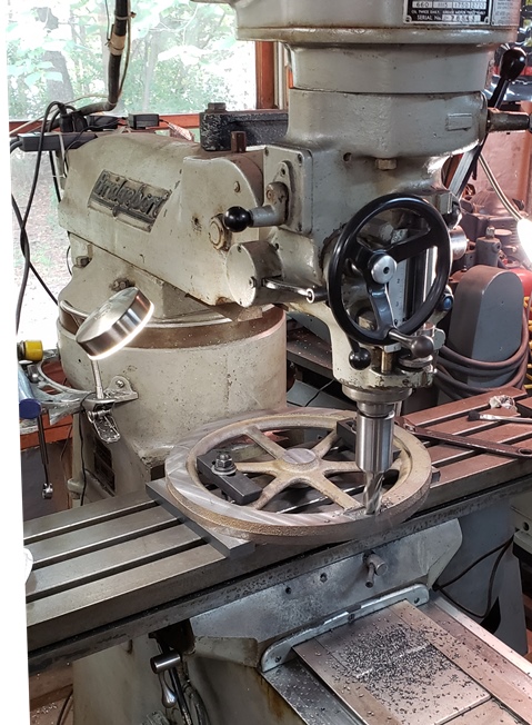

I’ve been putting off the machining of the flywheel but at this point I really need it to continue.  I’d purchased a flywheel that would finish out to a 15 inch diameter from Martin Models back before I started the build.  There is no use building at a scale for which a flywheel can’t be found.
I was absolutely appalled when this flywheel was delivered.  It was/is massive.  These Otto Langen engines are characterized by large diameter flywheels with thin rims.  To get the inside diameter of the rim to the required size I needed to purchase a flywheel of this size.  I reduced the outside diameter from over 15 inches down to the 13 ˝ inches I needed and the thickness from 1 ˝ inches down to 1 1/8th inches.
My 12 inch lathe has a removable “gap” that will increase the turning diameter to 17 inches.  I’ve had the lathe for about ten years and I’ve never had the gap out but I was planning on removing it to turn this flywheel.  I was appalled when I couldn’t remove any one of the four socket head cap screws that hold the gap in place.  Even with a pipe on the allen wrench to give me more leverage, none of the cap screws would budge.
Plan “B” was to turn the flywheel on my turntable as you can see in the photo below.
oooops... ok, you don't see the turntable, but you probably get the idea.  It was quite the slog.
I also needed to make the stand for the engine, because with this massive flywheel hanging off one side, the column would just fall over.
I was concerned about perspective because the spokes on this flywheel are considerably larger in cross section than an Otto Langen flywheel should be, and I was concerned that the flywheel wouldn’t look right mounted on the engine.  The jury is still out on this, but for now I’m going to let things be.  If I start cutting down the spokes, I’m letting myself in for hours and hours of filing to get them round and blended into the rim and hub.

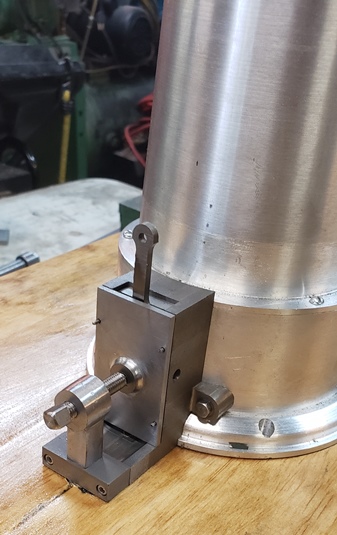

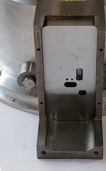

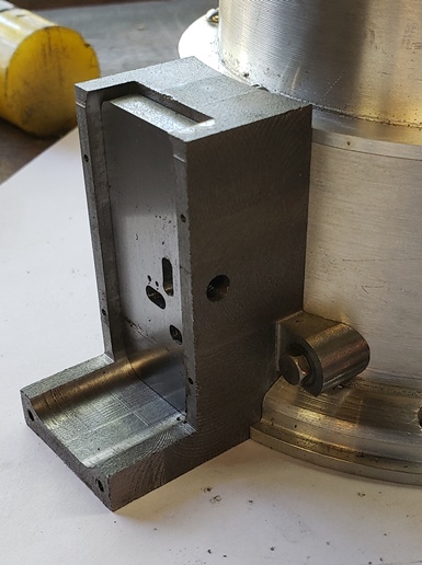

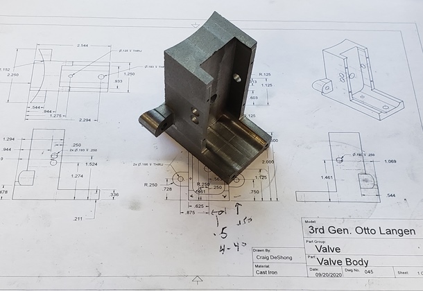

Back to the Otto Langen.  I’ve started work on the valve.  Here is a photo of the completed valve body.

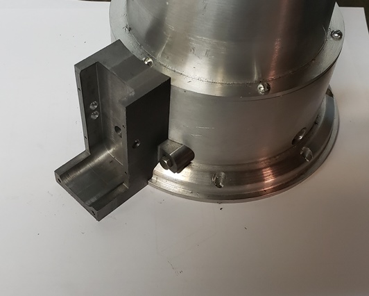

And here is a photo of it installed on the column.

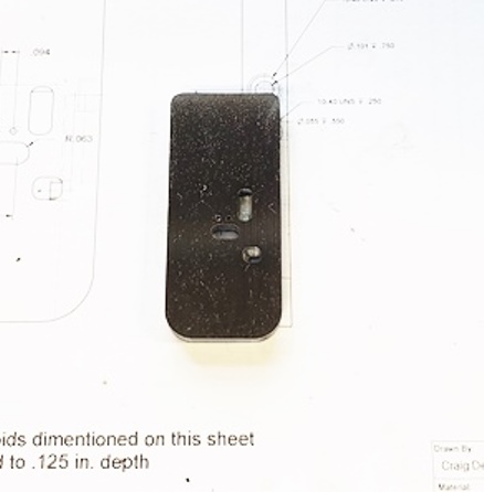

Thanks for stopping by.  I spent the majority of then day in the shop and work progressed on the valve.  I finished the backplate and the slide; parts which I’ll show below.
The backplate is a part that you won’t find on the full size Otto Langen.  It is integrated into the valve frame.  I make it a separate part because it needs a smooth finish on which the slide valve moves and by making it a separate part I can use my surfacing machine to achieve a mirror, flat finish.  I show the finished backplate below.
And here I show it installed in the valve body.

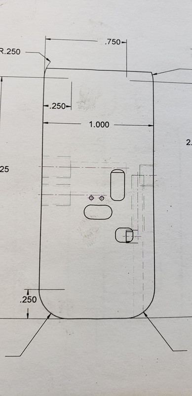

I thought I might show how the valve is ported.  My valve lacks the complexity of the fullsize, since on the fullsize, the valve must also transport a carrier flame that is re-lit outside the valve body with each cycle, and then carry that flame to the combustion chamber to fire the engine.
This photo shows my drawing for the backplate.
The backplate has two threaded holes drilled into the left side to accept threaded tubing. .  The lower hole is continued at a smaller diameter and meets the two small holes in the backplate face.  These holes are .025 diameter and emit fuel (acetylene) into the valve.  The upper hole is continued at a smaller diameter where it intersects the vertical oblong void cut into the face of the valve.  This orifice emits air into the valve.
The oblong void below the two fuel holes is the passageway into the cylinder.  It is the only hole that passes completely through the backplate.
To complete the description, the lower, right oblong hole is the exhaust passage.  It allows the exhaust gasses to escape through some porting drilled into the backplate.  The exhaust finally finds it’s way out of the backplate through a threaded hole on the right side of the backplate.  The porting passageways are plugged with set screws at the bottom and lower right.

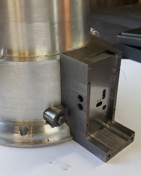

Below is a photo of the left side of the valve body.  Shown are the two holes which allow threaded tubing to attach to threaded holes in the left side of the backplate. The bottom hole is for fuel (acetylene) while the top hole is for air as mentioned previously.
This photo shows the right side of the valve.  Shown is the hole which allows threaded tubing to attach to the threaded hole on the right side of the backplate.  This is the exhaust side.

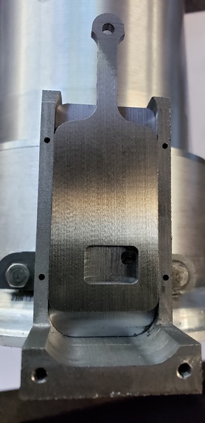

Below is a photo of the slide valve.  We need to remember that when these Otto Langen engines were built, steam was still “king” and some of the design criteria of steam engines was borrowed.  This slide valve is typical “steam engine”.
Now I’ll give you a trio of photos with the slide valve in place.  A cover fits over the slide valve to seal the front side, the slide valve being sandwiched between this front cover and the backplate.
In this photo, the slide valve is shown in the “at rest” position.  This is it’s position at the end of a power cycle.  In this position the exhaust passageway is connected to the port that passes into the cylinder, thus allowing the exhaust gasses to be removed from the cylinder.
Now I show the slide valve cycled to the “up” position.  Here the fuel and air passages are connected to the passageway into the cylinder.  With the piston being lifted, fuel and air is drawn into the cylinder.
Next the valve is quickly cycled through the middle position (as shows two photos up) and moves to the “down” position.  Though the side valve still exposes the exhaust passageway, the port into the cylinder is closed.  In this position the engine fires.
The valve slide is then returned to the middle position where the cycle can repeat.

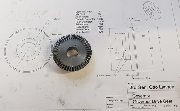

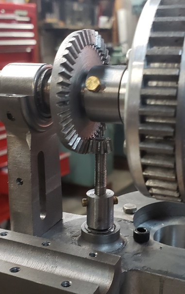

I spend the entire afternoon making this bevel gear to drive the governor.  It’s a 45 tooth gear and if you know the drill you need to make three passes around the gear blank, so it takes a while.
While I’m in a “gear making mood” I’ll probably make the governor driven gear tomorrow if all goes well.

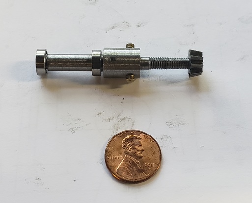

Dave; thanks for stopping by and commenting.  Thanks also for those of you who are silently following along (I guess you’re following along and not just opening this thread in error). :o

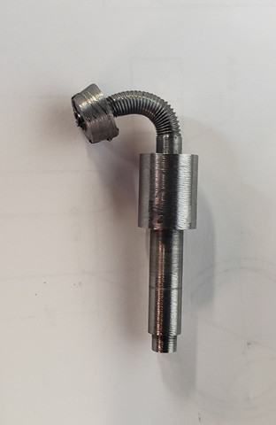

So, as a reward for stopping by; you get to see another original Craig “foul-up”. :facepalm:  If I can’t laugh at these when they happen, then I’m going to be in a semi-constant state of unhappiness.
“Craig”, I said; “That shaft is over 5/32 inch in diameter… certainly its rigid enough to support the gear blank while I cut the gear teeth”. :disagree:
“Whooooopsie… Then again, maybe not”. :toilet_claw:

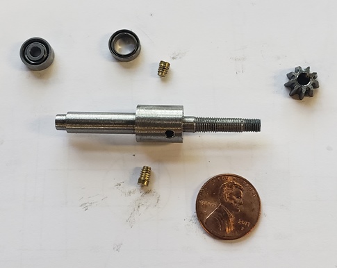

Now, wiser and with more experience here are the governor parts after “attempt 2”.
I’m using ball bearings on this governor as I did on the Crossley model.  I want minimal resistance to the higher speed step-up on the governor shaft.  Here are the governor parts assembled….
It’s always nice to assemble what you’ve got and have a reality check.  It looks like everything is fitting nicely so far.  Obviously, there are a few more governor parts to make before I can call the governor done.

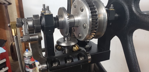

I haven’t posted for a week, but I’ve been busy.  Right after the last post I had an epiphany regarding the governor and decided to go a different way with it.  I’m pretty sure the “old” way would not have worked; hopefully this “new” way will.
So after working on the governor it was time for a little paint, as the weather is getting colder and my outdoor paint days are numbered.  After paint, I assembled the beast and had a good “look see” at the result.  A few photos show below:
Here is a view of the governor; sill a few more parts to make and assemble to connect it to the ratchet/pawl escape.  I may hold off doing that till after the first successful run.  I’m thinking this thing might well try to “run away” without a governor, since the piston drops immediately to the bottom of the cylinder after the power stroke- thus facilitating a new “un-governed” power stroke.  If it gets too crazy, I can always cut the ignition.
Finally I give you a video of the mechanism as I turn the engine over by hand.  Everything seems to be working as it should.  The piston lift is functioning, the clutch is working smoothly, the valve is cycling, the governor is spinning around, and the ratchet/pawl is engaging and releasing.  I’m pretty happy overall.
