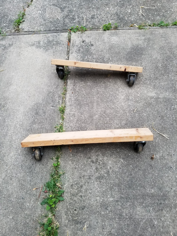

So--As I said, I will build a lathe transporting dolly with materials I have on hand. Small casters are from a moving crane I built about 25 years ago, then cut up and salvaged the material. Main body is 2" x 10" spruce, angles are old bedframe angles, and the two larger wheels and axle are off my handcart (borrowed) for the occasion. The red rectangle is the footprint of the lathe. The top of the dolly will be 3/4" higher than the cabinets that the lathe sets on. Lathe will be bolted to that top plank during transport. Steerable casters are 2 1/2" diameter. Larger wheels are 9 1/2" diameter pneumatic. Headstock end of lathe, which is by far the heaviest will set over these 9 1/2" wheels. I would have made the entire dolly much shorter and closer to the ground for stability, but my cherrypicker hoist will not fit into my machine shop. I have a secret weapon to help me with the move---a 180 pound son who works here in Barrie. After the move has been accomplished I will dismantle this dolly and band everything together and store it in case it is needed again some time. Thank you to everyone who responded to my post.----Brian

And now you know how I spent my day. Everything was material which I had on hand. I haven't heard back from the lathe repair people yet, but whenever they get it fixed I will be able to move the lathe back into my machine shop, with the help of my son.  That beats the heck out of the $500 I paid "professional machinery movers" the first time the lathe moved from my garage to my machine shop.

Nicely done. And you also have a portable bar for your next party. And a really tall skateboard...

Is it scalable?
-Doug
Re: Lathe Moving Dolly
« Reply #19 on: July 14, 2020, 07:01:24 AM »
I like that, no worries about it toppling over if it hits the odd bump :ThumbsUp:

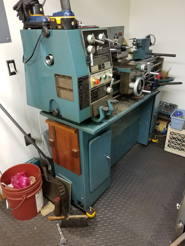

The lathe is repaired and today I fetched it home (more later). This picture shows the lathe freshly unloaded from my truck and bolted to the dolly.  It is still hooked to my cherrypicker hoist in this picture. The cart worked perfectly, and the lathe is back in it's home in the machine shop. I never did get my son to help. He works two jobs and couldn't come by until Thursday and I couldn't wait. Yes, it was top heavy, but I knew it would be. The dolly was very stable and when I pulled/pushed it from my main garage, thru my office and into my machine shop, it was a fairly simple move to slide it off the dolly onto the cabinets it mounts on.

Nicely done Brian.   you look really healthy too.  Congrats!
