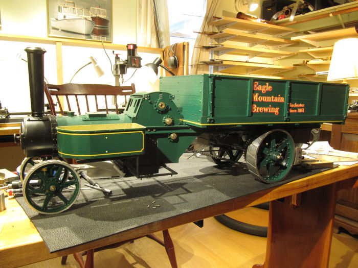

Well, no time (yet) back in the shop today to start all the riveting work, but I did get a treat in the mail today - the vinyl letters arrived! Just had to go see what they looked like, here they are:
They are a two-layer transfer, with the golden yellow on top of the dark red background. Each set came on some peel-off background paper, with a translucent sticky top layer to hold the letters in place. The letters were already spaced out in three and two lines. Once the locations were set and the paper carriers trimmed to fit the openings on the panels, the heavy backing paper is carefully rolled/peeled off to leave the letters on the translucent carrier - that took a little fiddling on the dots over the i's, which wanted to stay on the backer at first. Then the carrier is pressed into place, and burnished down with fingers to stick the letters to the panels. Roll/peel off the carrier, and the letters are left in place. Very nice - similar style to the old signage.

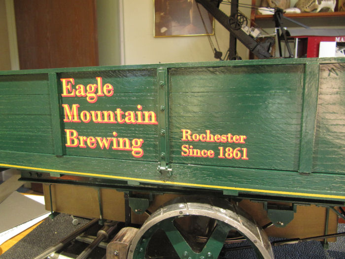

The other side:
And no, there is no real EAgle Mountain Brewing, it is a sister company to the Eagle Mountain Logging logo that I put on the tender of the Shay I built - the brand is expanding!  :Lol:

Dog that is awesome love the shadows in the lettering and the color choice....... :Love:

Wow!  That lettering sure makes it pop!  The red shadowing was a great touch.  Just beautiful, Chris!   :popcorn:

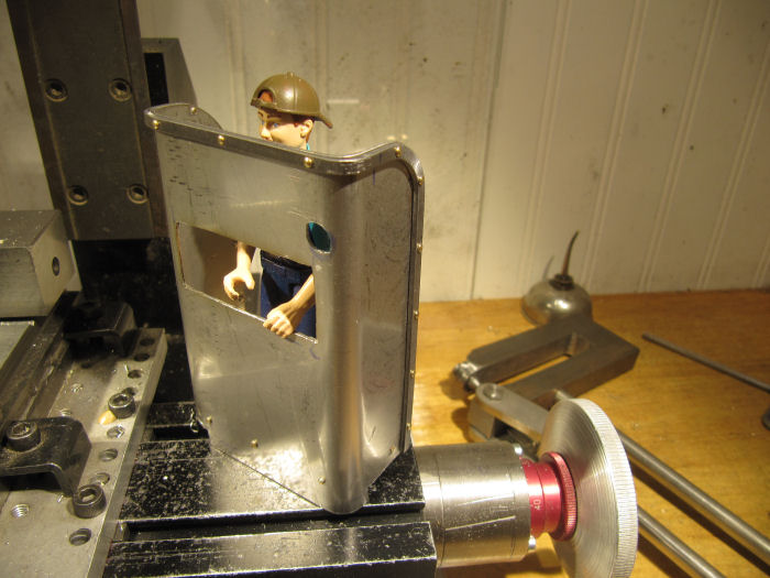

Got the edge strip riveted to the first cab panel - the shop elves have been watching old Mythbusters episodes and think I am making them blast shields....   :hellno:
