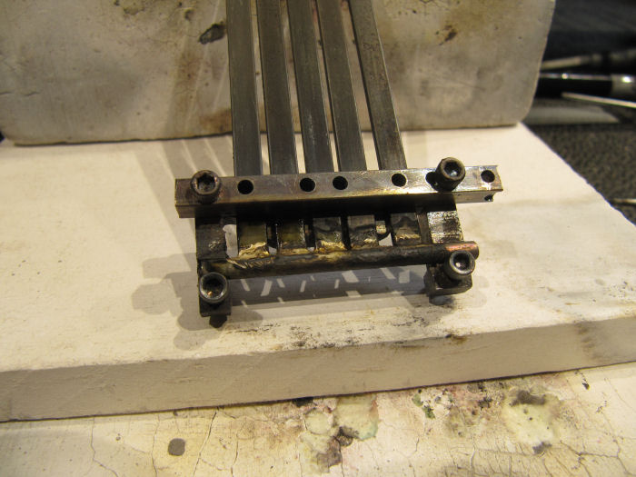

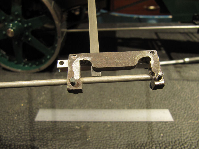

As mentioned, I am planning on making the hinges the same way as I did on the Lombard cab - thought sure that the jig was still in the piles somewhere, but I cannot find it. So, until the elves fess up that they made a shelf out of it in thier clubhouse, I made another one. Simple frame with a clamping bar and screws next to notches - to save time I reused a clamping jig from the Marion I-beams (have a pile of them still). Drilled a couple holes, cut off one side, and added some notches, instant hinge jig. Here it is with a bit of rod and strap clamped in place. For real use, the rod will be drilled for the hinge pins first, and a row of strap pieces lined up in the clamping bar. Then, silver solder down the length, making 4 or 5 hinge straps at a time. Then just cut the rod apart.
The clamp bar, with all the holes, was some scrap out of the bin from a part that got drilled wrong. Bottom view - the shape of the main jig is not important, that part sticking out is from the shape of the I-beam clamp. Main thing is to have the strap and rod held in place against each other for soldering.

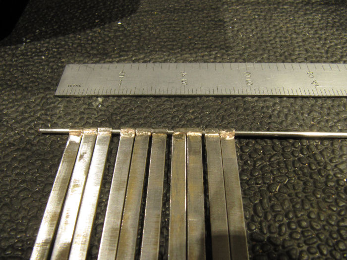

This afternoon got started on the hinges for the cargo bed - cut the straps to length, and drilled a couple pieces of steel rod for the pivot tubes. Here they are ready to solder up:
and waiting to cool and clean up/cut apart:
One more set to go...

Got the hinge straps cleaned up and cut apart:

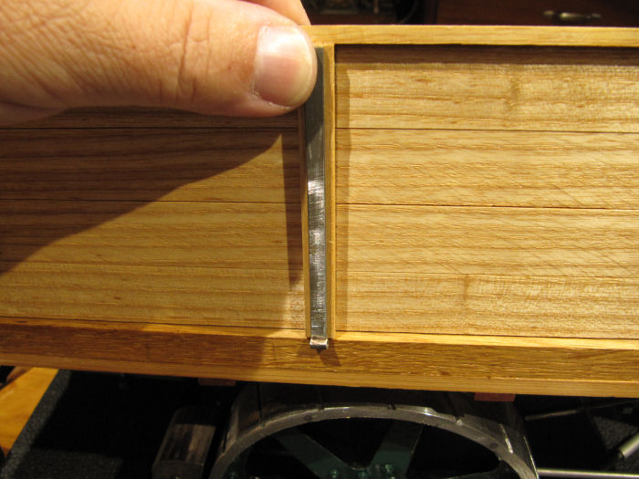

Here is where they will go on the side panels:
Next up will be to drill the holes in the straps for mounting screws, and taper the sides/round the upper ends. Then can start on the lower halves of the hinges that bolt to the cargo bed.
