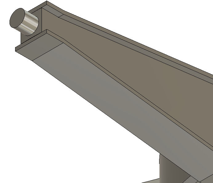

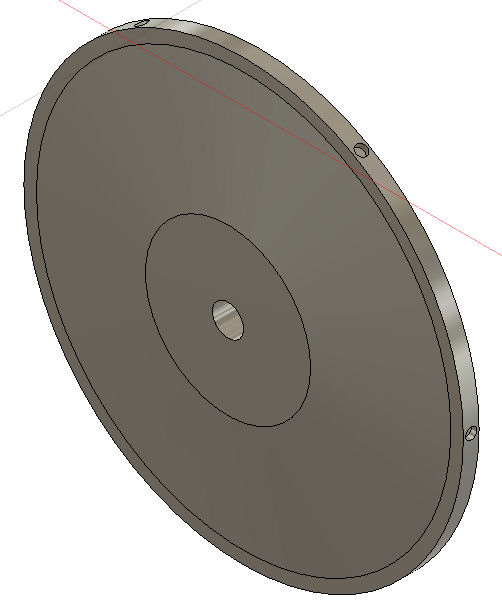

Okay, been thinking about CNR's suggestion, and looked through the bar stock that I have handy, think there is a decent solution available. I have a slab of 3/8" thick 6061 aluminum in the pile (think one end of it was used on some gears previously). If I cut a pair of discs (one for each wheel) out of it, and turn them down so each side matches the taper shape of the spokes, I get this:
The holes around the outside are 60 degrees apart, to match the spokes, and the OD matches the ID of the wheel tube. Then, I can make saw cuts either side of each spoke, and chain drill/mill out the wedges at the hub:
This gives a set of strong spokes that are narrower than the ones in the copper plates, while matching the width between the plates, so the plates can be bolted onto these inner spokes, giving the right look to match the original. The pins at the ends can be inserted through the wheel rim tube to hold it all together. Should be plenty strong, and not too hard to make. The end look would be a cross section similar to this:

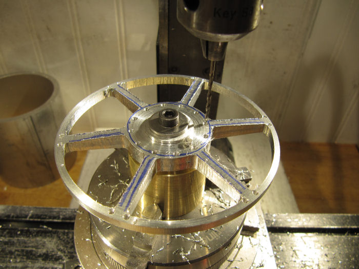

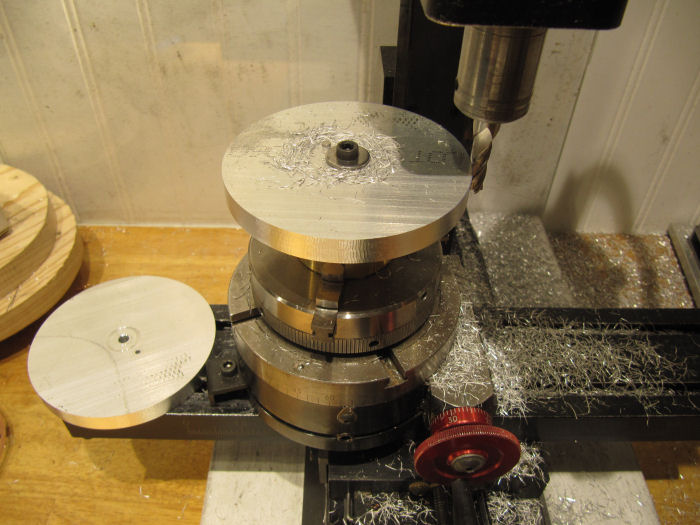

Okay, catching up on the pictures - I band-sawed out a couple of discs of the 6061 aluminum (did not see any deflection in the cuts, this alloy looks pretty stable as Brian said) and trued them up on the mill (the final diameter just fits on the lathe, the rough cut did not).
Moved the arbor over to the lathe, and tapered in the sides with the compound tool rest to match the shape of the copper plates:
After LOTS of long curly shavings filling up the waste can, had two discs that the copper plates fit nicely on.

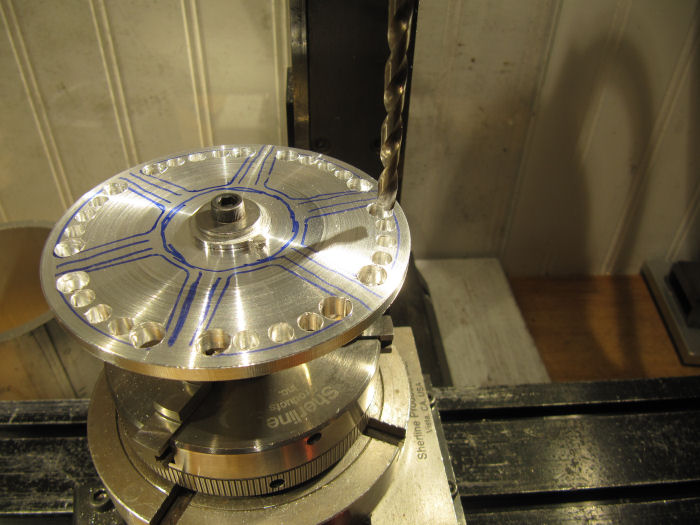

Back over to the mill to cut in the spokes, which will be narrower than the ones in the plates so there is a recess behind them. This is where I was going to just saw in from the rim, but I changed my mind (common when making things up as I go) and cut them in like I did on the plates, just with larger openings. Started with the arc at the rim,
then finished along the spokes and hub:
Here is the first one with the plates held in place, still need to finish the spokes on the second one:
I like this look, it better resembles the real ones, with cast or welded up plates. After getting the second disc finished up, I can start drilling for the patterns of bolts that holds it all together. For proper look, they will likely be 1-72 or 0-80 size, the 2-56 would be too chunky. Then can get started on the rim, and drilling through the ends of the spoke and rim for the pins to hold it all together.
