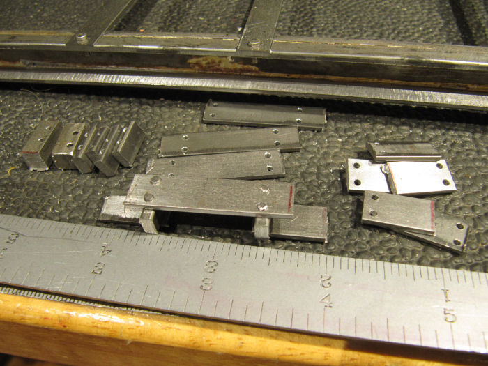

Okay, got the pieces all drilled for rivets and rough cut to length for the leaf spring brackets. These are simple rectangular brackets, but with thin/short parts so after some experimenting I settled on riveting them together to hold everything in alignment for silver soldering - these have to take all of the load from the rear axle, so they need to be sturdy.  Here are the parts, with one set assembled:
The assembled one is one of the front pair, the rear pair will have the wider risers to give room for the rear brake hangers. Leaving them rough cut for length will aid in the silver soldering, making an inside corner so I can lay in a short bit of the solder wire and do all four corners in one heat. Then they will be milled back to final size, and the rivet heads ground off.

More done on some boring looking but very important brackets to hold the rear axle leaf springs. Got them silver soldered, and trimmed off the overhangs on the bars. Next will start drilling mounting holes, pivot holes, and milling in the pivot slots in the larger blocks....

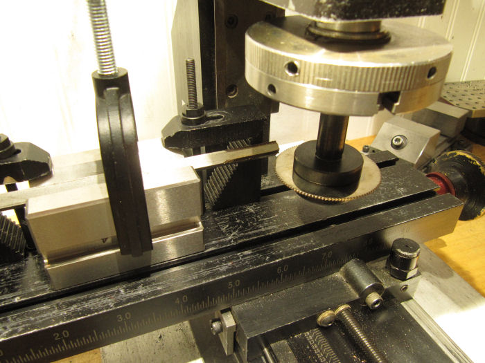

Next up is the brackets that hold the trailing arms to the rear axle as well as the pivot levers for the brake band. They are taller than the leaf spring set, to put the cross rod below the top length of drive chain, and they also extend past where the frame starts to angle in to the boiler, so one leg has to be at an angle. I bent the legs/pads from lengths of tool steel bar, and needed a way to solder them to the square steel block at the center. I set up the V-block on the lathe, and used a slitting saw to cut notches at two adjacent corners to fit the legs:

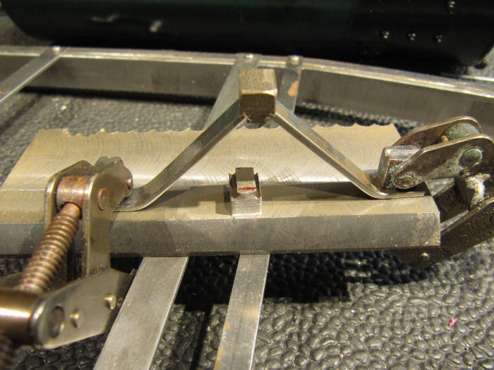

To hold them for soldering, it worked out that I could clamp the pads to a bit of bar stock, pushing against the block in the center, and it stayed in place. One leg has an angle on the end to match the bend in the frame, so that leg is not in line with the other.
Hung the part upside down on the firebrick, so the solder would run down into the joint:

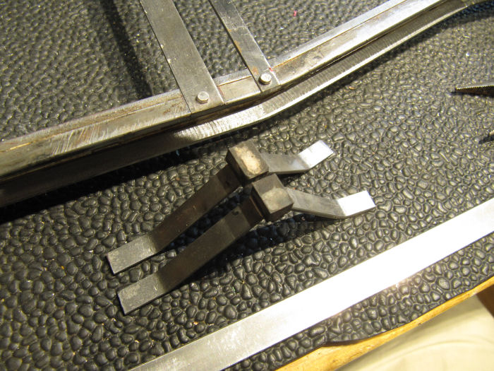

Added some heat, and cleaned them up with a soak in vinegar. Here they are side by side, ready for final trimming. The legs on the left are parallel, the ones on the right are canted, so they will line up with the frames:
On to trimming/drilling....

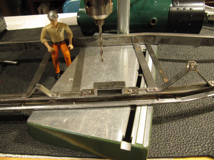

Once I got the elves out of their truck, got some more done on the brackets under the frame - drilled and slotted the large front ones (which will hold both the brake levers and the rear axle links). Then clamped the first set down the side, and drilled for the mounting screws. To ensure the holes in the brackets were aligned with the holes in the frame, I first drilled clearance holes in the bracket foot pads. Then, set up the small drill press (Proxxon) with the clearance drill, and clamped the brackets in position. Then used the clearance drill to peck a starter hole, using the hole in the bracket as a guide to keep the drill in position and not skating off. Then, switched to the tap drill size (for 2-56 screws), and drilled through the frame.
You can see the ends of the screws from the top crossmembers sticking through the frame - all the screws will be trimmed later.
