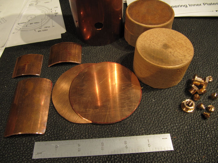

Today got the blanks for the endcaps sawn out from some copper sheet, and turned the wood formers down to size for this boiler (reusing ones from another boiler that was slightly larger diameter).
Since the weather is rain and thunderstorms today, I am going to wait to get the endcaps outside to anneal/form/anneal/form/etc them into shape. So, got the blanks for the engine mounting plate, stack base plate, and steering assembly mounting plate cut from the extra tube from the boiler. When cut lengthwise, it expanded the inside diameter slightly which was a very close match to the OD of the shell, got lucky there. Those pieces are at the left in the photo. Also made the bronze plugs for the water fill and blowdown bushings from some round bar - threaded the ends then milled in the hex on the cap portion before parting off from the bar.

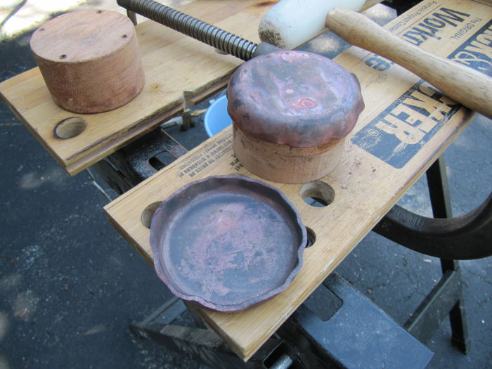

On to one of the really fun parts, forming the endcaps for the boiler shell. These started out as discs cut from some 3/32" thick copper sheet (been using the same sheet for boilers since my Shay build, still enough left for several more) plus a pair of hardwwod formers turned to size.  The formers were cut to slightly over the ID of the boiler shell minus twice the thickness of the sheet. During the forming process, the rim of the flange got about .015 to .020 thicker than it started, since it had to absorb the material beyond the finished diameter. The rim will be turned to be a good fit in the boiler shell, leaving just a slight space for the silver solder to wick into.
So, with the storms last night/yesterday past, and the next round not here yet, I set up outside with a portable workbench and the Sievert propane torch with a medium/large nozzle to use in annealing the parts. The copper comes half-hard, meaning it will bend a bit but not that much. To anneal it so it is soft enough to bend, it is heated to a dull red with the torch then cooled by dunking in a bucket of water (carefully, as it goes in it can pop out very hot drops of water/steam). With copper/brass, quenching or air cooling is not much different, and unlike steel heating then quenching it makes it softer, not harder. The only way to harden copper is to work it, either bending or hammering.
Started by annealing both pieces, and clamped them one at a time between the formers. Then went around the rim with a plastic mallet (available from jewelry tool suppliers), starting the bend of the rim down. Its important to work around the whole thing, not taking a lot down in one spot then moving on, to keep from forming creases in the metal - it needs to flow into neighboring sections as it bends to take up the extra metal. Here it is after one round of hammering (since the clamp is in the way, need to go most of the way around then turn th parts). Not a lot of change, but after a few hits it stops moving the metal and the hammer just bounces off. You dont want to keep hammering, or you risk cracking it.
Back to the torch, reannealed the metal, and second round:
You can see how it is flowing the metal down, spots like the one sticking out a bit at the right side in the last picture are the first hit in the next round, so it does not form a crease. By the third round, it is getting close to the cup shape:
After the fourth round of annealing/hammering:
The waves are there but not bad, those high spots are hit first in the next round:
One more set after that one, and they were done.
On the last round, they tend to have gripped into the wood at the rim, so it takes a little prying with a large screwdriver to get the part off the former. Any spots where the prying bent something are easily tapped back into smooth shape. Here it is after some cleaning up and a dip in the pickle solution to remove the soot left from the torch:
The rim is pretty smooth on the surface that will touch the boiler shell, but the raw edge is wavy - that is another sign that the metal has flowed during the forming, since the original disc had smooth edges. Just as I was finishing up outside, the next round of rain moved in - lucky timing! Next steps will be to put the parts on the lathe and turn the raw edges back smooth, and turn the OD of the rim down to fit the boiler shell. The wood formers will be used again for that - one srewed to the faceplate (which is how they were made originally, so the screw holes are already there), and the other pushed against it by the tailstock to keep the part from coming off the first former. After that, can start in the next stage of machining, which is to bore the holes for the firetube and the bushings in the backhead, followed by making the stiffening ribs inside the caps.
