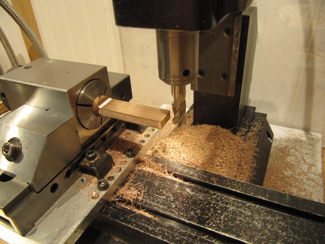

Today started in on the ribs that will be inside the boiler where the studs for the engine mounting plate will be - could also have made a dozen threaded bushings, figured this would strengthen the area around the steam dome hole better. Started with some phosphor bronze rods, one squared up for the lengthwise ribs:
and the other for the curved ribs that run crosswise:
Blanks ready for further shaping. The tall ones will be milled to an arch to fit the curve of the boiler shell. All will have relief notches to prevent bubbles being trapped outside the ribs.

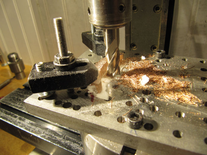

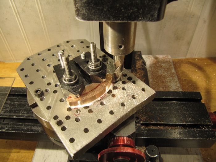

Took the bronze rectangles milled from the round bar yesterday, and clamped them to the tooling plate on the rotary table, with a couple layers of card stock between the part and the table so I could cut all the way through but not harm the table. A couple of trials, and got the distance right to mill the outside edge to match the inside of the boiler shell:
No easy way to measure that distance, so I just moved the table over to the left after cuts and held the boiler tube to the part, to see if the center or ends was touching first, and adjust accordingly.
Then, with the outside edge cut, one at a time moved the clamps to the outside, keeping the part in its position, and milled the arc on the inside edge. That edge is not critical, but wanted it to be concentric.

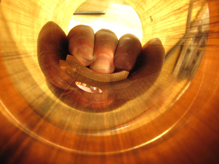

Here is the first part held into the middle of the boiler tube to show how it will sit.
The parts so far - the straight bars will be screwed to the curved ones with a small brass screw to hold for silver soldering, and the assembly held to the boiler shell. All four bars are a little long, so they need to be trimmed first. They also need to have some notches cut in so that steam can rise up the boiler shell to the center without being restricted by these bars.

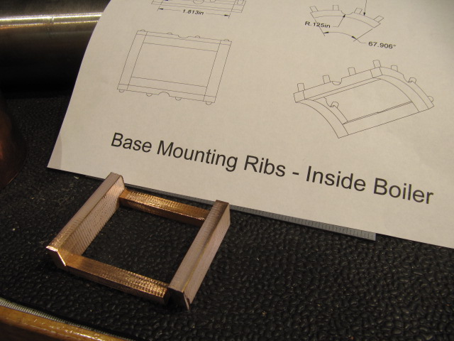

Got the engine plate inner ribs trimmed and assembled,

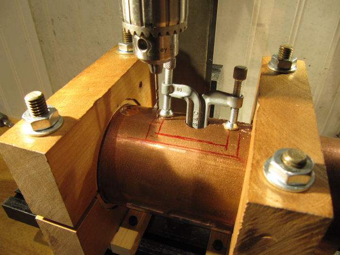

used the tube-holding-blocks to position it for drilling part way through for some 2-56 brass screws to hold it in place for silver soldering

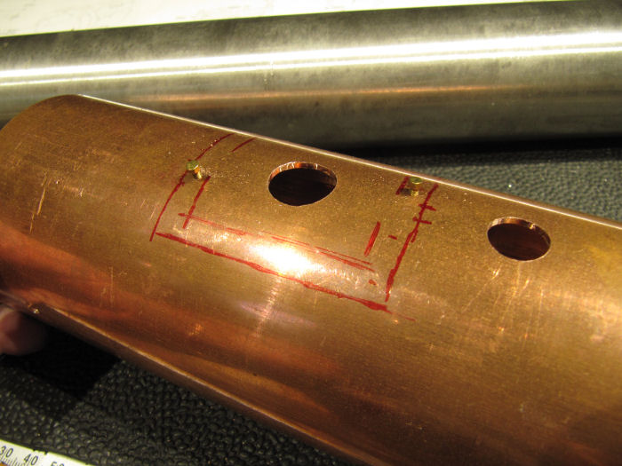

then tapped/inserted the screws to keep it in place
The red lines show the outlines of the ribs underneath. After soldering, will redraw the lines and use them as guides for drilling the engine plate bolt holes, which will go halfway through the ribs.

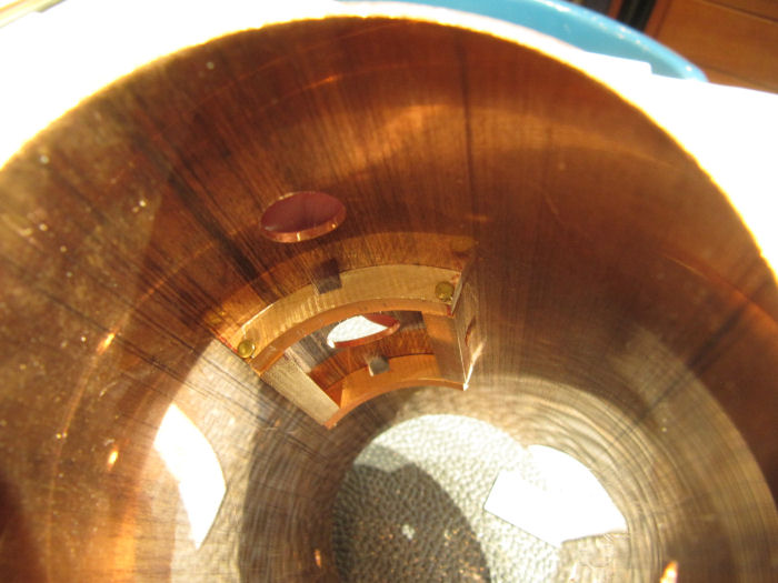

A look from the inside:
So, I have the boiler shell tube and its bushings ready to go, I think the next step will be to start on the end caps. They will be formed over wood patterns, annealed and hammered from copper sheet stock. Fun to think back on the first boiler I did, and how long it would have taken me to get to this same point back then!
