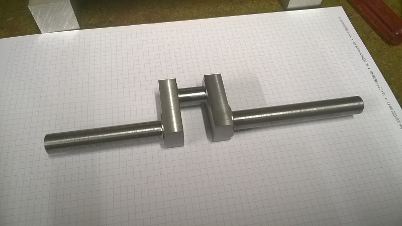

Because I've never made a one piece crankshaft before, I decided to start with that one, so in case it is not turning out right I can still abort the project...

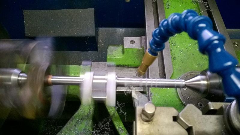

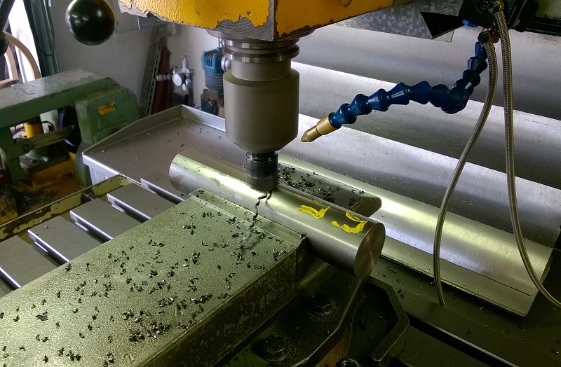

To start with I got some normalized S355 bar which will hopefully not distort too much while being machined
The round bar was machined square and then the shape of the crank was roughed out

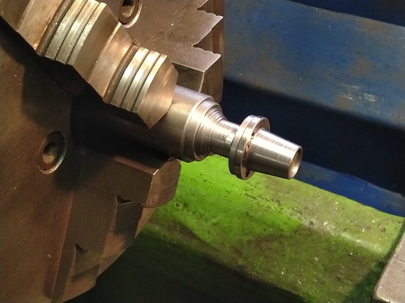

Then turning the crank pin
Roughing the outer parts of the shaft

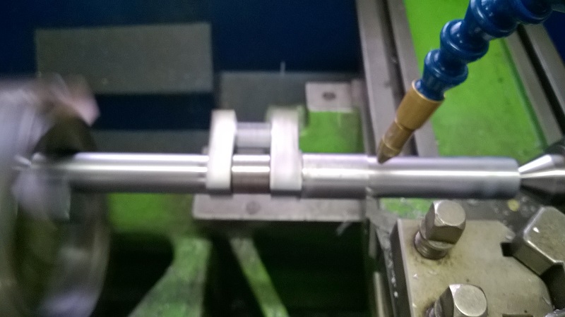

Since I've done some wrong thinking :facepalm:, the crankshaft hat to be shortened and center drilled  again
To then finishing the shafts

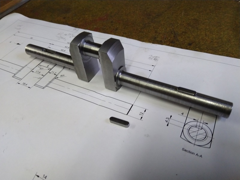

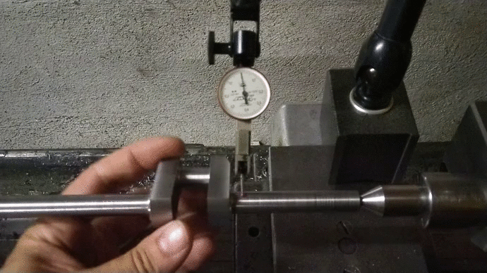

That's what it looked like so far. I left some material to take a skim cut on the crank webs too.
Moment of truth  :thinking: I think I can live with a runout of about 0.02mm  :)
So I went on with cutting the keyways
And cutting the key accordingly
Done:

That's a good start  :praise2: You may find that the runout changes over time as the stresses in the metal release. Generally it can be trued up again.

Roger, I sure hope it will not distort more. But we will see, time will tell....

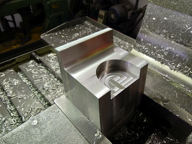

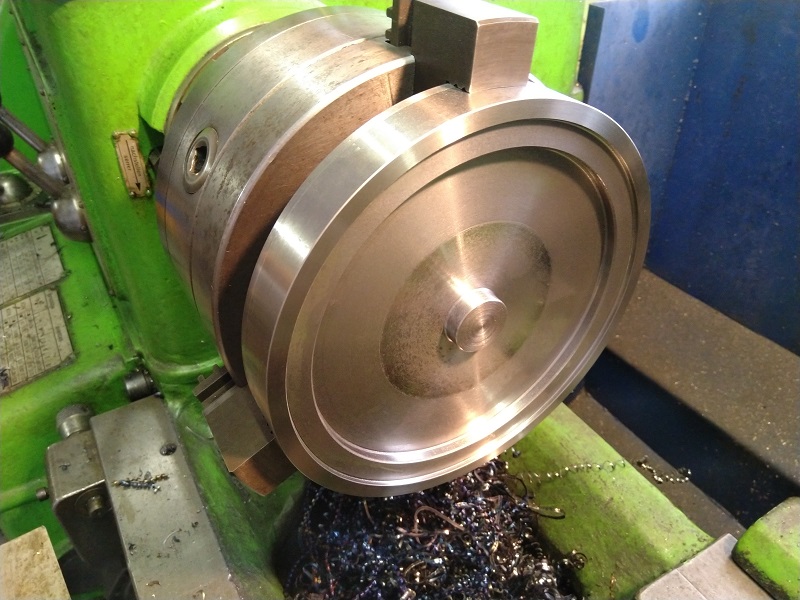

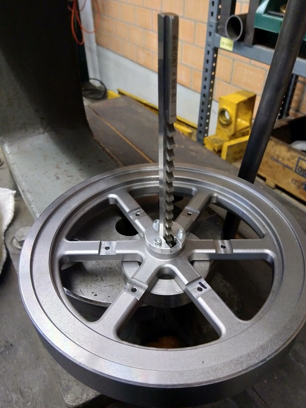

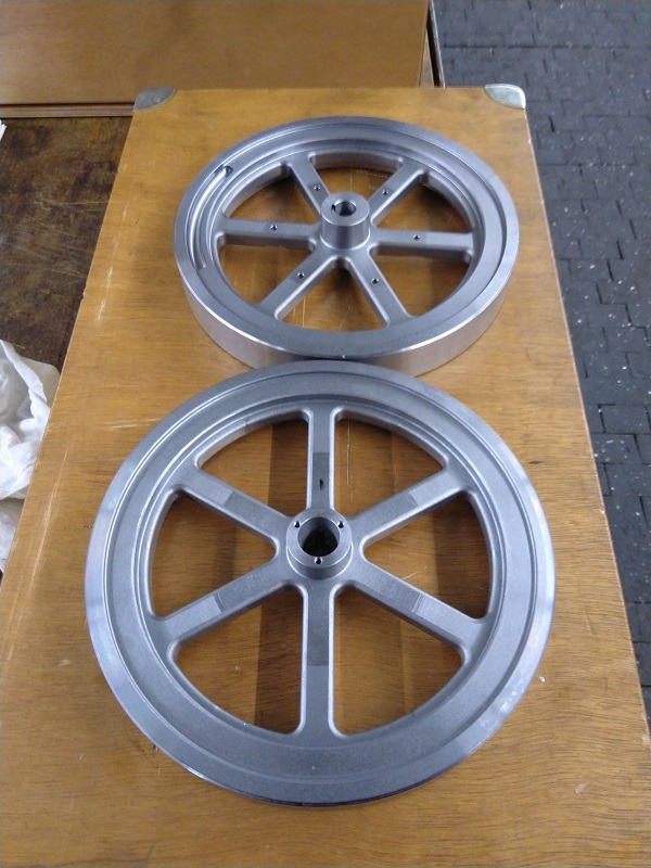

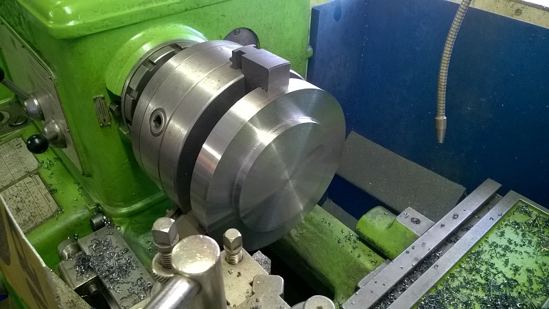

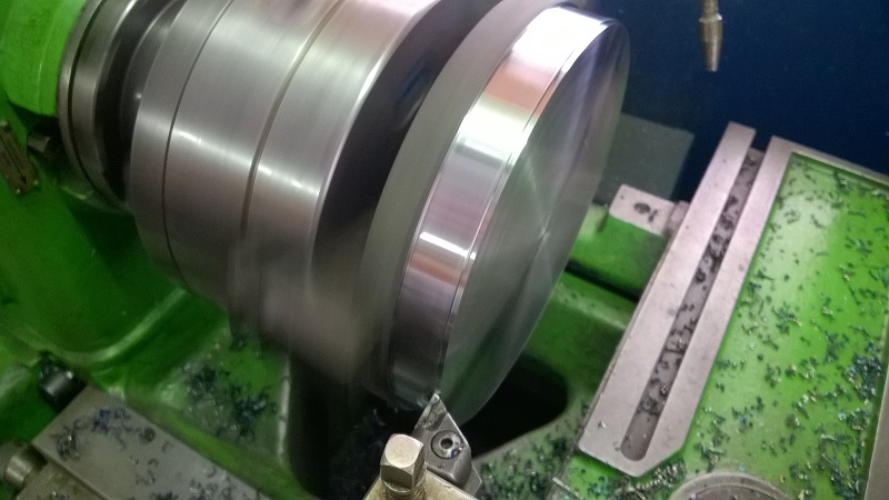

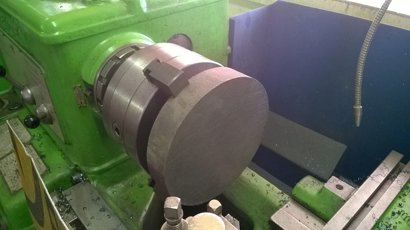

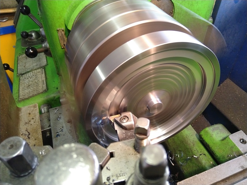

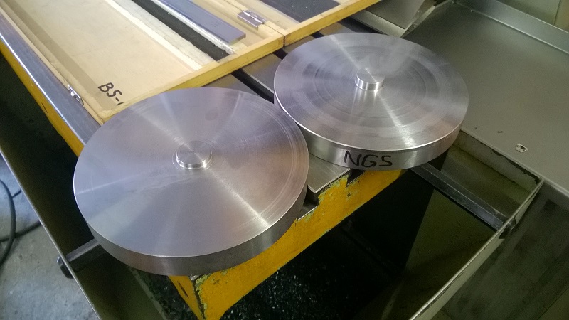

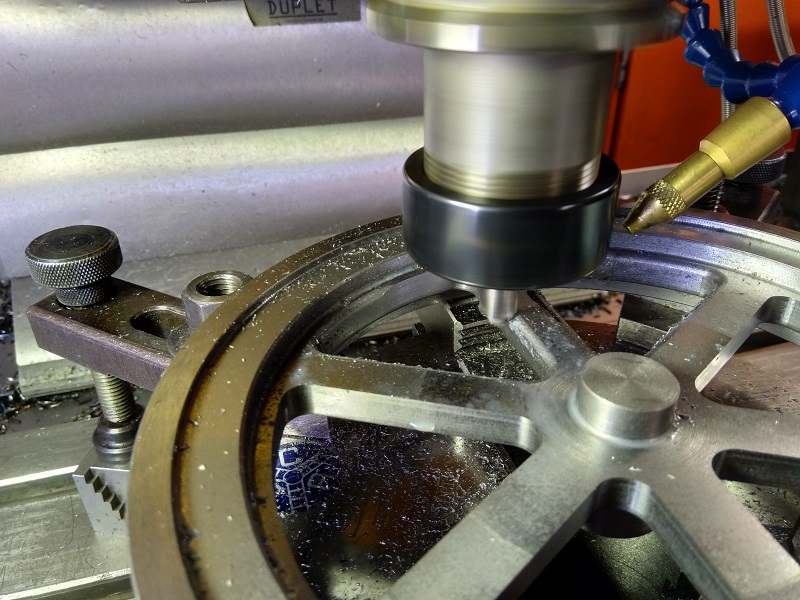

Next I started with the flywheels. There have been two blanks of steel of pretty much the perfect size lying underneath the shelf in the shop for ages. As it seems, these have finally come to their destination.  :)
Ready to go

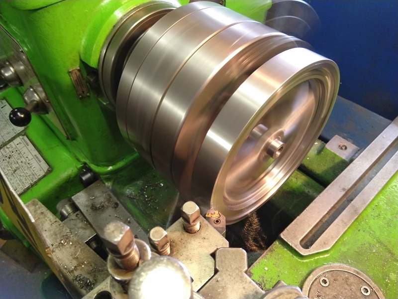

Turning the outer shapes

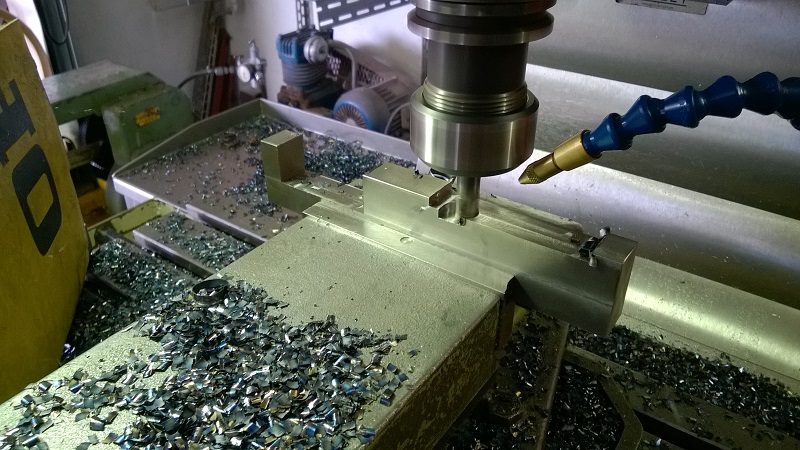

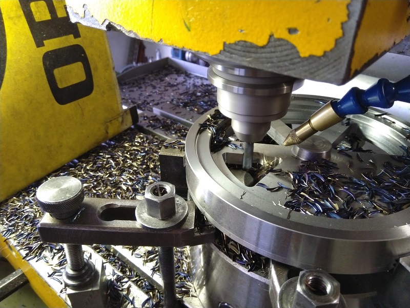

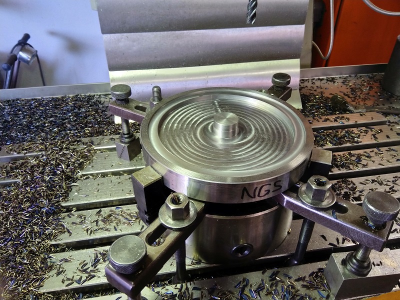

I decided to mill the reliefs in the wheels instead of turning them. Here are the two Flywheels ready for the mill
 :Mad: :censored: :censored: :censored: :cussing: :cussing: The crappy endmill I used for this didn't quite cut it. It got dull an therefore pulled out of the collet. This is the inner side of the governor side Flywheel. That's going to leave a mark. I guess....
But since I'm planning to paint this engine, I think I'll be able to fix that.
I purchased some decent carbide endmills (what I should have done from the beginning) and these made live much easier.

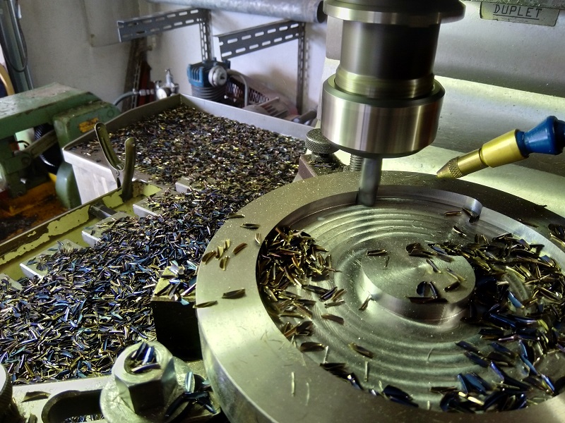

Relief milled of the non governor side flywheel
There was some material left at the bottom of the reliefs to be cleaned up on the lathe.

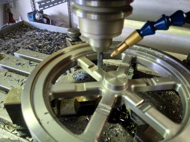

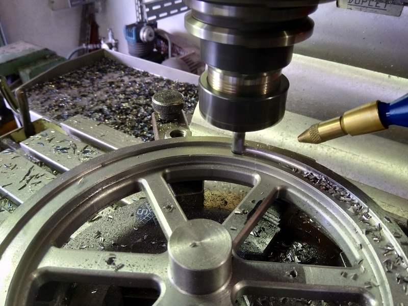

Next step was to mill the spokes.

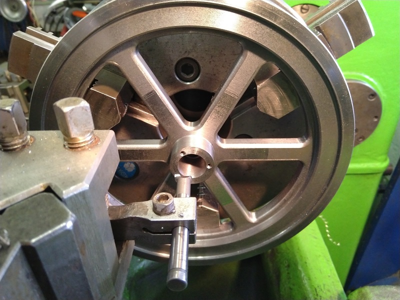

Then a radius cutter was used to mill the radii on each side of the spokes.
Milling the slots for the spoke lugs on which the pulley will be fixed.
Milling the relief to balance the weight of the piston using a ball nose endmill.
The flywheels so far. There is still the bore to do and on the rims there is also some material left for a final cut in the same set up as the bore will be done.
Thank you for following along an stay tuned for more

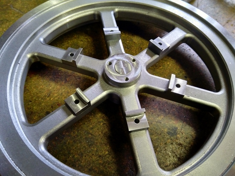

Is it only me or does some one else also know this behavior: On a project first the most demanding Part (i.e. crankshaft) is made, then the "interesting" ones like flywheels and then it boils slowly down to the fiddly bits which need be done...

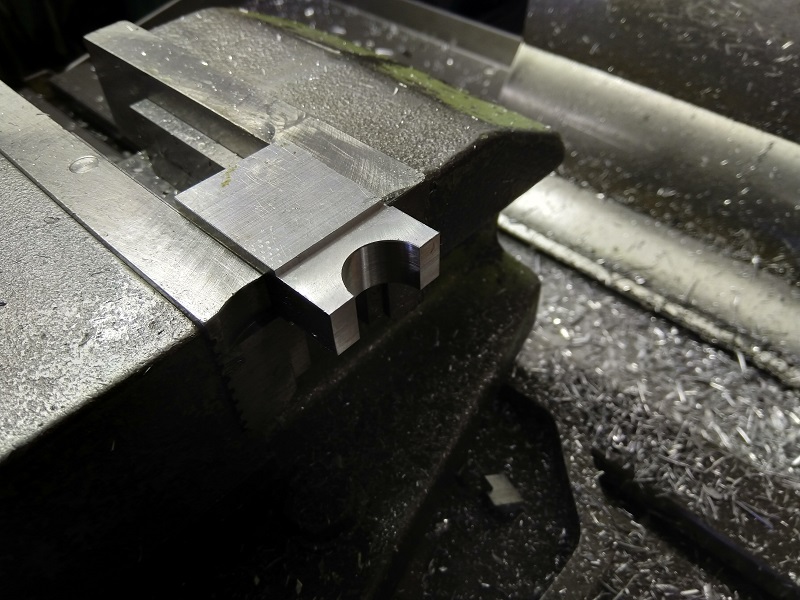

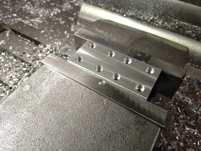

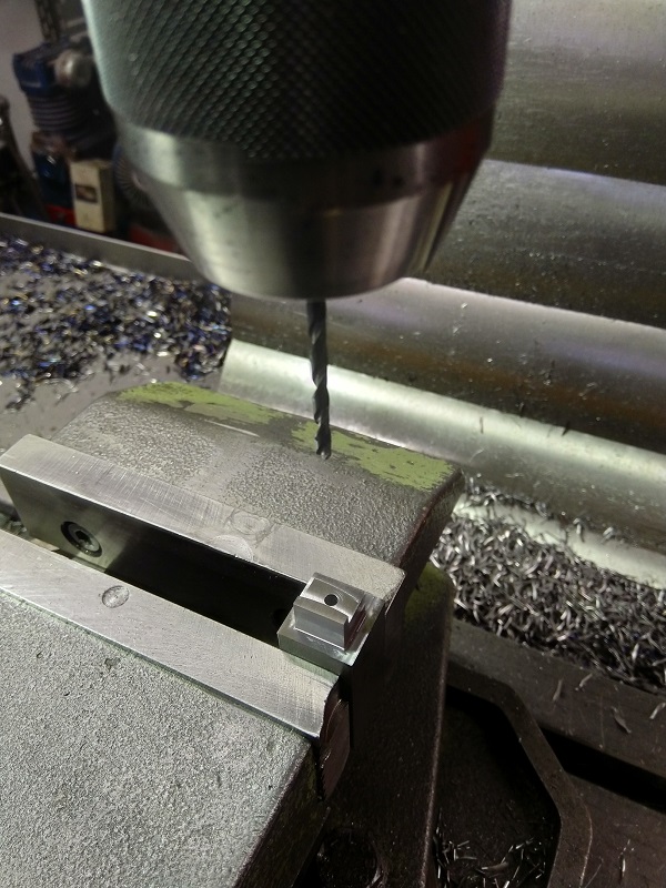

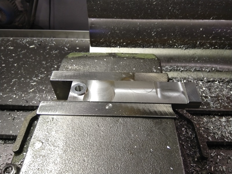

So to counteract this at least a little, I decided to make the spoke lugs next.

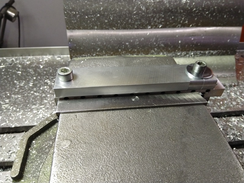

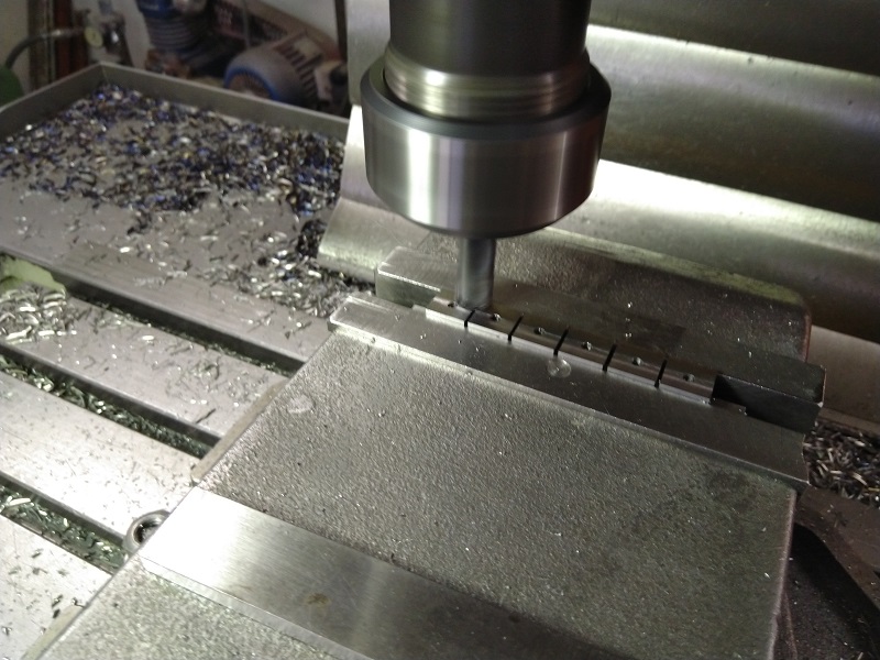

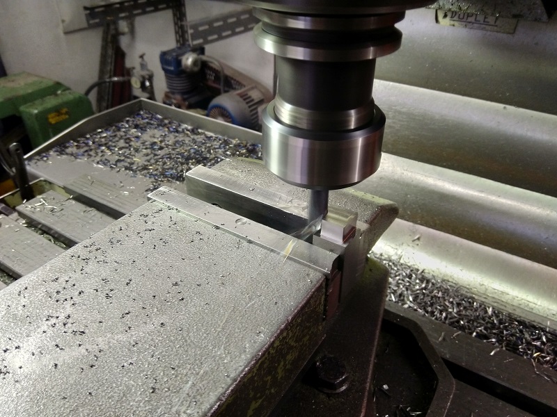

Milling the contour from some steel bar stock:
The hole for the bolt drilled
Milling the thickness, all of the lugs in one shot :)
Test fit
Thank you for following along.

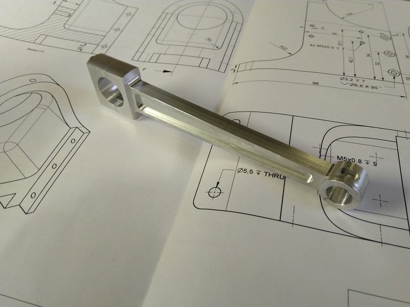

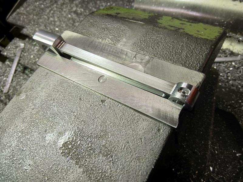

Next part to make was the conrod.

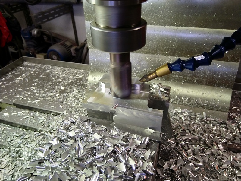

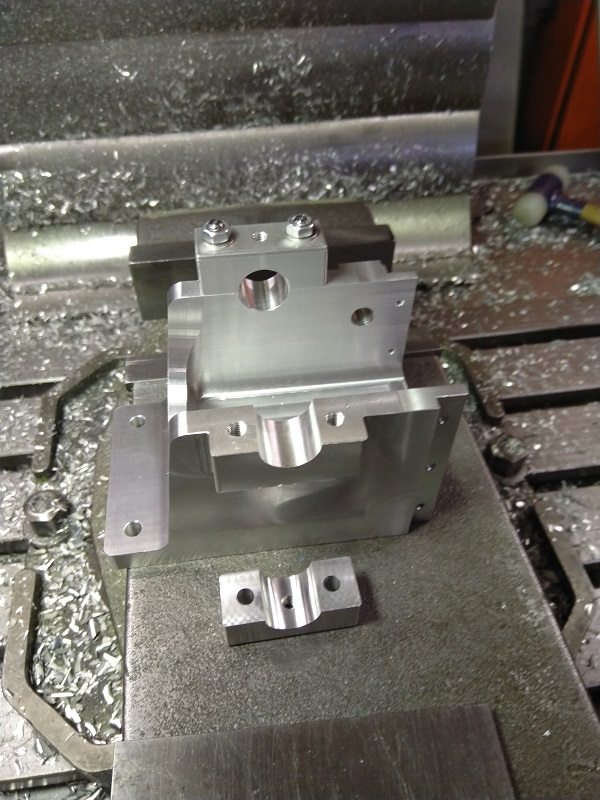

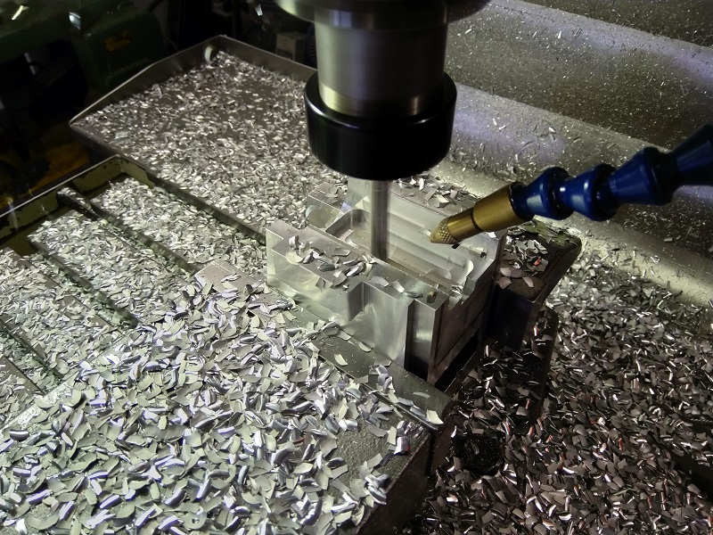

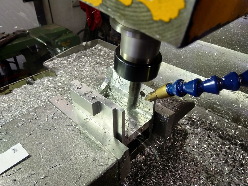

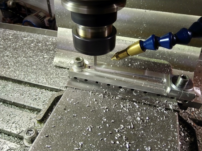

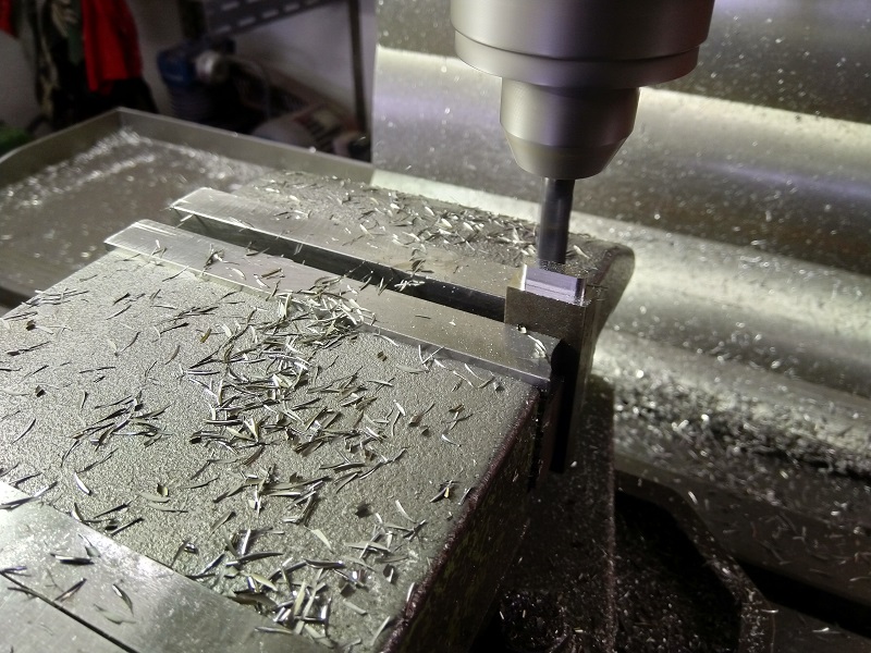

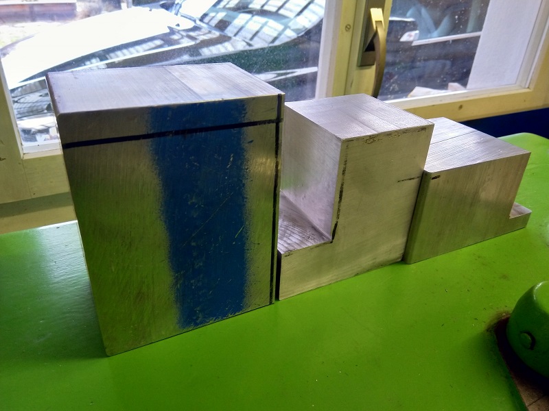

I started with the bearing cap of the big end

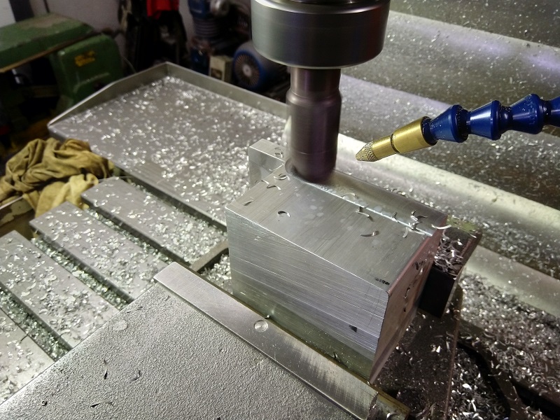

The bearing cap was then bolted in place on the stock for the conrod in order to mill the outer contour
Milling the recess on the first side
And then the seat for the bearing and the relief
First side done

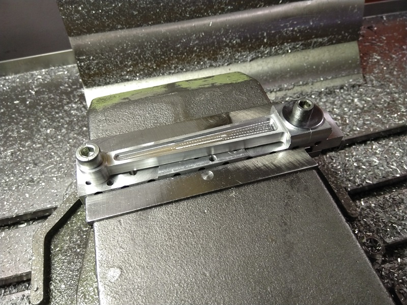

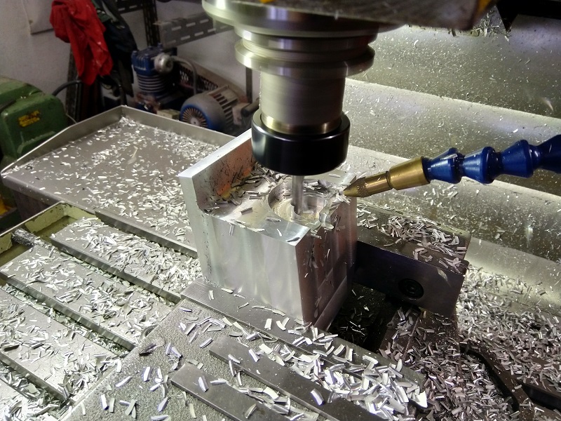

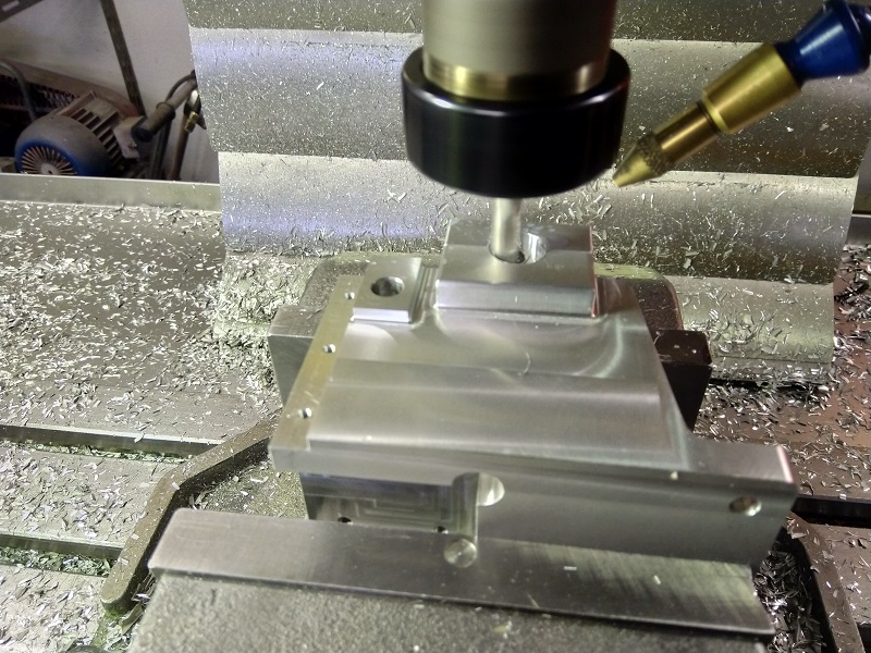

Set up for the second side. In the scrap aluminum underneath were two bosses milled to locate the con rod.
Milling the contour
Contour done

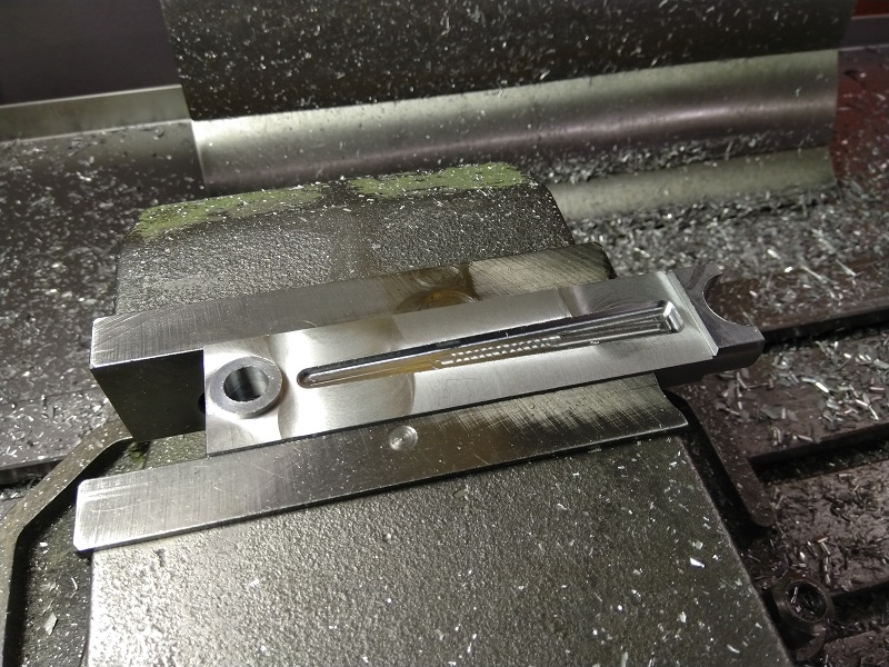

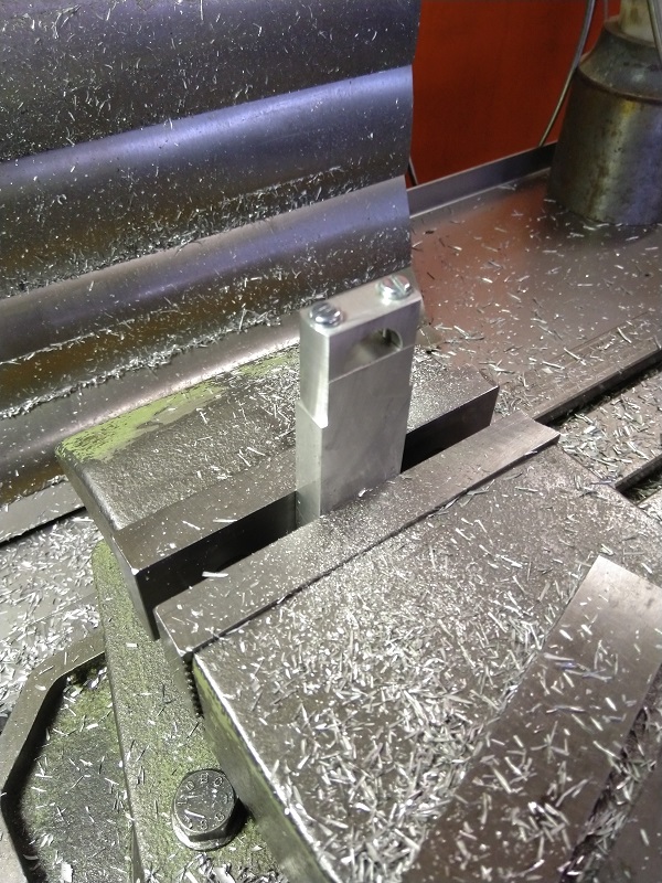

And the final setup to mill the lubrication access in the small end
Finished part

Cracking job Plani  :ThumbsUp: I see no coolant so do you use a gentle airstream to keep swarf away from cutters? That must help towards your beautiful surface finish.          Terry
