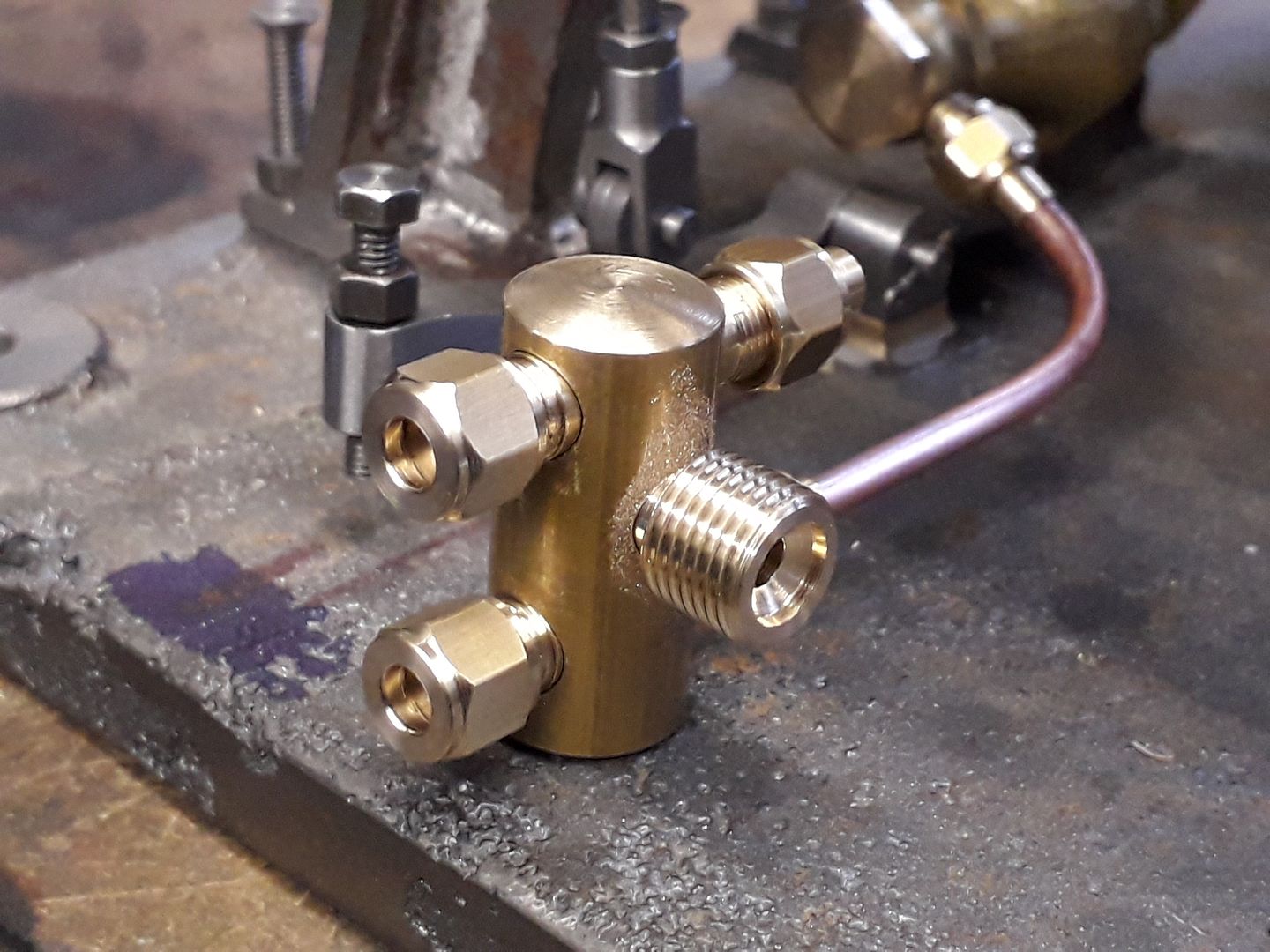

« Reply #7 on: July 12, 2020, 05:53:07 PM »
Some " heavy metal " arrived in the post a couple of days ago....
My favourite Brass foundry reopened mid May and they've been busy getting all the Brasses sorted from my original wooden patterns that were recovered from the Uppingham school.
I've had to make a new pattern for the skew gears which will be 6 & 12 tooth wheels on a 6 DP format.
Cheers Graham.
