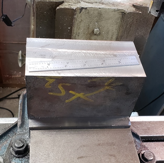

Several days of activity in the shop has produced the base for the engine.  I'd been saving this piece of aluminum for building the Regal model (a design thread I authored last year) but the Regal has been pushed back again in lieu of building this Witte model so I'm using what I have as opposed to buying more.
Even after carving on it a while you can see from the photo that itís still a rather sizable piece.  This is going to build a fair sized model and I was tempted to increase the scale ratio, resulting in a smaller model but when I got into the design, some of the governor parts were getting pretty small and designing them smaller yet wasnít going to help me see what I would be doing come build time so I decided after all to stick with the 1/5th scale size.
Iíll be moving on to the upper frame next.

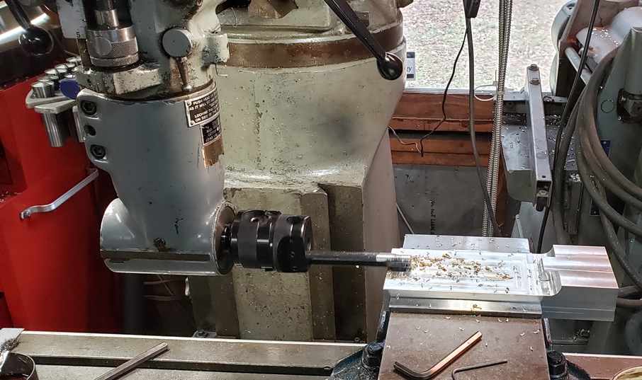

Here is a photo of one of my more interesting setups.  I might have had the vertical distance on my mill to do this with the down-feed on the quill, but that would have entailed removing the vice and setting up angle blocks to hold the work piece.  This seemed easier and as Iíve said before; donít miss an opportunity to play with ALL your toys. :Lol:
Iím using my right-angle drive, with a boring head attached and using the power X-travel to feed the work piece into the boring head.  This worked better than I thought it might.  Nothing seemed to be complaining so I incrementally went to the full depth I needed and got a good smooth finish.

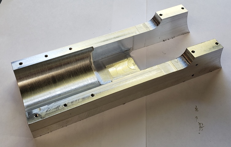

Here are a few photos of the engine carriage or engine frame.  This sits atop the base I made up thread.
