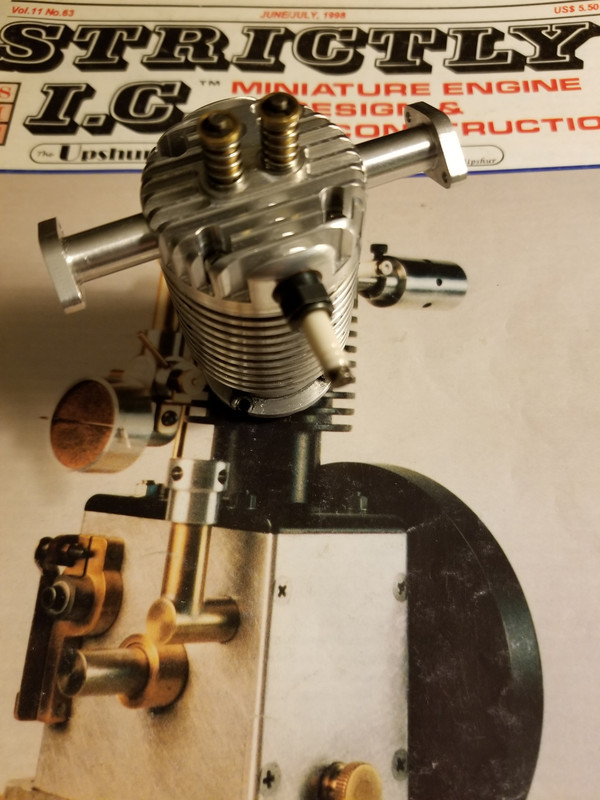

This is the other bit I've been tinkering with. It has been giving me fits. I used steel inserts in the cylinder to mount the head to the cylinder, but I think they are off center. I have to mount it in this alignment so the holes all cooperate.

Your new part looks great  :ThumbsUp:

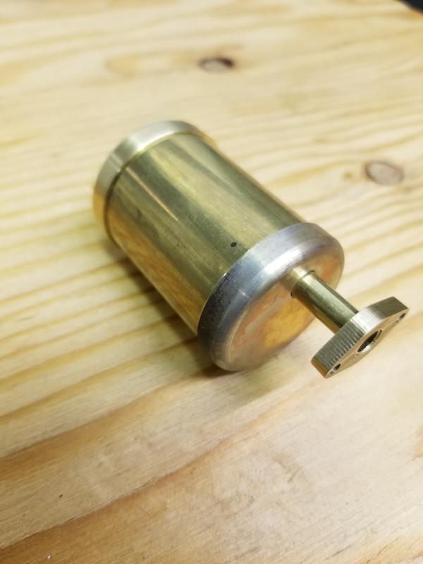

« Reply #22 on: March 26, 2020, 01:57:29 AM »
Hi everyone,
I'm back, I spent a lot of time last weekend working on a new muffler for the Upshur. I would have neglected to take photos of the individual parts but for one thing. My propane torch didn't throw enough heat so I could properly silver solder it.
So now I will have to pull out the big guns, I have an oxy-acetylene torch that I will now have to dig out of its corner of the garage behind my motorcycle. this is what the parts looked in their pristine condition.
This will be the end result. I will still need to clean up the ends, as I left them oversized.
I have heard people talk of a pickling solution to clean up after silver soldering. What is that? some sort of acid? Any help would be appreciated.

« Reply #23 on: March 26, 2020, 01:08:07 PM »
I am the furthest thing from an expert, since my soldering skills are near-zero. But I've seen people talk about using citric acid. If you can get to the store in these days of pandemic, you might find the citric acid powder in the same section as vinegar and such. Or if there is a section devoted to canning, it should be there.
Unfortunately, I don't know how strong of a solution people use ... hopefully someone who actually knows soldering will chime in!
Andy
  • Posts: 7609
Re: Rebuild time for my Upshur single
« Reply #24 on: March 26, 2020, 03:03:35 PM »
Buy citric acid powder at the grocery store. Start with half a quart of warm water in a jar.--Keep adding powder and stirring until the water is fully saturated and no more citric acid will dissolve.  Leave soldered parts in it for no longer than half an hour. Make sure they are totally submerged. Then remove parts and scrub them under the water tap with a small brass bristled brush and dish soap. Rinse off with clear water when finished. Note that this treatment is for after silver soldering, not before.
  • Posts: 7925
« Reply #25 on: March 26, 2020, 04:37:59 PM »
I use Sparex for a pickling solution.  It's supposed to be somewhat less toxic than the traditional sulfuric acid pickle solution.  But I'd still be careful with it.  It's still acidic.

I use citric acid, it does the job, maybe a bit slow for some people,but its safe and harmless .    Ian S C

Thanks everyone who replied, I will try and get some citric acid. This is a job for this weekend I think. I do have the brass wire brush to clean it with, so I will give it a try.

Art, get it (the powder) from the supermarket, or the Home Brew shop, at one time I got quite a big bag of it at the garden  shop, it's quite cheap, if you cankeep it warm it will act quicker,

Thanks for your suggestion of citric acid and how to use it. It worked, to good effect this weekend. It did take a bit of practice to get it down but, I did get the muffler done. So much for all the photos I was going to post, Post Image had this message up when I went to their website. "Server is under maintenance, sorry for inconvenience. ETA ~1 day" Soooo I guess I won't post photos til tomorrow. Some things I can say without photos. This was a learning experience. I couldn't get enough heat from the propane torch to melt the silver solder. So I moved things around in the garage to move the oxy-acetylene torch. First lesson was prep everything in advance so you aren't waving the torch around trying to put flux on the rod and melting the baffles of what I'm trying to weld. I didn't realize what I was doing till I heard the tink of the fallen part. To get the two baffle sections with 26 holes I went through 12 inches of the .190id X .210od tubing. That's for about 5 inches worth. I also ended up being glad I made 3 mounting flanges because I used them all. Ended going from # 1 to a #0 tip I'd have saved myself some grief if I had checked for that one in the first place. I would like to have another go at some of the joints but would rather leave it as is than blow it, so it's done. More later.
