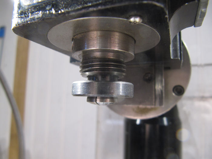

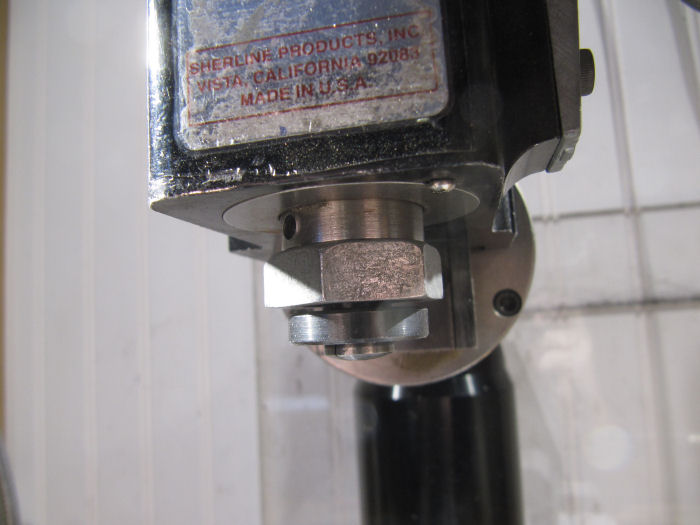

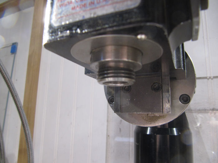

Re: Colchester Taper turner
« Reply #6 on: March 03, 2020, 09:54:49 AM »
A sketch of 25218 with measurements.
I have visitors... so the next bit will have to wait.

Andy.
The swivelling section is 330mm x 61.5mm.  The base on which it swivels is 395mm x 74mm.
Jo,
If I am reading your dimensions correctly with a=1/2" and b=9/16" this would give the slot a depth of 1/16".  This looks at odds to your third picture which to my mind shows quite a deep slot.  Or did you mean the slot was 1/2" deep.
Sorry to appear a bit stupid. :old:
Colin
« Reply #8 on: March 03, 2020, 04:56:33 PM »
 :headscratch: I was in a bit of a rush this morning... I will need to check them again tomorrow.

« Reply #10 on: March 03, 2020, 08:10:21 PM »
Andy,
How deep is the recess in the bottom.  It looks a lot deeper than 1/16" in the picture.
Thanks,
Colin
Offline Chipmaster
  • Posts: 989
« Reply #11 on: March 03, 2020, 08:27:33 PM »
Yes it is, as you can see in this picture - I've turned the brightness up. It was taken with a mobile phone in an awkward position reaching over the back of the lathe.
I'll have to leave you in suspense for the measurement 'til tomorrow night. Jo may provide the answer in the meantime.
IMG_0970 (2) by Andy, on Flickr
Andy
« Reply #12 on: March 04, 2020, 01:35:34 PM »
I just measured the recess at just over 1/8th inch. I must have measured the 1/2" wrong and it should be nearer 10.8mm thick (27/64th's ish  :facepalm: ).
