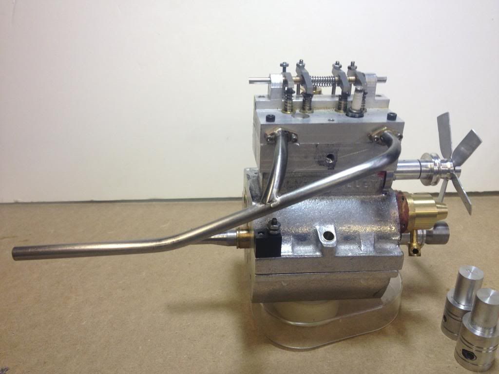

I posted a photo in another section showing my Bond's Simplex engine which is almost finished.
I thought I would share a few photo's taken during the actual machining operations.

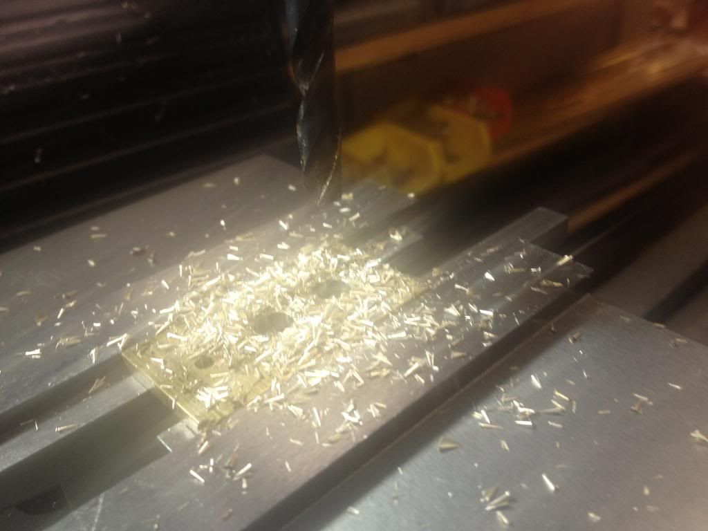

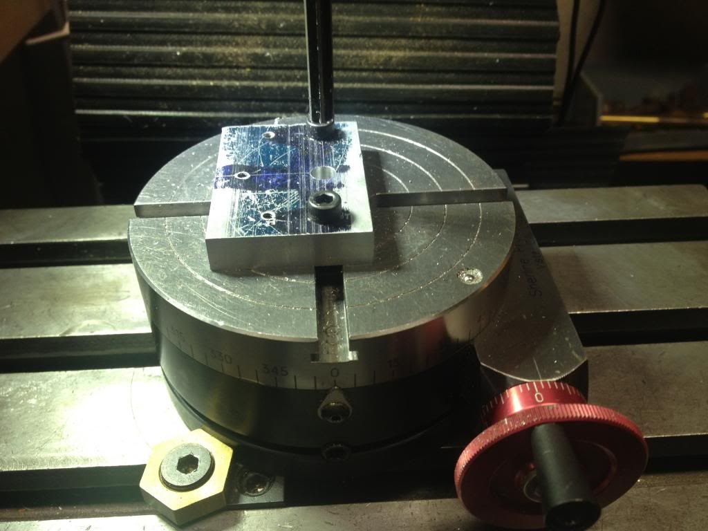

OK
Here is a selection of crankcase machining operations.
Set up on a rigid post mounted on my own design of low height indexing table, it allowed a few faces and holes to be done with minimal re-setting.
And using a boring and facing head to machine the register in the top face for the cylinder.

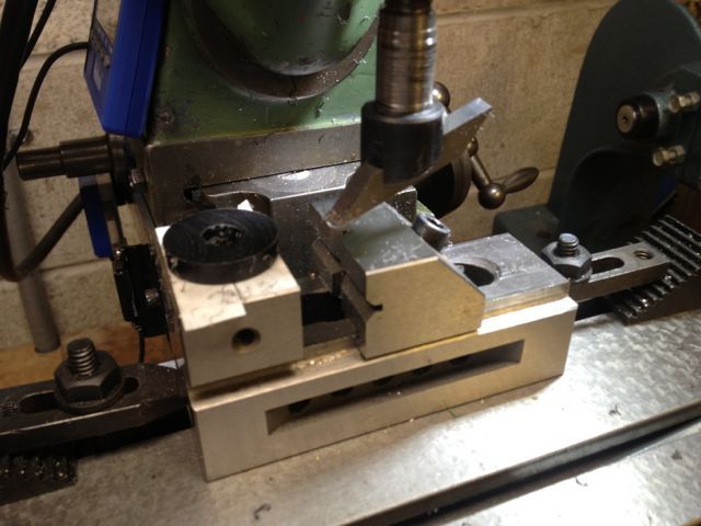

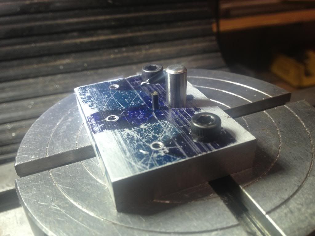

Here is a puzzler for you, this item being made on the shaping machine is directly related to the build of my Simplex engine, but can you tell what it is going to be used for ??
Offline NickG
  • Posts: 1430
Re: Bond's "Simplex" Petrol Engine
« Reply #14 on: November 12, 2012, 08:02:13 AM »
Some sort of fixture to bolt the crank case or head to to machine a certain feature?!
