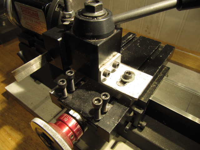

I know Chris, Jim, and Hugh made a plate to prevent their QCTP from rotating.
Does anyone have a drawing?
Drilling/tapping the QCTP is a bit scary for me so I'm thinking of milling a step into the plate that the QCTP will sit against. But I'm not sure it would be tight enough against the QCTP.
A thought might be (instead of milling a step) is to take a small bar that is bolted to the plate and thereby can be adjusted up against the QCTP.
I would still do the relief in the QCTP.
Initially I thought about using a 1/8" plate but I'm concerned there's enough meat for the step and for holding.
I'll probably try 1/4" and shave it down a bit.
I have no steel in the size needed and will use aluminum.

Here are mine. They are a little different as they don't rotate, which I find OK for CNC. One short one and a taller one. I typically use a riser block on the lathe which needs the taller one. If you use, you should check dimensions of your QCTP.
Hope this helps.

Zee.............just for reference. My plate is 7/64"  (.109"). Drilling and tapping my aluminum A2Z tool post was no problem. I'm not sure if yours is aluminum or steel.
