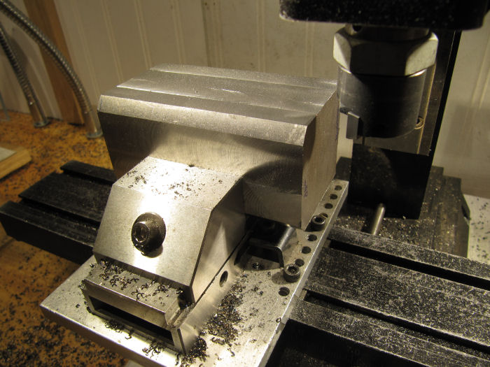

Not much change visually, but this afternoon I spent some time with the fly cutter (hung plexi shields around it to somewhat control the hot chips flying all over) to square up the engine block blank. The bandsaw cuts pretty square, but the slight wanders make it tough to securely clamp in the mill vise, so well worth the time to square it all up.
With the sides parallel/square to each other, now I can lay out the holes for the large mounting lugs on the bottom, and set up the holding fixture to match. The fly cutter leaves a nice surface, but it does not remove much material, so the sides will be taken down with some drilling/milling most likely. Once it is on the holding fixture I will need some study time to decide what order to work in to get the outside shapes.

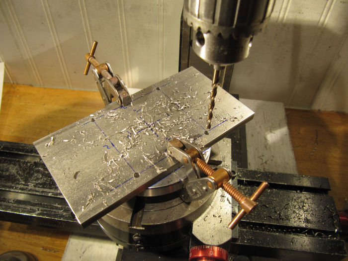

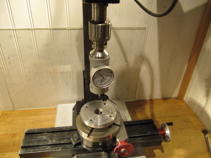

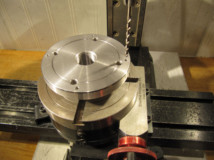

This afternoon, got started making the holding fixture for the engine block on the Stanley. First step was to center the rotary table under the mill spindle, using the co-ax indicator. The face and rim of the faceplate had been trued on the lathe, so I could use the rim to indicate on. Once it was centered, the handwheels were zeroed and the table moved left 1.414" and locked down.
Drilled/tapped four 5-40 holes at 90 degree intervals...

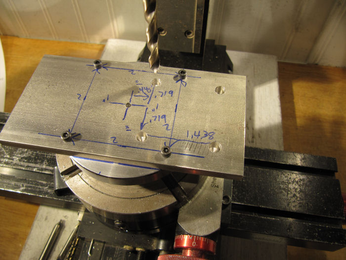

Then laid out the pattern on the fixture plate itself, and lined it up on the faceplate - took a few tries to get it aligned. Then clamped it down and drilled close clearance holes at 90 degree intervals again. Since the mill table had been locked down, these holes were on the same circle as the ones in the faceplate.
Then bolted the fixture plate to the faceplate in those new holes, and did some coordinate drilling - moved the mill table back to center (drilled a reference hole while there in case I need it later) then over to the coordinates of each hole where the engine block mounting lugs will be. Drilled each of those positions and tapped them 1/4-28.
