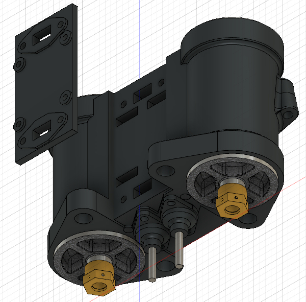

The model will be 1/4 scale of the original, which makes it just small enough to be able to turn the cylinders on the Sherline lathe/mill that I have. The steam/exhaust passages on the original were cast into the block, with a inserted sleeve on the valves to provide accurate machined ports. For the model, I worked out a way to keep the original look but provide for a cover plate on one side to allow me to machine the internal passages:

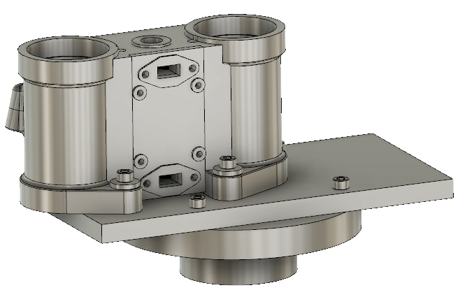

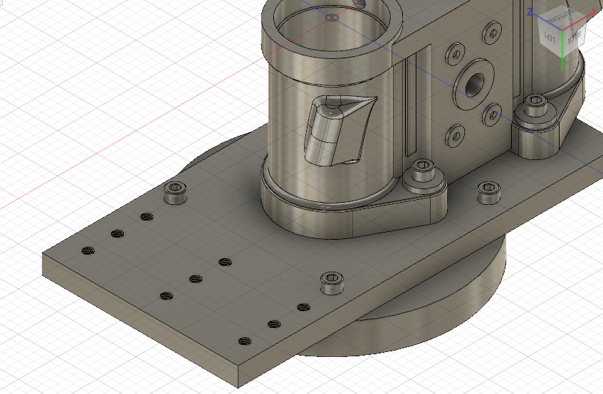

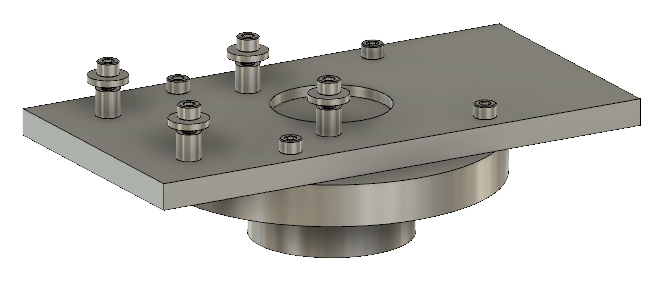

To hold the block for machining/boring, I designed up a holding fixture that will bolt onto the heavy steel faceplate that I got this winter (they are made for bowl turning on wood lathes, but are available in the same spindle thread as the Sherline uses, and are much sturdier than the stock Sherline aluminum faceplates). The fixture will have four threaded alignment posts that will fit into the mounting lugs on the base of the cylinder block, and will allow boring/shaping one side of the block at a time.
The recess in the center will give room for the boring bar to come through the cylinder without bottoming out.
It is symetrical to the block, so turning the part around on the fixture will align it for the second cylinder.
With the riser blocks in place on the lathe, the part will just clear the lathe bed. It can also be moved over to the rotary table on the mill for other shaping/drilling operations. Should be a good way to do most of the work on it.

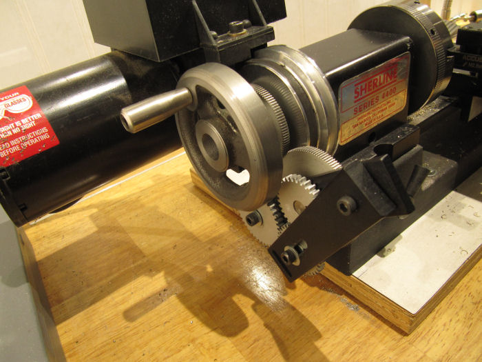

So, first steps? I need to make the tooling plate, get the 1144 bar cut to length and roughed out to a rectangular block on the bandsaw, and also make a change to the thread cutting attachment on the lathe. I bought the thread cutting accessory for my Sherline many years ago, but rarely use it since it requires removing the motor, which is a pain in the swarf to do every time. More recently I found a user tip on the Sherline website that shows how to reverse the gear plates so they stick out the front of the machine, and make an extension for the handwheel to clear the motor. I am taking that one step further and making a slightly smaller handwheel. Using it with the riser blocks on the lathe requires using the gear to make a metric thread, but that is no problem (the cylinder endcaps thread in place, not bolt down).

Bucket Bob seems to be looking for a firing pin on the double barrel "elf launcher" drawing!  :Lol:
One idea re the fixture plate - a couple of holes for attaching various counterweights opposite the cylinder for balance might be a good feature. I say various as the c-weight may need to be reduced as machining ops take weight off the cylinder. I have used a stack of several plates drilled together for this type of counterweight , with plates removed from the stack as work progresses. (prevents minor earthquakes in the shop from imbalance)  :o
Good idea!
I could drill/tap a few holes, and bolt on scrap bits of brass as needed. The plate itself could have been shorter, but I ran it all the way across to balance itself at least. I'll add those holes when I drill the plate. :cheers:
Edit:  Holes here should do the job...

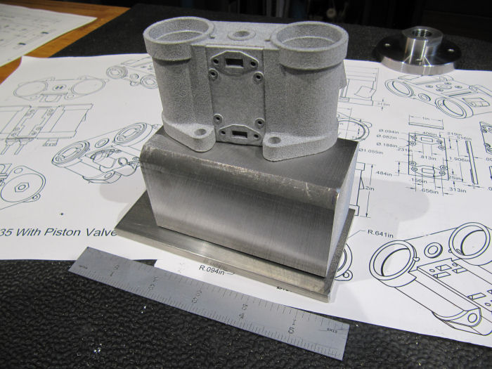

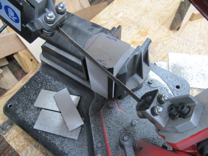

First chips made on the build! Sawed a chunk of the 1144 to length (plus a little), then squared it up on the bandsaw:
A bandsaw is hardly a precision cutter, so I left extra stock for trueing it up. Turned out to have only about a .030 variation end to end on the worst side, not bad for stacking tolerances as each side was cut. Still, enough that I will pick the two sides most parallel to each other to hold in the vise first as the trueing cuts begin, for the best holding power.
Here are the bits so far, the fixture plate rough cut to length, and the cylinder block 'casting' rough cut, with the 3D printed reference part on top. This is a REALLY rough casting, bet Jo's supplier is better than mine! Sirus would send this one back!  :Lol:

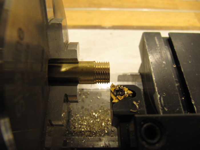

As mentioned above, I needed to make a smaller handwheel for the threading attachment, so I can leave the motor in place on the lathe. Having to remove/install the motor on every thread would be a royal pain, when this way all I need to do is swing the gears out of the way and remove the handwheel. I used a small handwheel casting that I had picked up years ago as a flywheel blank (used one on my Monitor build). Bored the center to fit the spindle, drilled/tapped some holes, and added a handle.
Did some experimenting with different thread pitches. Since only the metric set of gears are tall enough to reach the spindle with the riser block in place (which it will be for the cylinders), I started with a 0.8mm pitch set:
A little too fine a thread, so I tried a 0.9mm pitch
That looks a little more like it, think I'll go with that. The smaller handwheel works out fine, its only slightly smaller than the factory one, just needed to be 1/2" smaller to clear the motor and leave finger room. So, that gives me the ability to cut threads in the ends of the cylinder openings for the end caps, which will be just over 1" diameter. Cutting the steel will be tougher than the brass test piece, but that just means shallower passes.
