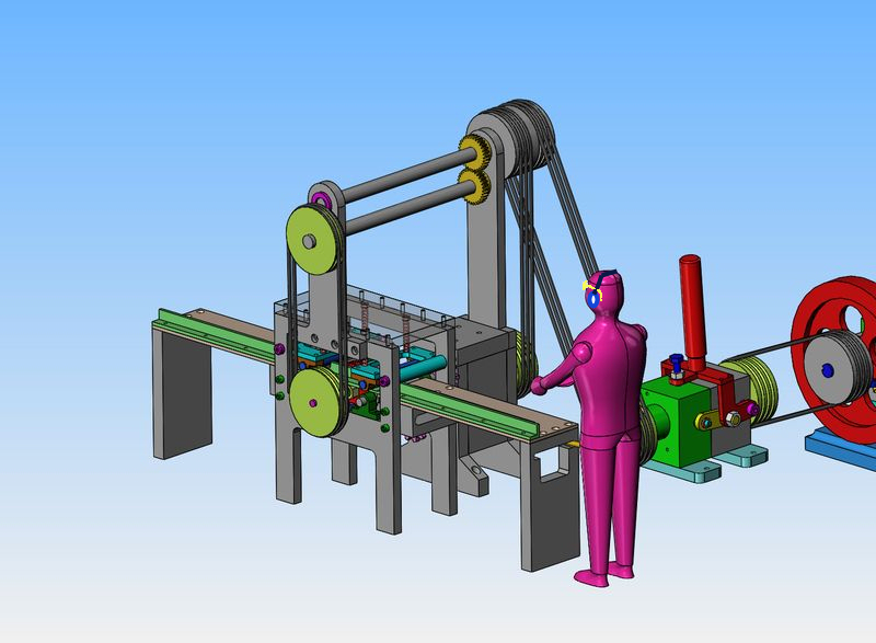

Today I am working on the drive for the saw blades and for the infeed and outfeed rollers. The rollers will operate at a much lower speed than the sawblade. This calls for a bit of trickery. In this picture you see a gear reducer I built about 10 years ago, with a sprocket on the output shaft. As positioned it would provide a great drive for the rollers, but any drive to the sawblades is totally blocked. I've had that small 8:1 gearbox setting around here for ten years, but today is the first time that I've actually went ahead and modelled it.
  • Posts: 5701
Re: Old School Sawmill Edger
« Reply #8 on: October 16, 2019, 11:33:34 PM »
 The rollers under the board and the sawblades have to rotate different directions. Best way to address that is with a bit of overhead lineshaft. The engine, clutch, and gear reducer all parts that I currently have setting in my office.

I had to do some calling around to my old sawmill contacts, but I finally come up with a good edger man.

What is the point of the two high up gears? at 1:1 they don't look to do anything so you could just as well run the output pulley on the same shaft as the input.
Could also save a lot of drag by just taking the drive into the blade and gearing down on the same side to drive the rollers, changing direction with the gears if needed.
  • Posts: 10387
« Reply #13 on: October 17, 2019, 05:32:25 PM »
I think they are there to change directions, the belt coming down on the far side goes the opposite direction as the belt on the near side, one to run blade and one to run feed rollers.
  • Posts: 7177
« Reply #14 on: October 17, 2019, 06:48:15 PM »
That's why I said the gearbox could also change direction.
But there does seem to be a lot of shafts and pullies that are not needed, just needs a simple up and under belt to drive the two rollers off the blade shaft, small drive and large feed roller pulleys makes sure the blade spins up and the wood feeds through slowly.
Infeed and outfeed fences should also be offset and the "L" shaped outfeed fence won't work
